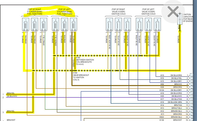

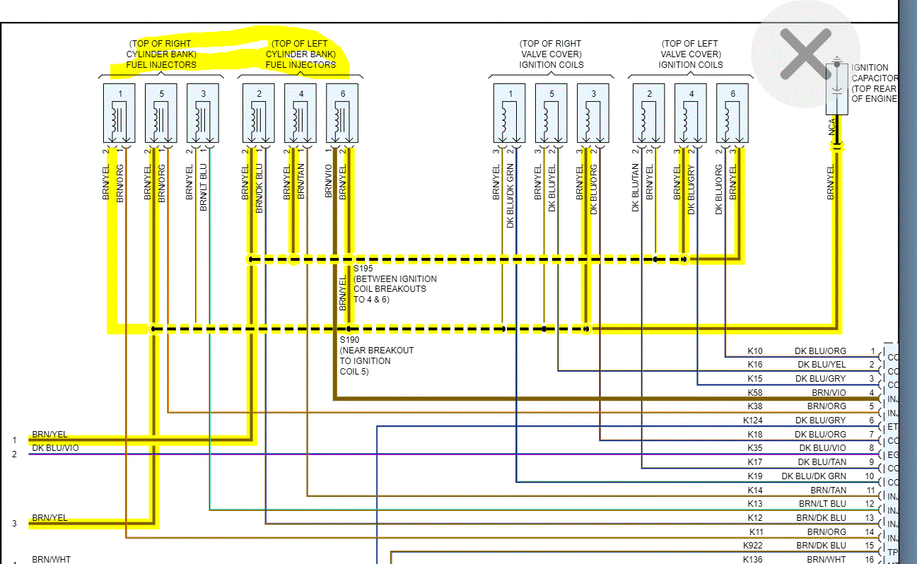

Okay, start with those checks. Also, if there is spark to the plugs, we need to confirm there is a signal to the injectors.

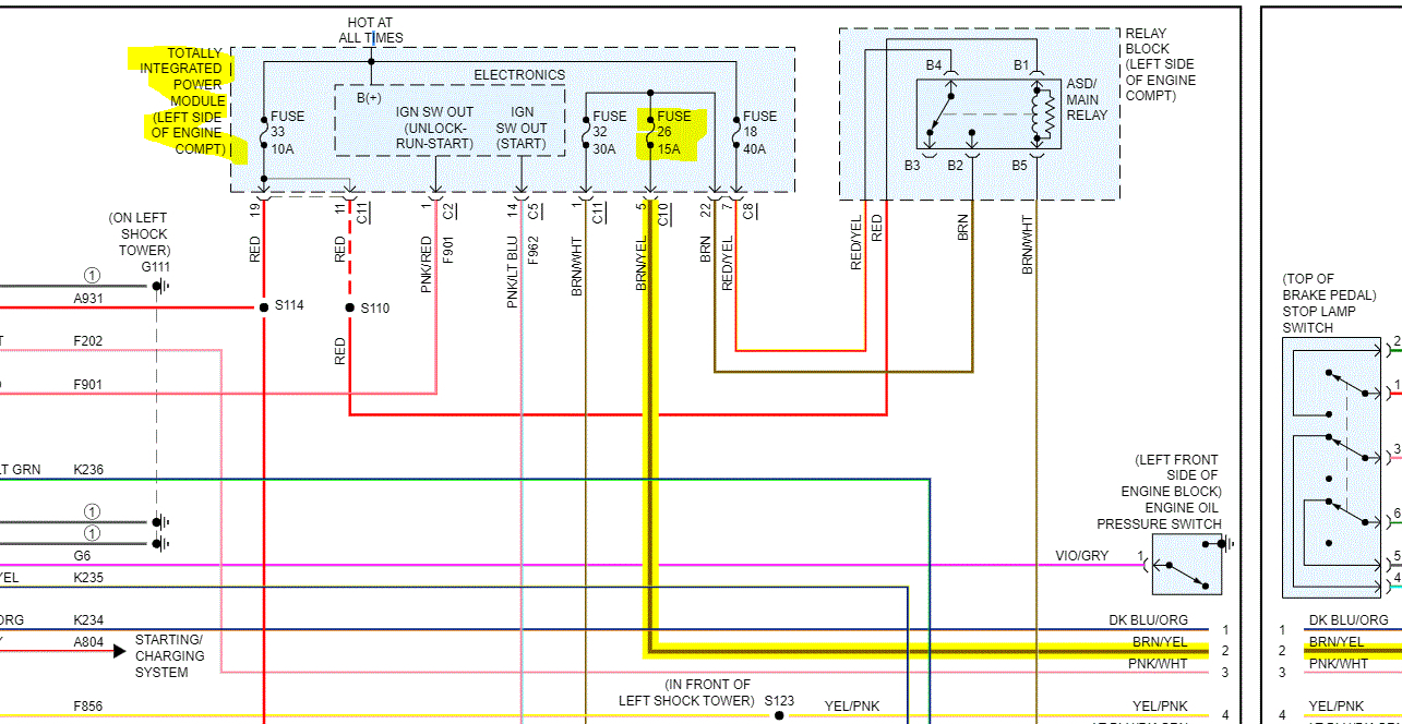

Here is how to do it. At each of the injectors, there will be a brown wire with a yellow tracer. On each injector, that wire should have 12v at all times with the key in the start or run position. Check for power. If there is none, go to fuse 26 in the under-hood fuse box. Inspect the fuse. In addition to checking the fuse, confirm there is power to and from it.
Here is a link to help:
I attached two pics below from the wiring schematic. One shows the fuse and the other shows the injector wiring.
Let me know what you find.

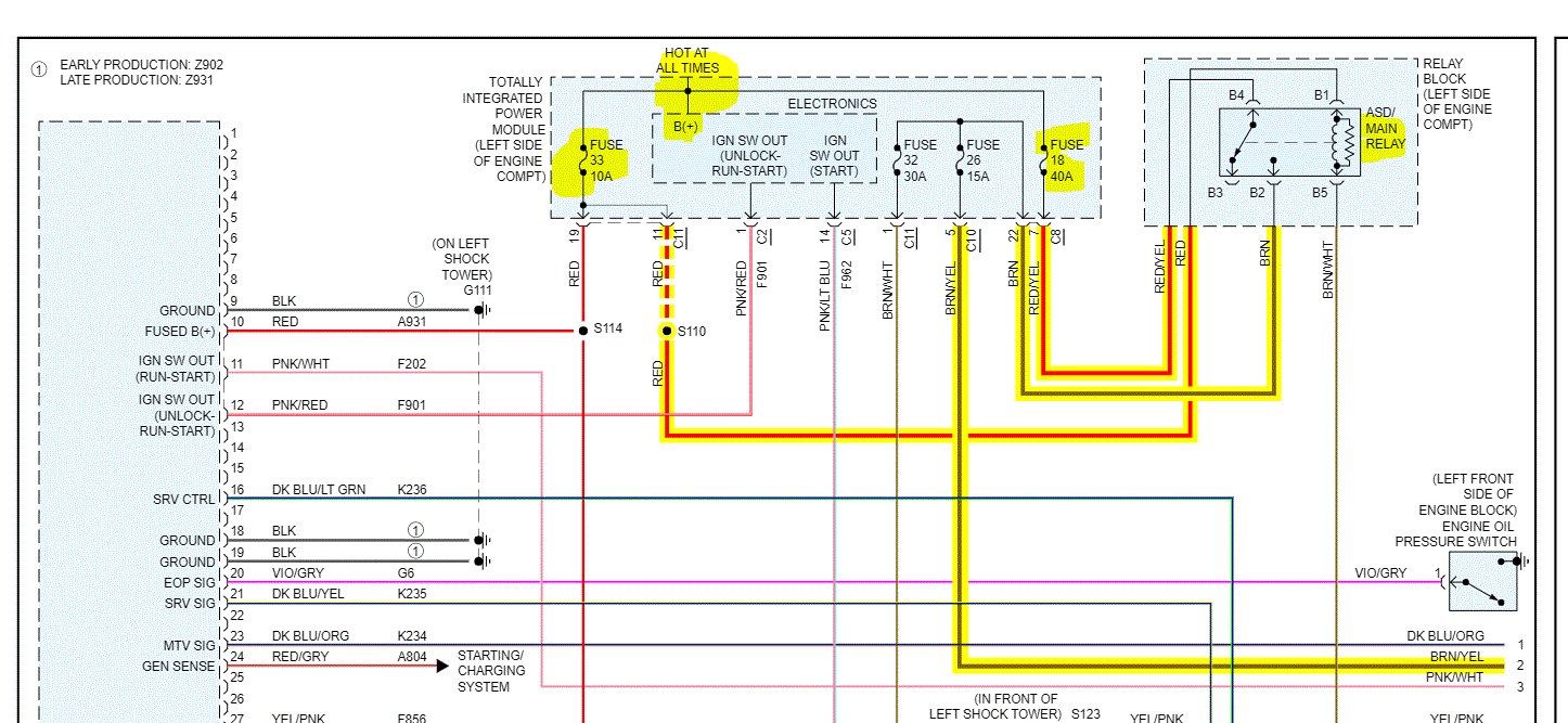

Take a look below. I need you to check the additional fuses I highlighted and the ASD relay. The fuses are in the TIPM, and the relay is also under the hood in the relay box.
If the fuses are good and have power to and from them, pull the ASD relay and inspect where it connects in the box. Make sure none of the pins are pushed or damaged.
Next, if there is a relay with the same part number, switch them. If there isn't, here is a link that explains how one is check one:
See pic below for reference.
See pic below.
