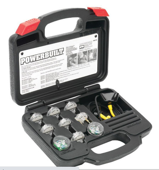

recently replaced head and gasket due to overheating issue. everything installed with 120 PSI on all cylinders, good spark,timing marks lined up, fuel reaching fuel rail when cranking but spark plugs seem dry after cranking engine.what controls the fuel injectors?

The PCM controls the firing of the injectors. Do you have access to a noid light set? If you don't most auto parts stores have a tool loaner program and can rent you one.I suggest putting a noid light on the individual injectors to check and see if you're getting an injector pulse signal.Hope this helps and thanks for using 2CarPros.

Hey Danny, still waiting for my noid tester but I have another question. The timing marks all line up with the rotor on #1 I know that the valves need to be closed and cam sprocket on it’s mark when I put the belt on but wondering can the valves be open when I installed the belt causing it to not start? Is that possible? Or as long as the cam sprocket is on the mark the valves are always closed. Thanks Danny for all the help!

To answer your question no. If all the marks were lined up when you installed the timing belt then there would not be a no-start condition regardless of where the valves where located during the combustion process. I'm still wanting to know if you are receiving an injector pulse. I've attached a picture below of a noid light set.The're available at Harbor Freight,Home Depot, and most local auto parts stores .Auto parts stores have tool loaner programs and can rent you one.Hope this helps and thanks again for using 2CarPros

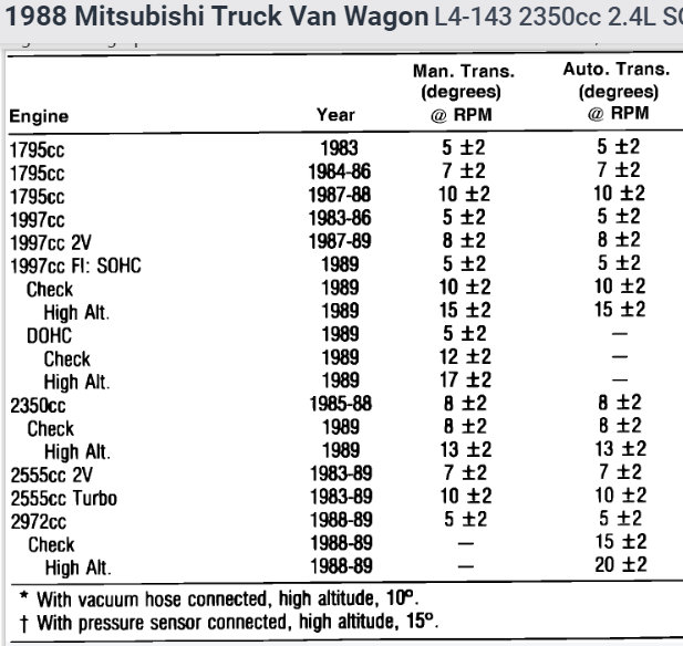

Hey Danny, it started up yesterday after realigning the distributor but was missing on cylinder 1 . A lot of coolant shot out of the exhaust pipe! Had it running on 3 cylinder until it warmed up. Today went to check the injectors and it checked out fine . Good spark and did another compression test and that’s still 120. Went to start it and it didn’t again!! Unbelievable! Sprayed some starting fluid in and nothing! I don’t know what’s going on.

So you say you are getting spark and fuel but a no start condition?After moving the distributor it started? It sounds like it might be a timing issue. I've attached a picture below of timing specifications.Hope this helps and keep us updated.Thanks again for using 2CarPros.

Hey Danny,
Yeah, I had the rotor off so it wasn’t lining up to the #1 on the cap. It started but had a miss on #1 but getting power to the injector. I then tried to start it and now doesn’t start again! Tried starting fluid but nothing so now I’m confused once again. A lot of water s*** out of the tail pipe when I started it and white smoke was noted but kinda started to clear. That was 2 days ago and yesterday went back to start it and nothing again. I’m thinking injector for the miss but why it’s not starting again is confusing. Thanks for all the help, Robert
