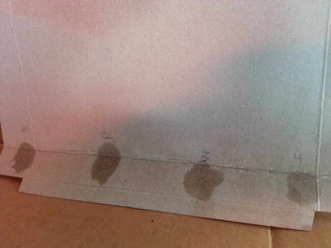

Vehicle ran all day, parked overnight, Morning crank, no start. Vehicle RPMs are very low and it idles very slowly and then the engine stalls...
Spark: All 4 spark plugs produce spark, wire resistance measured Ok, External coil resistance measured ok per spec. Distributor (CKP, TDC, cylinder, resistance measured a little lower than spec, no red death bearing wobble.
Fuel: pressure within spec. pump okay, filter, okay fuel pressure regulator okay, injectors pulsing okay.
Timing: (TDC)..Aligned (distributor rotor point to 1, flywheel
mark at + pointer, overhead camshaft marking up arrow and
across cam surface..(no teeth jumping)
Compression: all 4 cylinder at 190-200 PSI...good
Air: filter intake housing ,,,clear....
Throttle body, IACV ,EGR...,cleaned
Sprayed carburetor cleaner into throttle body and
engine runs just fine until fuel source runs out...

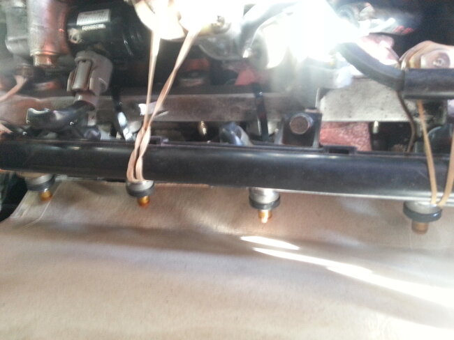

Removed fuel rail and tie wrapped injectors Ignition on
/ cranked engine and observed sprayed petrol from each
injector...
Please help...Check next? thanks

Yes, the engine runs great (as normal) with carburetor fluid as fuel source.
Yes, Injector's all 4-spray fuel. (See photos).
Tank capacity 17 gallons: added 13.88 gallons a few months ago...Driven 325 miles until crank no start. Gasoline in tank more than 1/4 left. Bad Gasoline? Really!! Will drain and replace. Thanks
