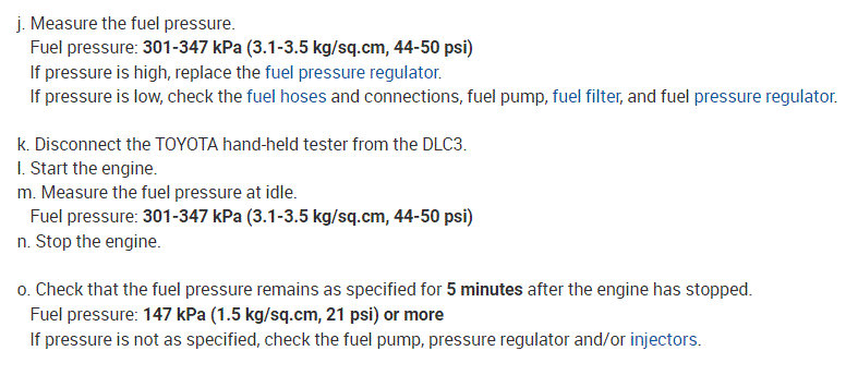

The car does run with starting fluid. It tries to start on its own fuel after it sits for a few hours but only stumbles for a couple of seconds and shuts off. Like maybe it's a pressure problem. I just got a fuel injection pressure tester today so I'll check that this weekend.
Mar 24, 2021 at 7:09 AM
  • 110,240 POSTS

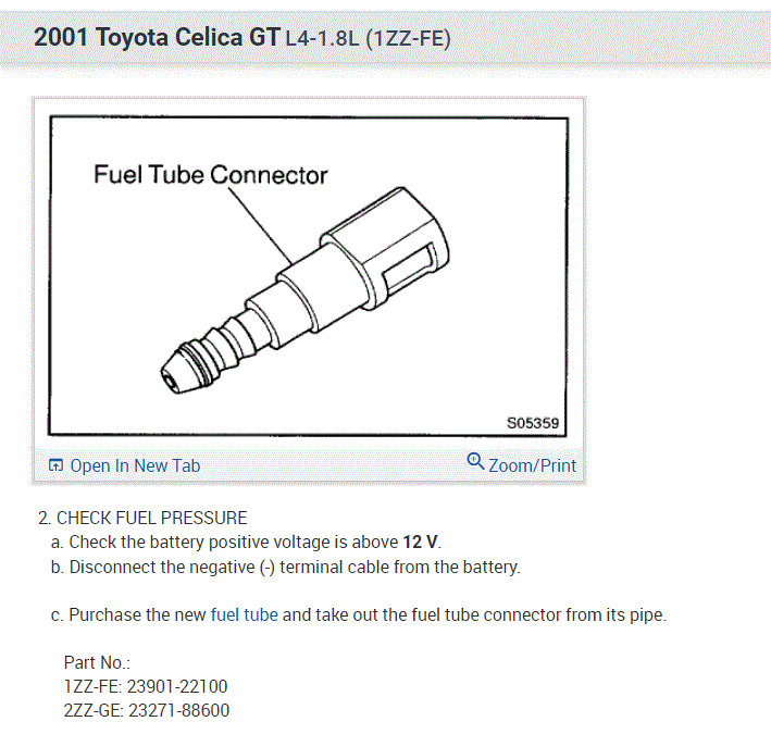

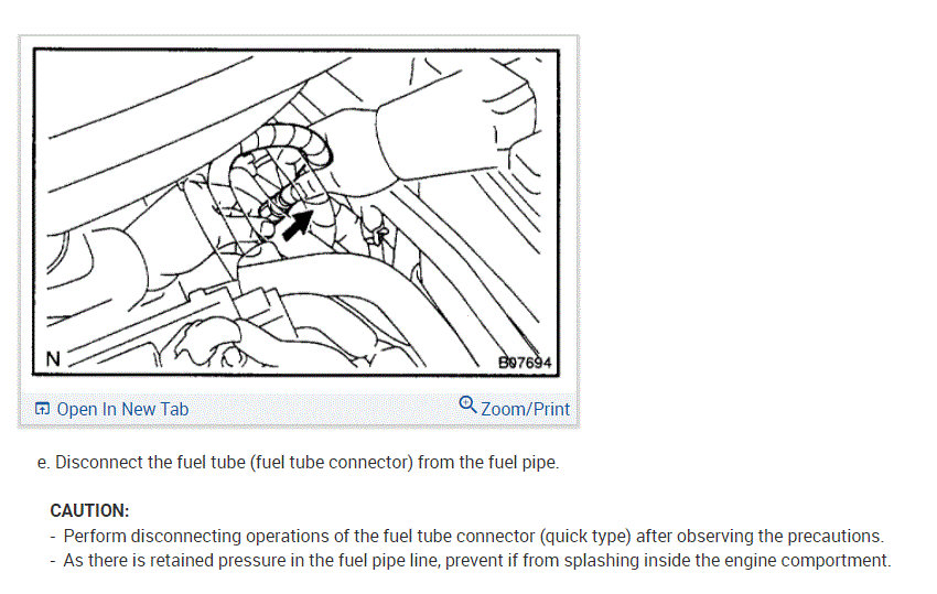

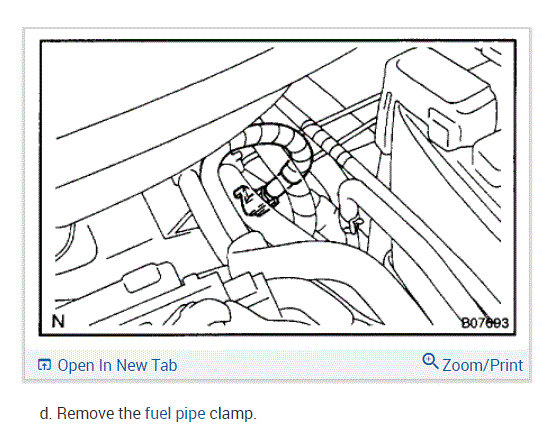

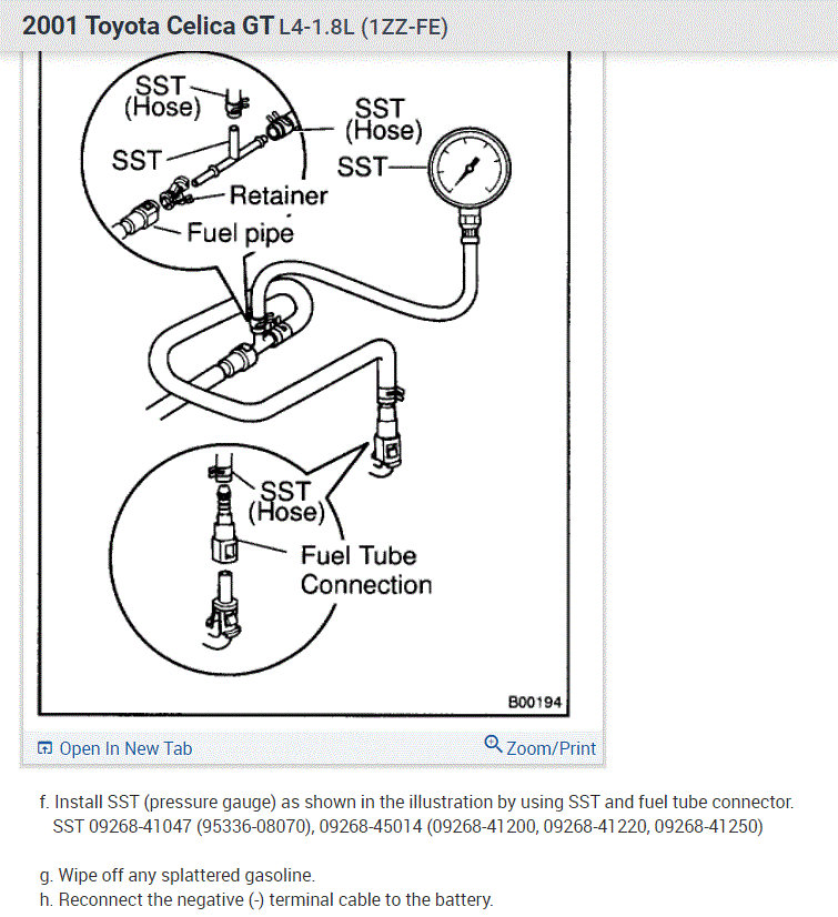

If it starts with starting fluid, I believe you are on the right track. Here is a link that shows in general how it's done:
Your vehicle won't have a port to connect to, so you will need to add a T where the fuel line. if you look below, the pics contain the directions and pics related to connecting the T. The last pic shows the manufacturer's specifications for pressure and possible problems you may encounter.
