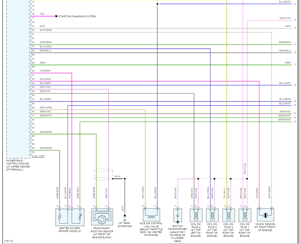

Crank no start no power to crankshaft position sensor?
180,032 MILES • 4 CYL • 2WD • AUTOMATIC
HAYWOOD97

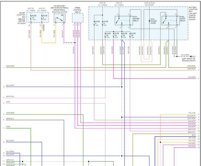

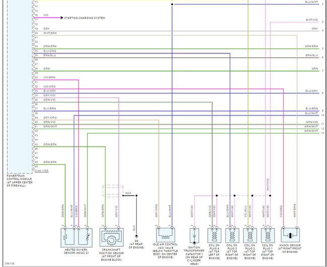

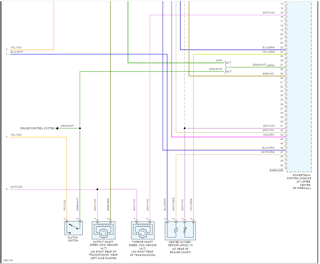

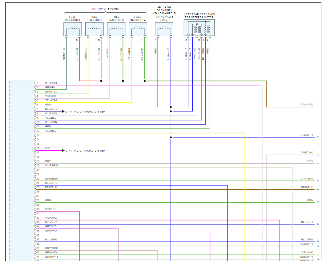

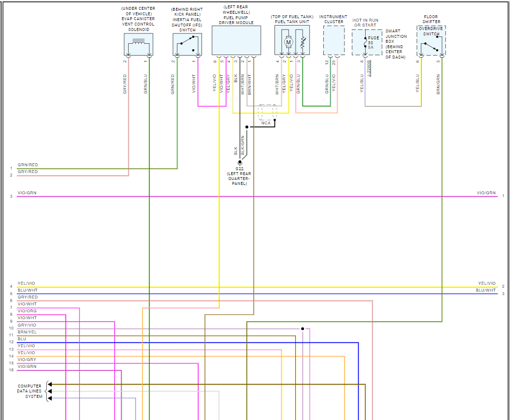

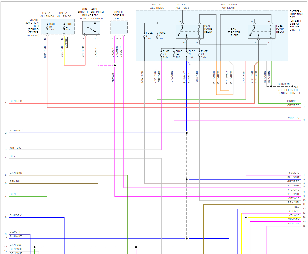

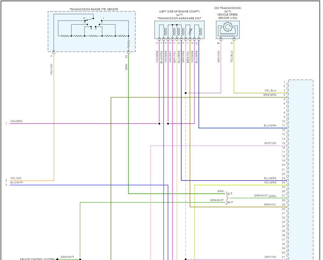

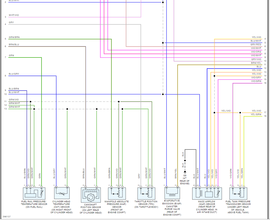

Shop said there's no power to crankshaft position sensor harness. I'm looking for wiring diagram or pinout for it, please and thank you.
Oct 16, 2024 at 10:55 AM
  • 55,721 POSTS
Sure here are the wiring diagrams for the crankshaft angle sensor the PCM. I can say the power (5 volts) comes from the PCM itself, did they check the fuses is the rest of the 5 volts system down? Anyway, here you go, Check out the images (below). Please let us know what happens.
Oct 17, 2024 at 2:51 AM
