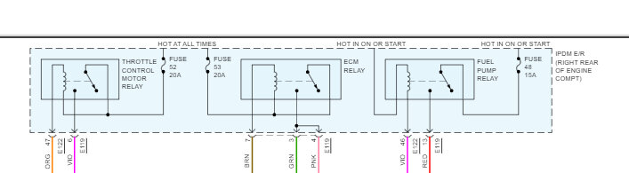

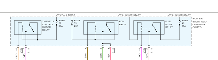

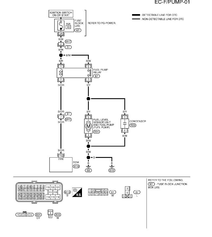

Trying to find fuel pump relay to test for possible crank no start condition.
Aug 19, 2023 at 8:53 PM
  • 55,402 POSTS
the fuel pump relay is located in the engine compartments' IPDM.
I have seen them "built in" so they might not be serviceable. Can you hear the fuel pump turn on for about 5 seconds when you turn the key on and not crank the engine over? How does the engine sound while cranking over?
