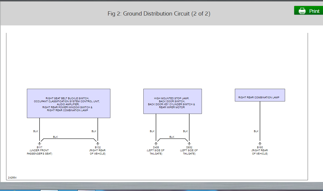

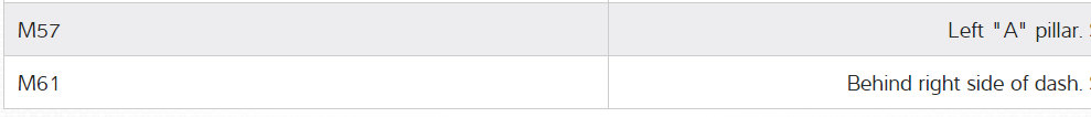

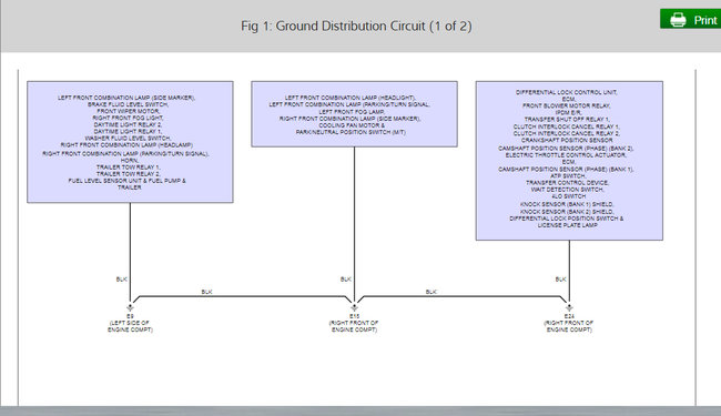

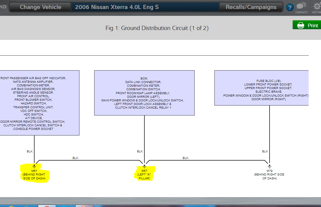

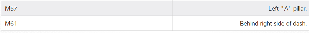

SCGRANTURISMO
  • 4,897 POSTS
Hello again,

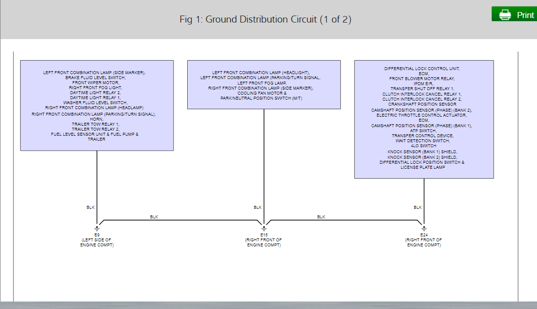

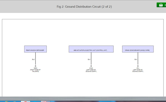

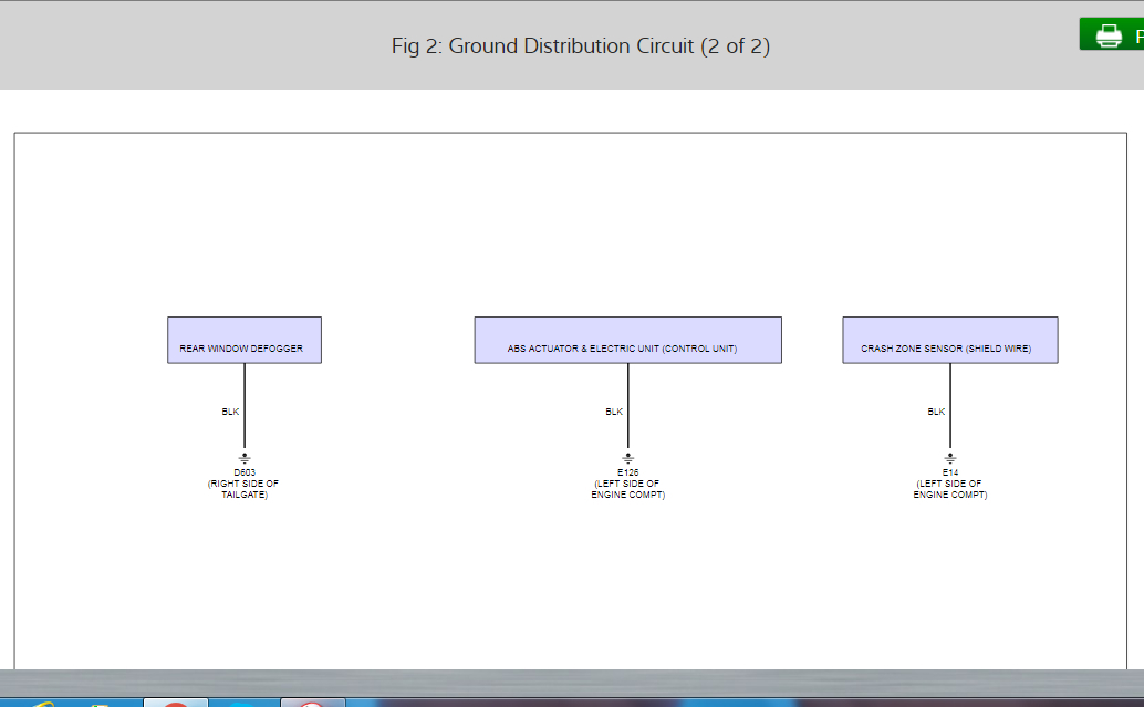

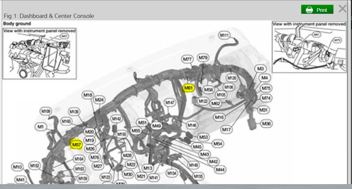

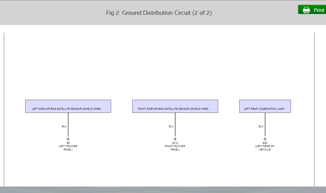

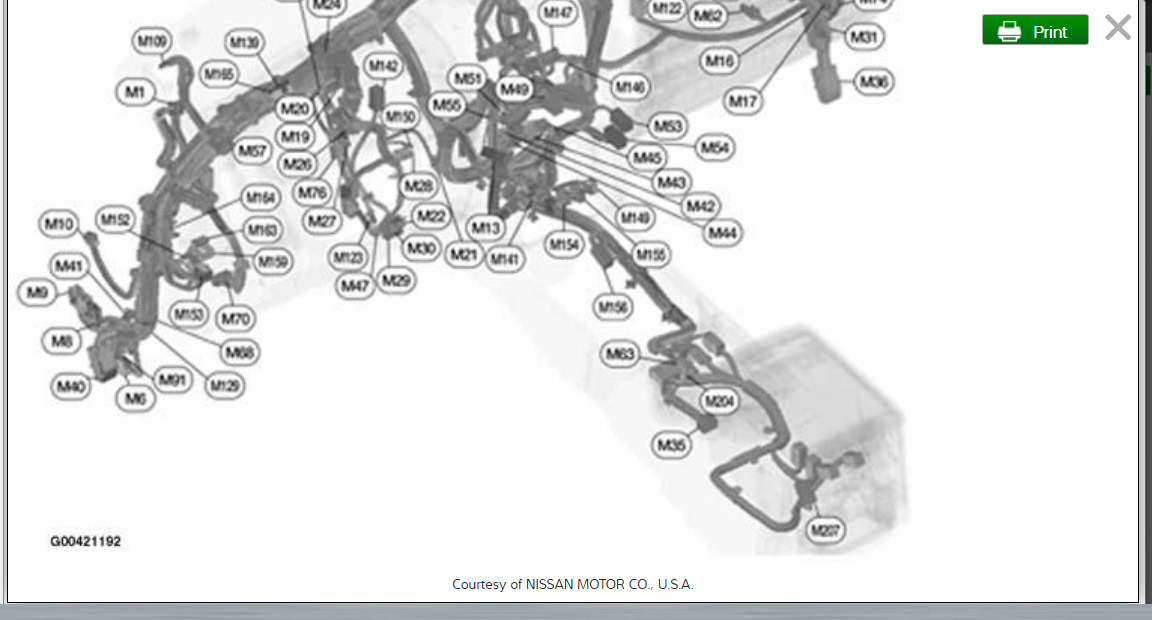

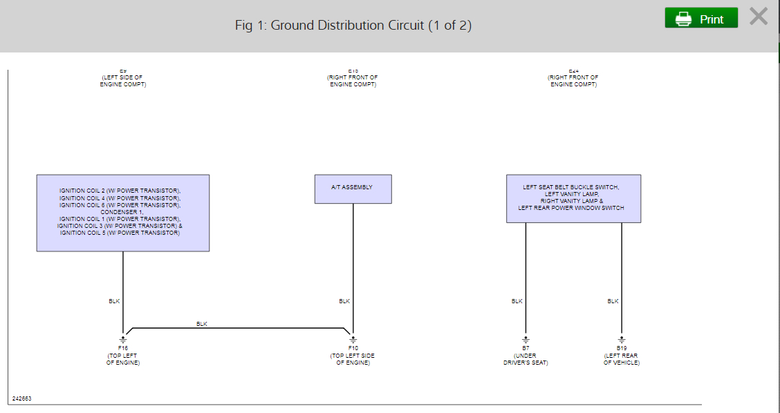

Okay, this is sounding more and more like a ground problem. Today's vehicle's use a single ground for many electrical circuits on the vehicle. I have included in the diagrams down below a Ground Distribution Wiring Diagram and the locations of the two grounds I want you to inspect. They are Ground M57 and M61 respectively. To inspect these make sure that they are clean, corrosion free, tight, and are making good metal to metal contact. The same goes for the ring connectors that attach to the ground. Please check these grounds and get back to us with what you are able to find out .
Thanks,
Alex

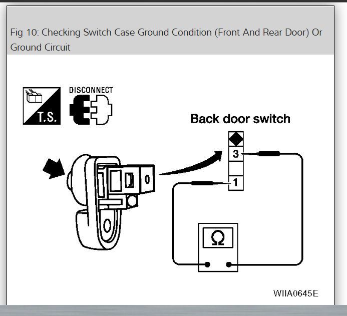

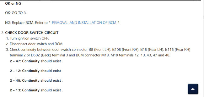

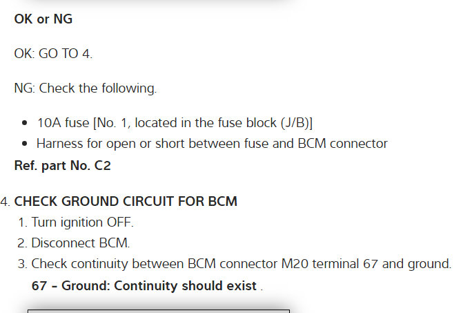

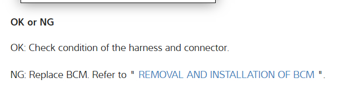

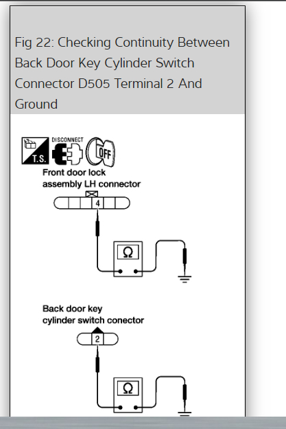

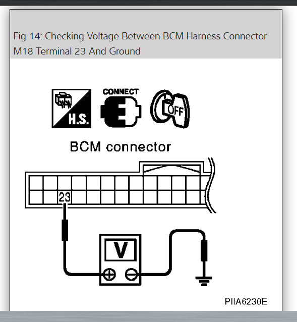

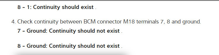

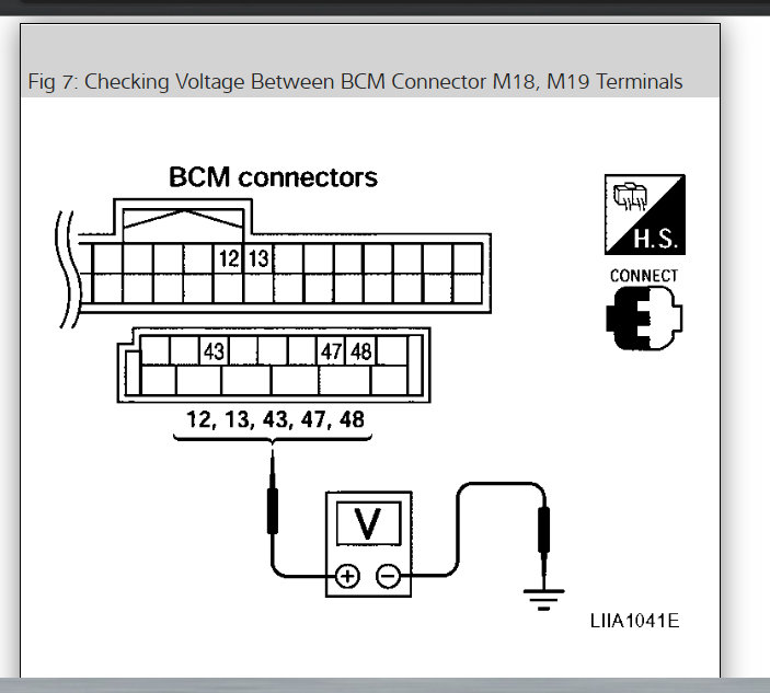

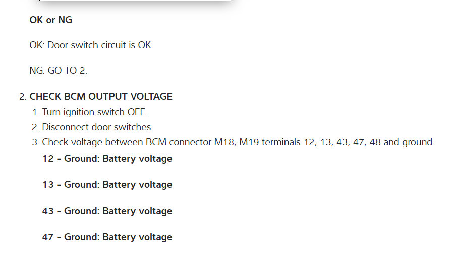

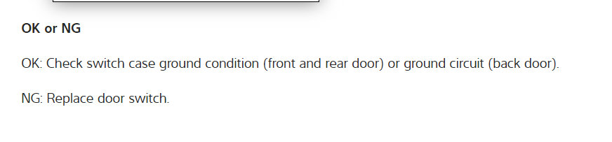

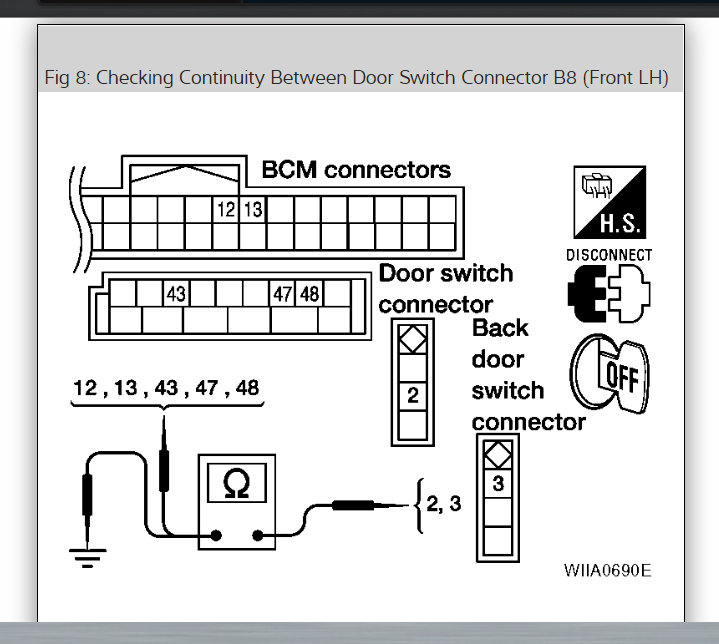

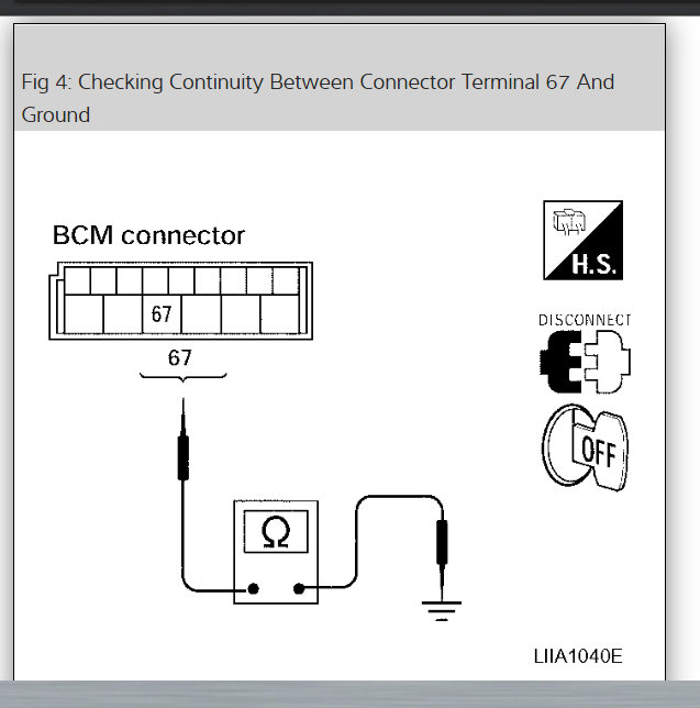

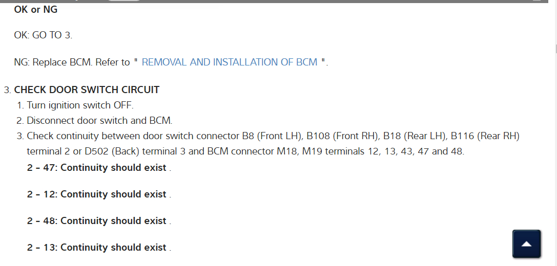

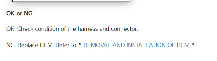

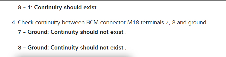

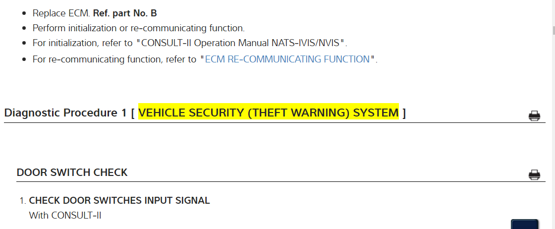

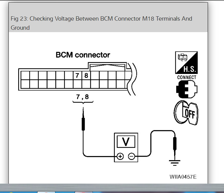

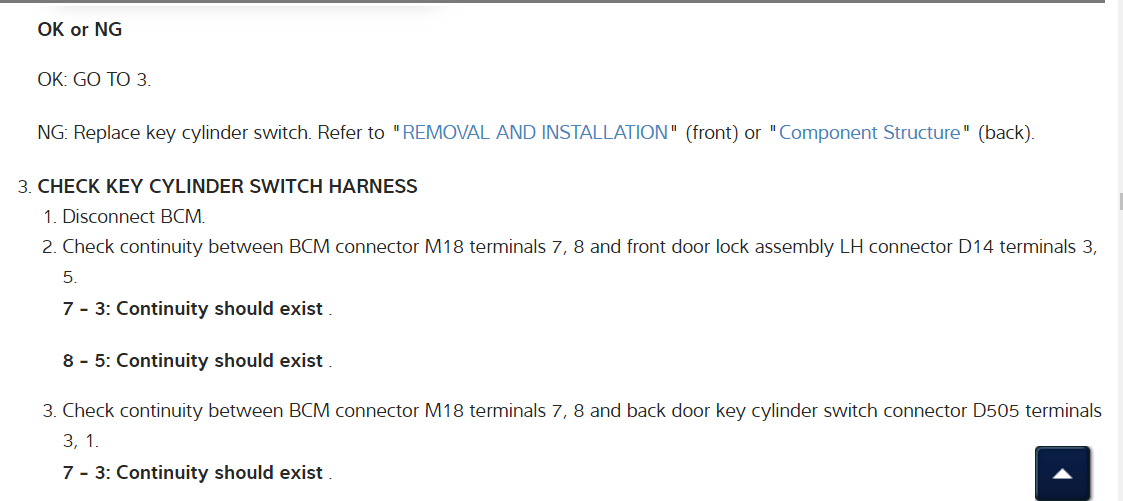

Okay put new battery in new crankshaft sensor now the dash lights and everything come on but the radio and the car with key light is staying on! Help
May 2, 2019 at 1:37 AM

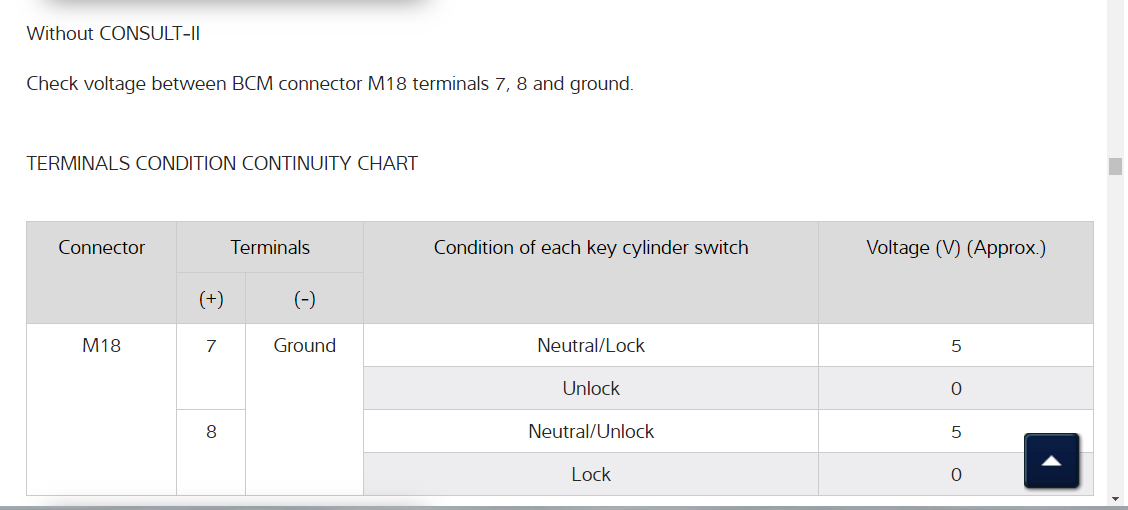

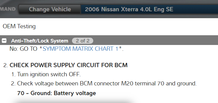

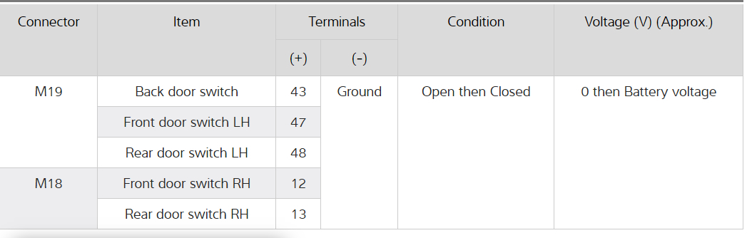

SCGRANTURISMO

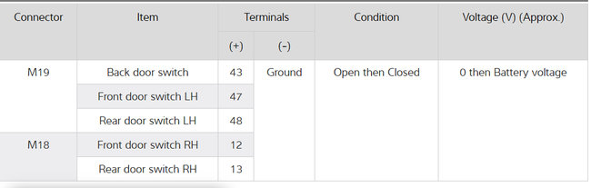

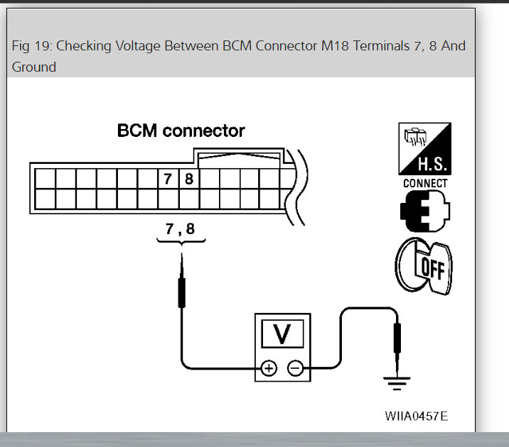

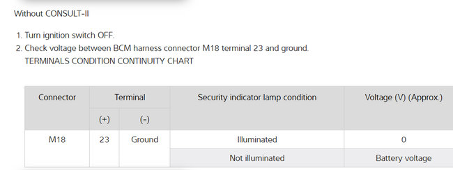

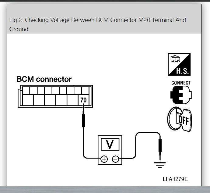

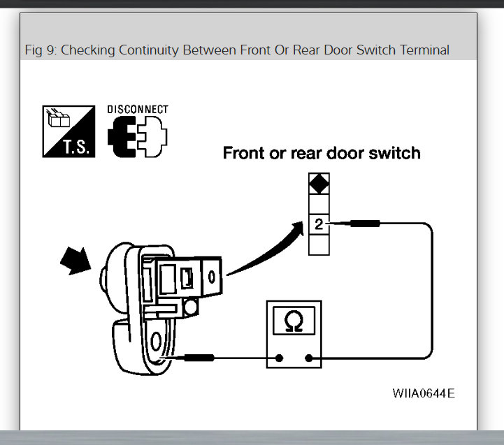

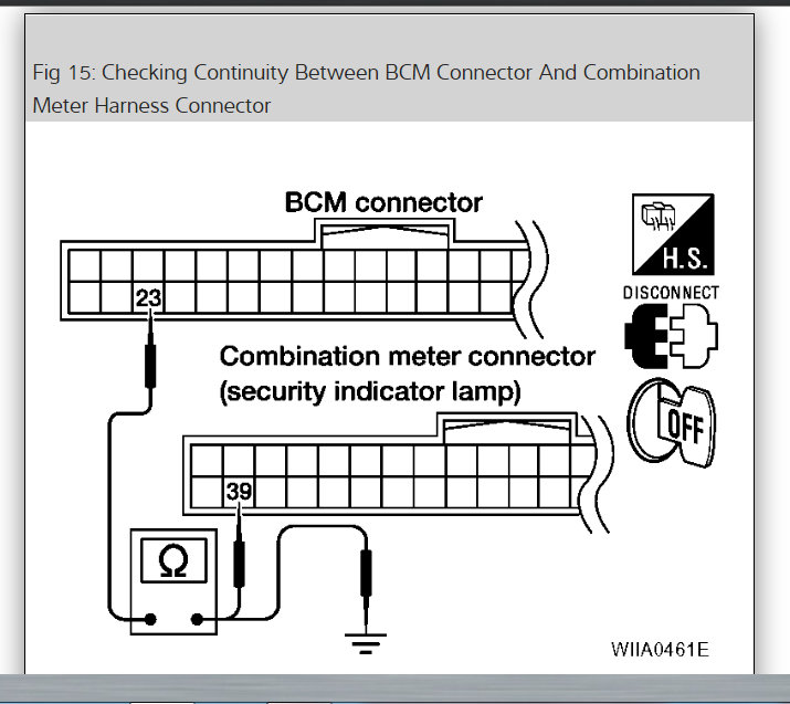

  • 4,897 POSTS

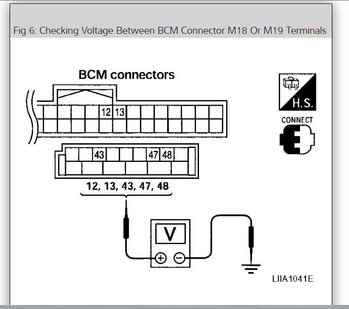

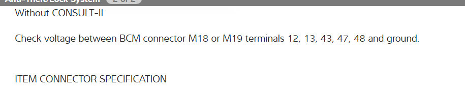

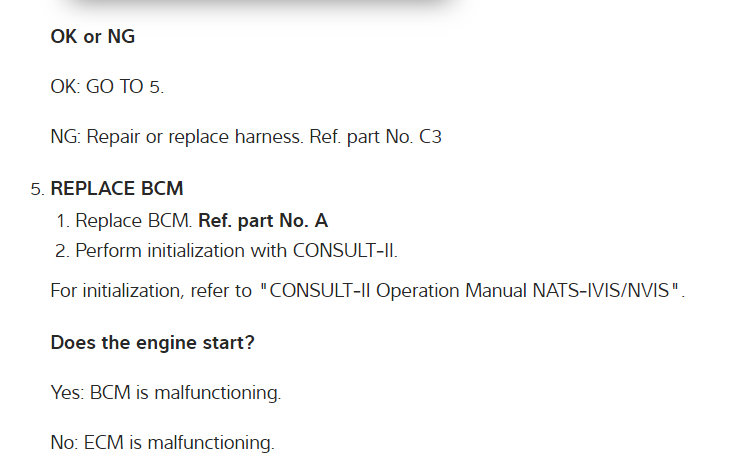

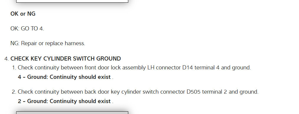

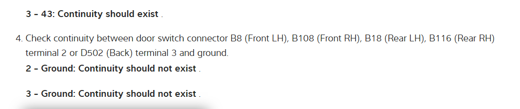

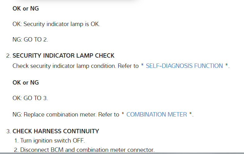

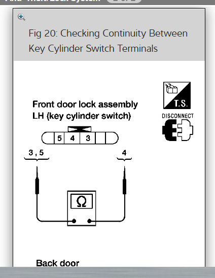

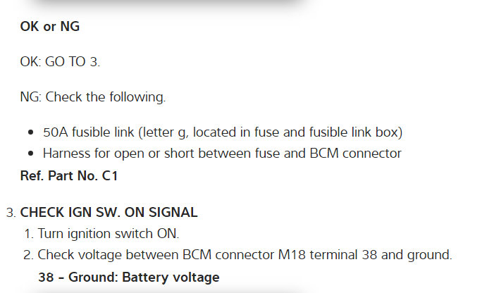

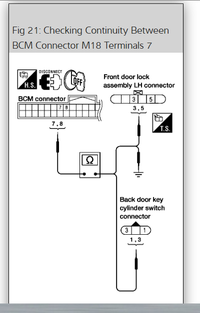

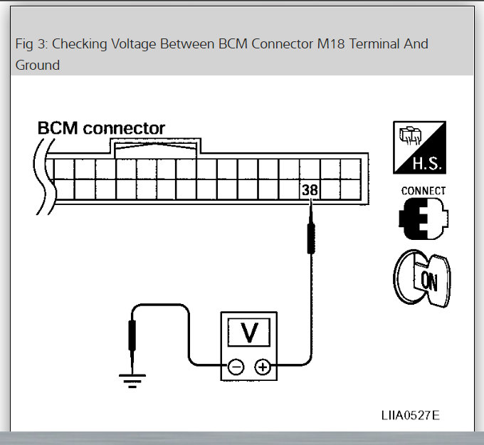

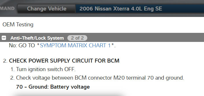

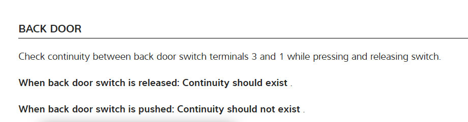

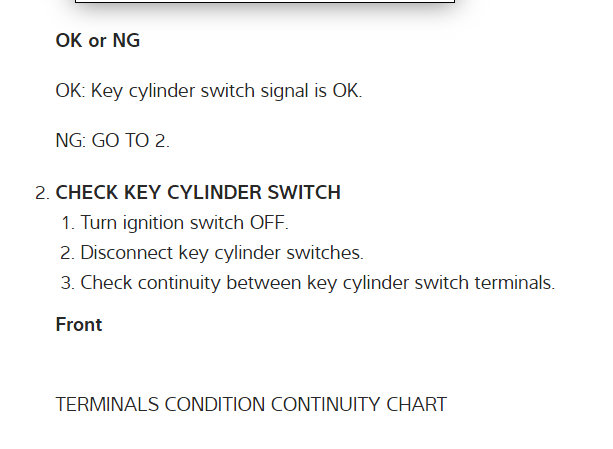

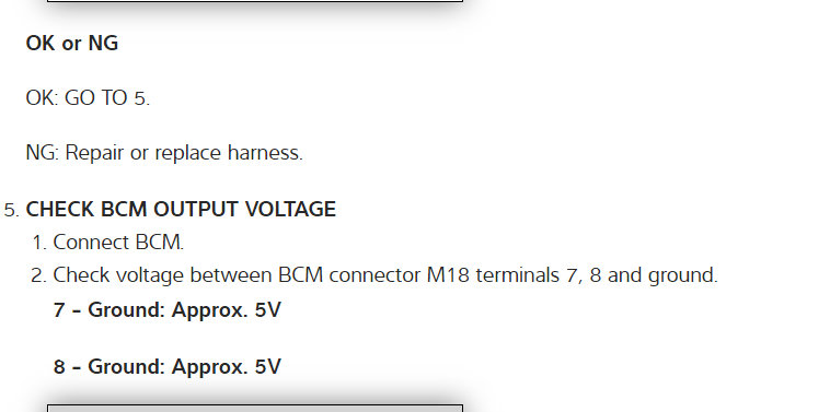

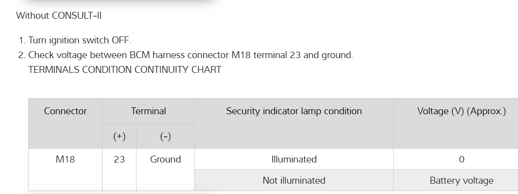

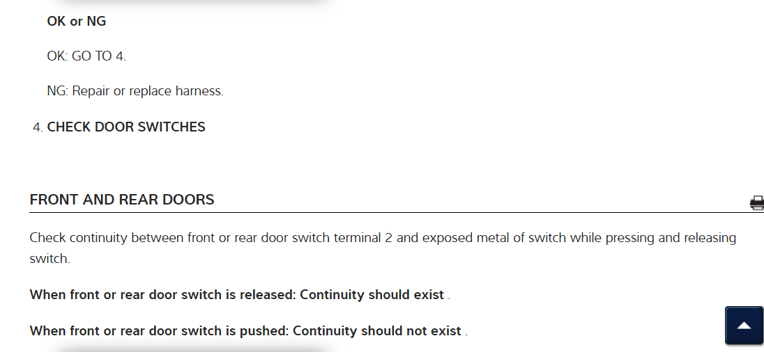

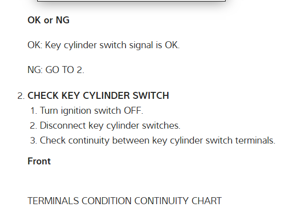

Okay, I have included for you in the diagrams down below a comprehensive factory diagnostic troubleshooting guide for the immobilizer/anti-theft security system in your vehicle. You will need to use a multimeter do perform the steps in the guide, so I have included a link for you to go to if you are unfamiliar with how to use one.
Please go through the guides and get back to us with what you are able to find out.
Thanks,
Alex
2CarPros
May 2, 2019 at 6:31 AM
KATIE1984
  • 7 POSTS
Half of the fuse box isnt working but fuses are good do i need to replace the fuse box or ecu???
