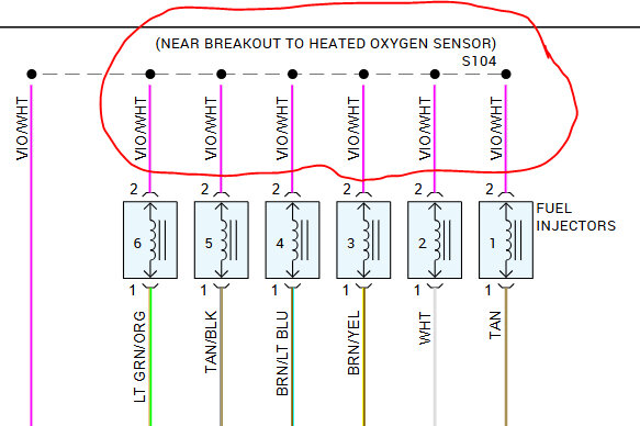

If you have fuel, spark, compression, and correct timing, the engine has no choice but to run. Do me a favor, if you are confident the aforementioned components are working properly, I need you to locate the violet wire with a white tracer at one of the fuel injectors. Each injector will have one that color and one a different color. That is the power supply.
Check one or more of those wires with the key in the run position to confirm there is power. Also, let me know what the compression is as well as the fuel pressure.
See pic below.
Dec 19, 2024 at 10:21 AM

I believe the fuel injectors are getting power because when I loosened the fuel rail and lifted it up a bit I cranked it and had fuel shooting out the injectors as far as the wiring I haven’t checked that but I can if you need me to, but I’m not sure if it’s a fuel problem because even when I put starting fluid in the intake it still doesn’t want to start.

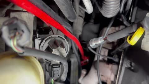

Here’s the video.

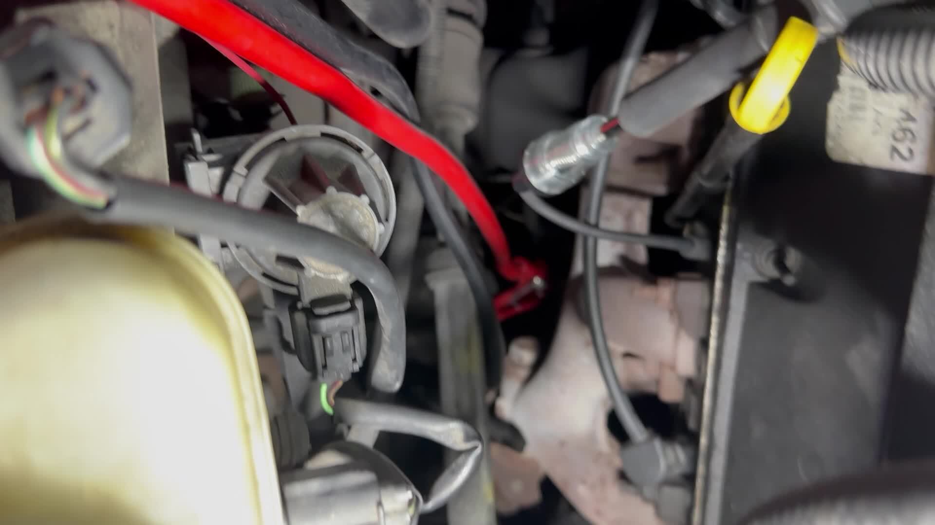

This also another video of me checking spark I checked all six cylinders, and they all give me spark I also checked compression on them, and I have a little over 120 for all 6 cylinders.

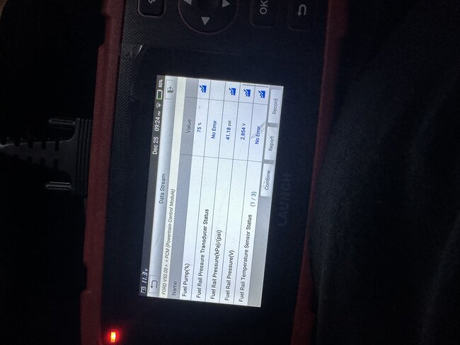

And here’s a picture of the psi of my fuel rail pressure I also double checked it by taking the fuel rail off and I have fuel spitting out sidenote my car battery was starting to drain from me leaving the key in the on position for a long time I took off and have it on the charger now.

  • 110,244 POSTS
I hear it trying to start so fuel and spark are present. How old are the spark plugs?
