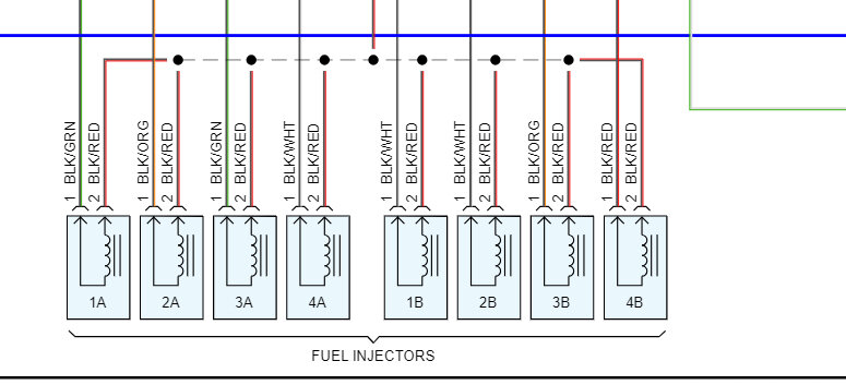

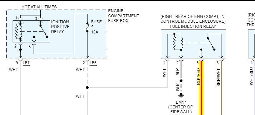

Do this: see if it starts with starting fluid. If it does and then stalls, we know it is fuel related.
You already confirmed ignition spark. If it does start and then stalls, go to the fuel injectors. Each injector has a black wire with a red tracer. With the key in the run position, that wire should have power. If it does, we need to see if the PCM is providing a ground path,
Take a test light and connect the alligator clip to the battery positive. Probe the opposite wire and have a helper crank the engine. The test lamp should strobe on and off.

Injectors are firing so there is no need to perform the power/signal checks. I had already pulled the fuel rail out with the injectors and turned over the engine and validated that the injectors were indeed firing. Also tried starting fluid and the engine spit back through the intake, so no luck with that. So, I have fuel, air, spark, timing (i.e. cam/crankshaft sensors are good via oscilloscope checks). Haven't done any checks on the exhaust system (don't see a need), engine compression or other potential timing issues (i.e. jumped-timing chain), or security system (don't see a need). Going to check the gas quality (i.e. contains water), do some compression checks and if those results are good, then I'm absolutely stuck! Don't know what else to do. Please help if you can!
