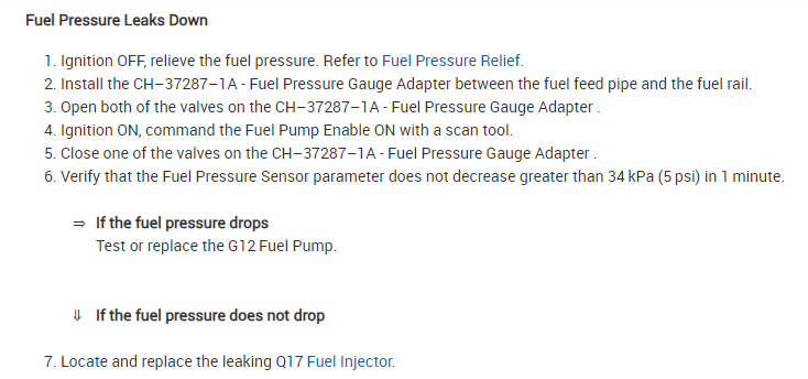

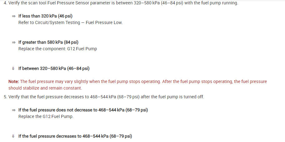

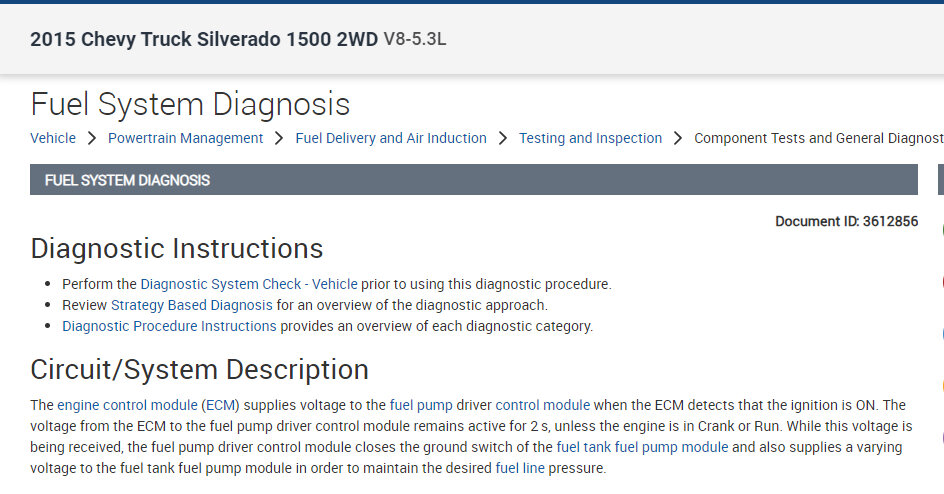

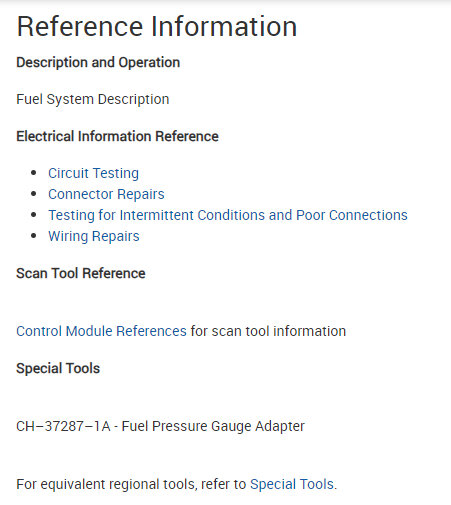

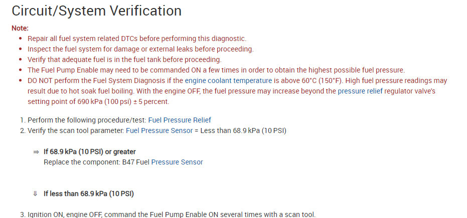

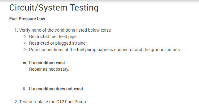

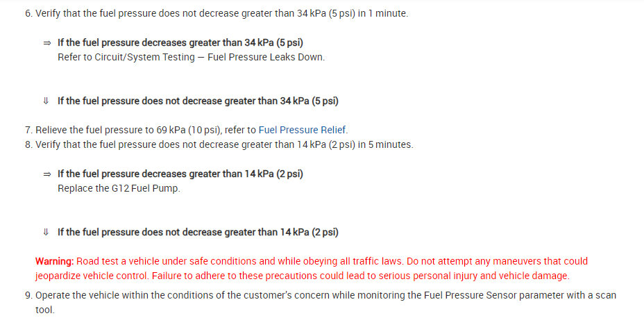

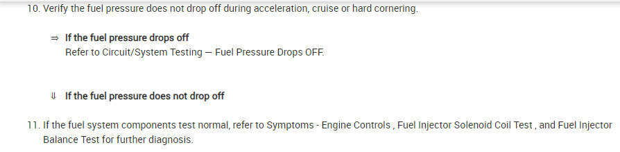

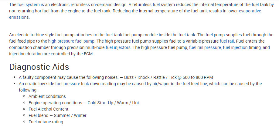

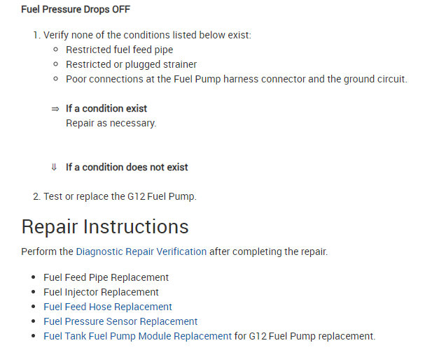

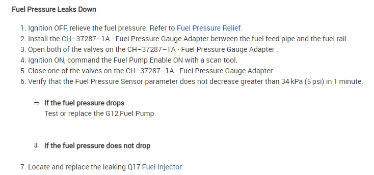

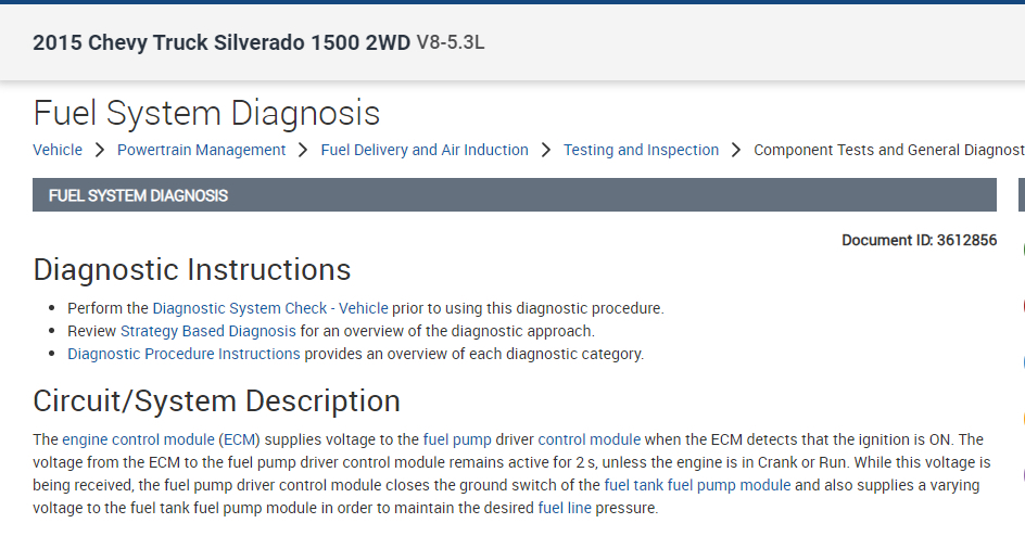

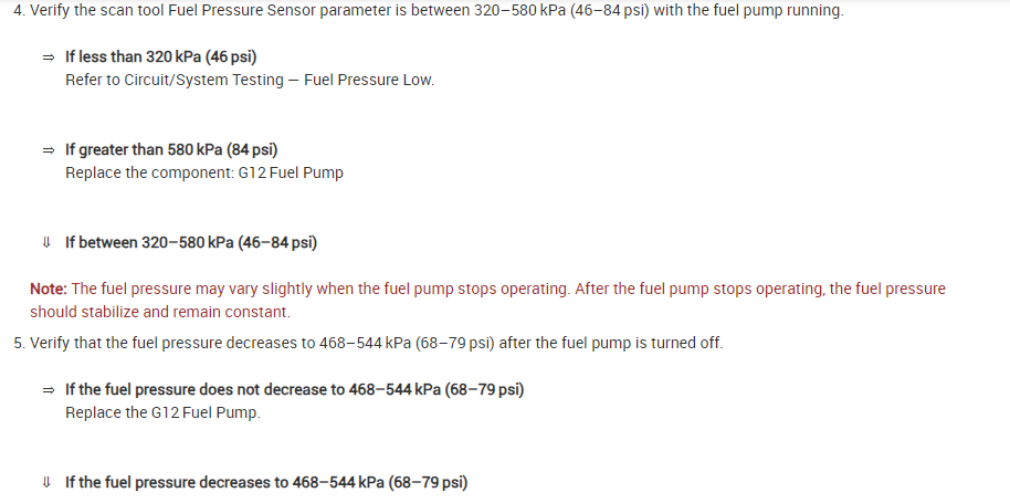

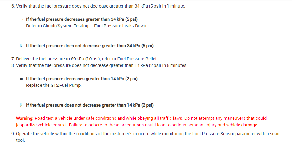

Since we know it isn't getting fuel, I attached diagnostics below for the fuel supply system. They require a scan tool to perform. I'm not sure if that is something you have.
Take a look through the diagnostics and let me know if you are comfortable performing them.
Feb 4, 2024 at 12:10 PM

It is very hard to read it it shows just partial and when double tap it does in large it but then try to go to next section it doesn't show it.
Feb 4, 2024 at 12:59 PM
  • 110,244 POSTS
Which one are you having trouble with reading? Let me know and I'll enlarge it for you. Also, I was thinking about the issue. We may even have fuel pressure but no injector pulse. However, I feel that is less likely. Once we can confirm there is or isn't pressure, we can cross that road.
