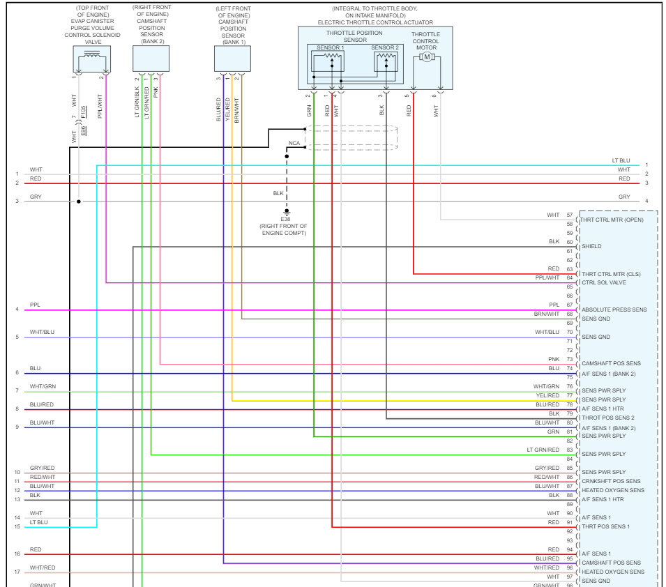

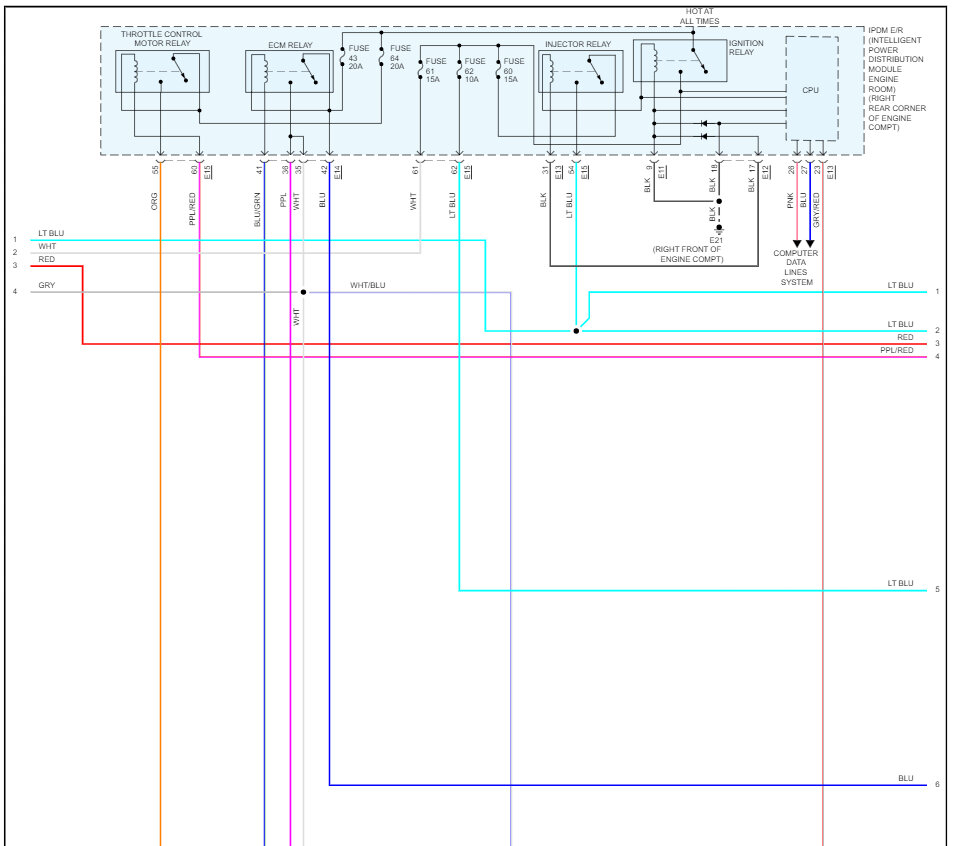

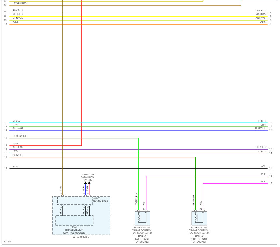

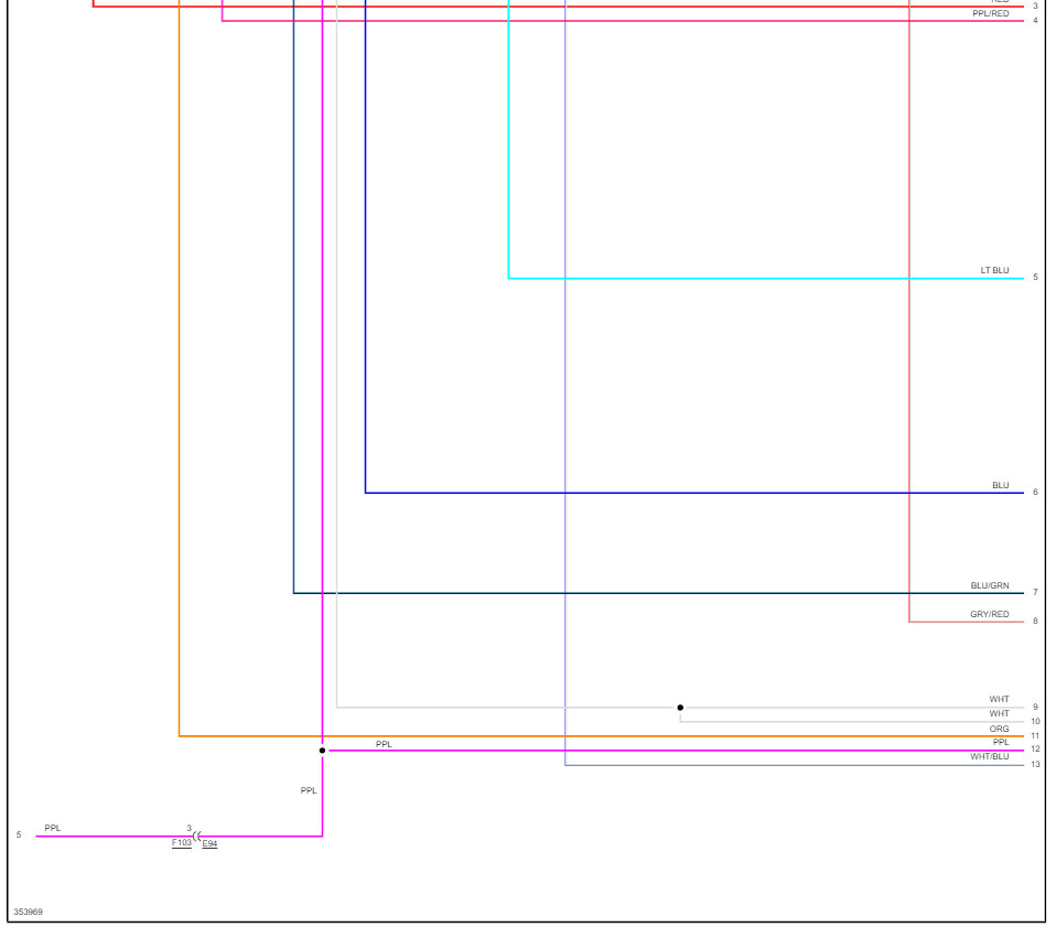

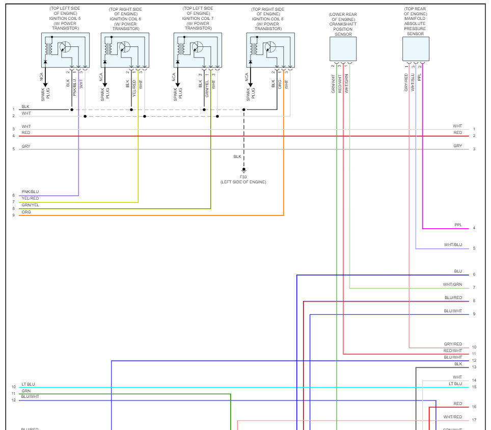

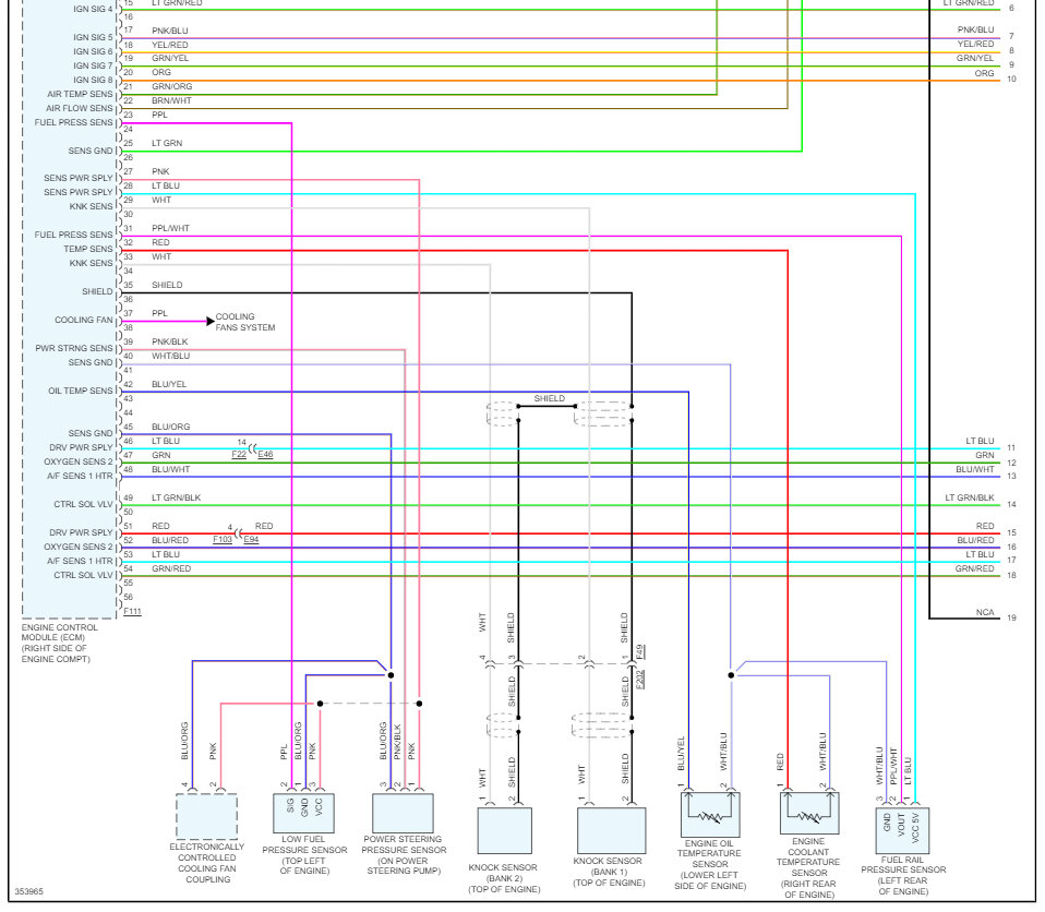

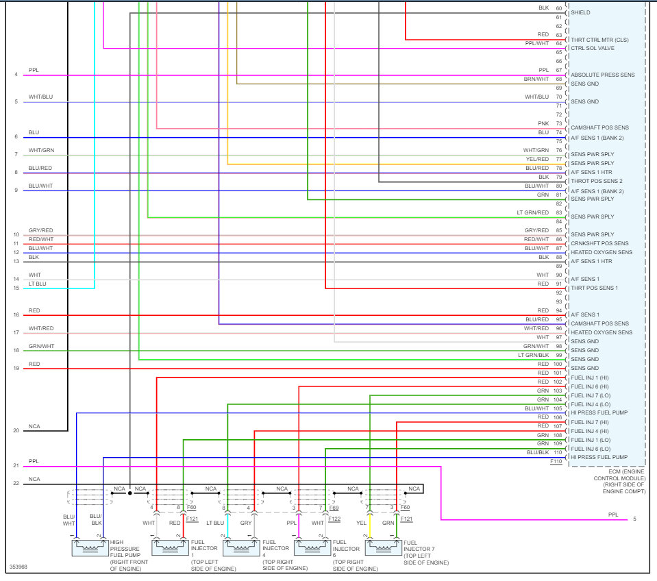

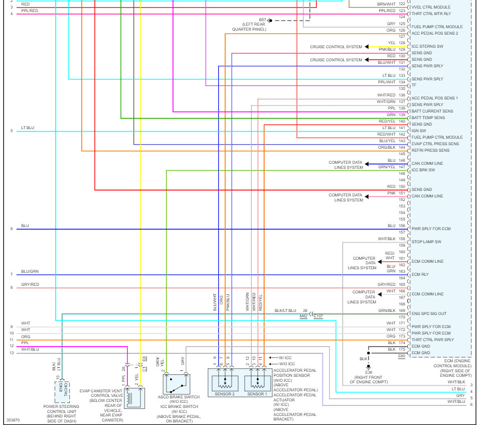

A new bit of information to add: the owners also replaced the crank sensor because of a p0335. This does not show up in the memory but that could also be from sitting for months. So, I thought to try tracing the problem beginning there, I have a diagram showing the 3 crank sensor wires going to pin #s 76, 86, and 98. However I do not have a pinout of the ECM side. Please let me know your thoughts and any advice.
Jul 23, 2023 at 11:44 AM
  • 55,688 POSTS

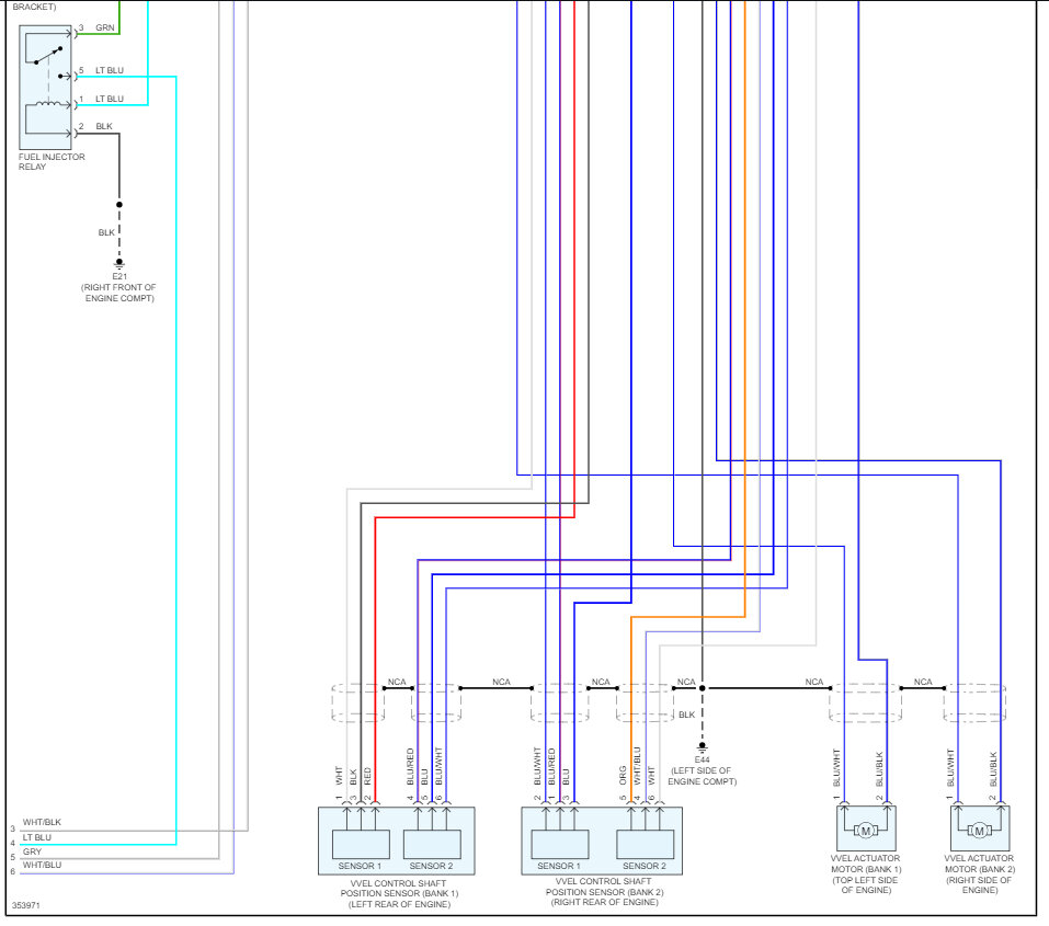

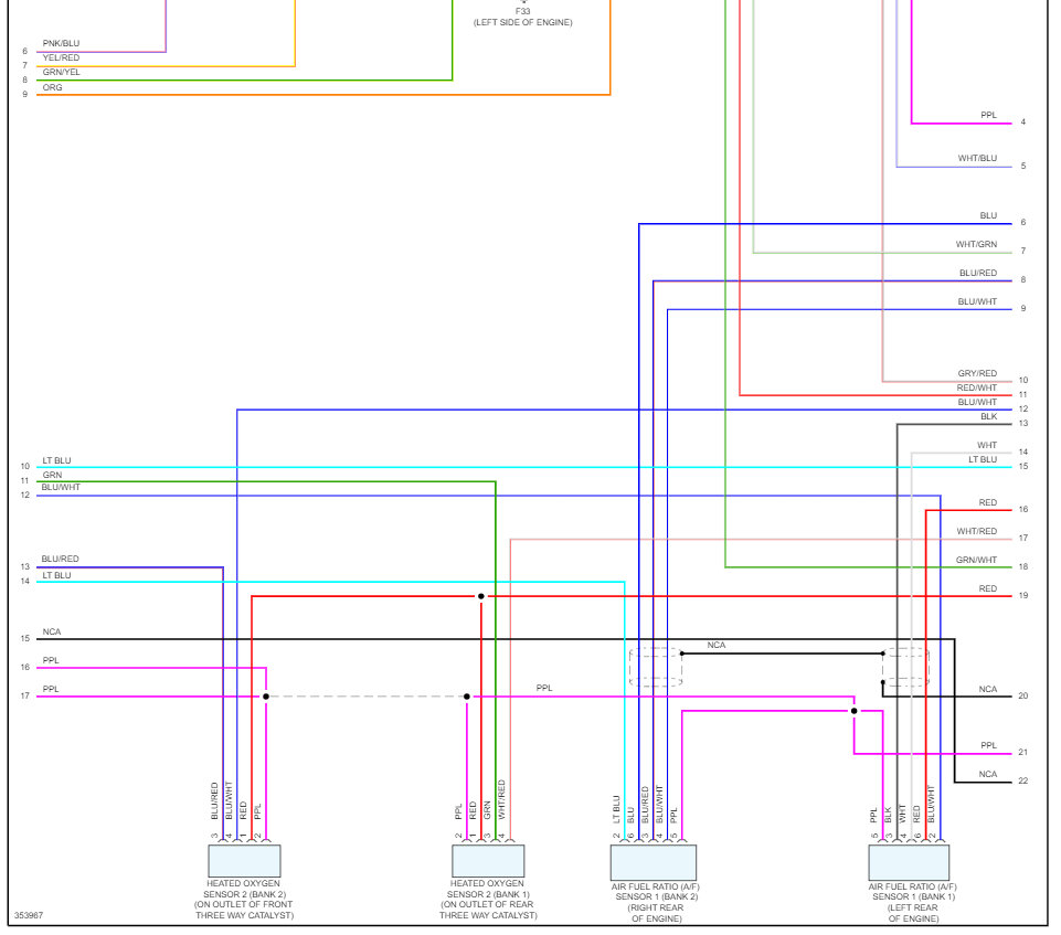

Can I ask if the engine will run on starting fluid? Here is a guide to go over to help us get started on fixing the problem:
https://www.2carpros.com/articles/car-not-running-advanced
Here are the PCM wiring diagrams and a guide to help test the connections:
Check out the images (below). Please let us know how it goes.

Hi, the car will not run on starting fluid. It definitely seems like a bad ground issue, because the battery will barely engage the starter at 12v. So, something is taking the most of the power. I probed the connector at the CKP sensor and got 5v, but OL reading at terminals 2 and 3. I got the same reading from the ECM connector side but maybe I was testing them incorrectly, so I'll try again tomorrow. Unfortunately, the distance between the CKP and ECM is too long for my meter. But I used the body as a ground to test resistance to the wires.
Another note: I saw no grounds in the wiring diagram for the CKP. Does this mean the 3 wires go straight to the ECM? Or does where each colored wire cross in the diagram indicate a connection path?
Once more: I tested the Camshaft position sensor, on top of the engine, and terminal 1 - 2 gave infinite resistance. Terminals 2 - 3 gave a resistance reading. Would this indicate a bad camshaft sensor? Sometimes the guides indicated the reading as "except 0 or infinite".

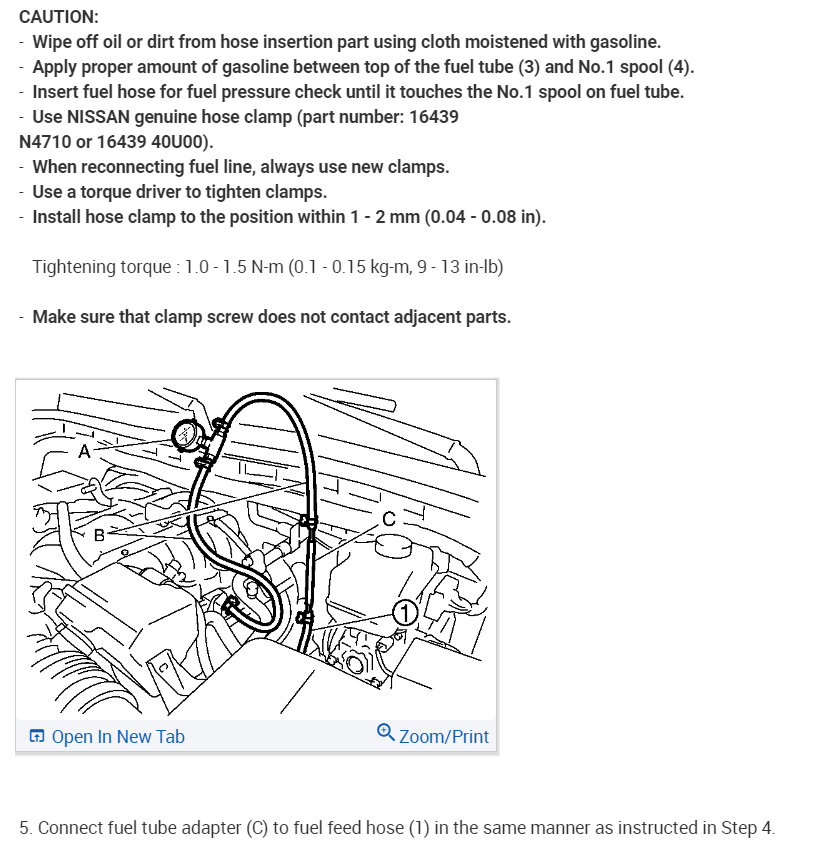

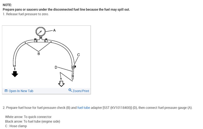

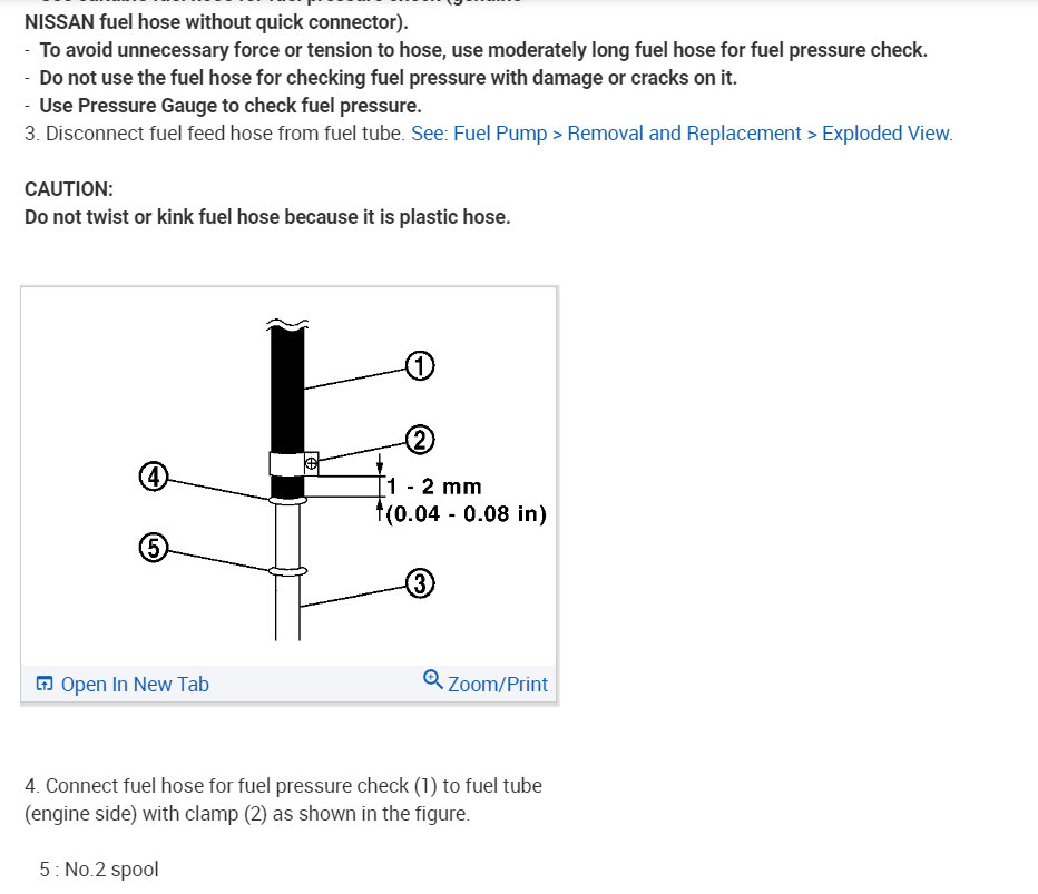

I retested what I mentioned above and got different but correct results. No opens in that circuit. With nothing to lose, I basically poured starting fluid into the engine, and I finally started getting sputters out of it, but it would not run. Should I continue to pursue a fuel issue? The owners did replace the fuel pump, and I can hear it running before attempting to start the vehicle.
Jul 25, 2023 at 11:27 AM
  • 55,688 POSTS

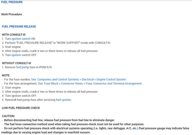

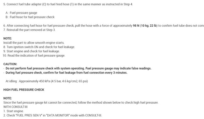

Yes, I would check the fuel pressure here are the specs and a guide to help walk you through the test.
Fuel Pressure (At Idling) .................... Approximately 450 kPa (4.5 bar, 4.6 kg/cm2, 65 psi)
Use can rent a fuel pressure gauge from the auto parts store for cheap. Please go over this guide and get back to us.
Jul 25, 2023 at 12:15 PM

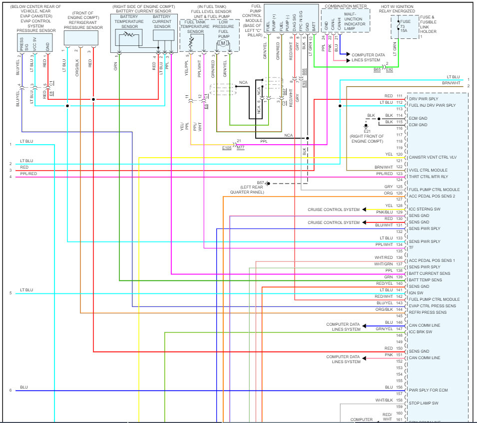

I haven't made it to the store for a fuel pressure gauge, but I did go ahead and check electrical connections at the pump and pump module. I am receiving battery voltage at the pump connector and the module. But I noticed at the module the resistance between the wires/pins on the module for the green/yellow and green/red is 35K ohms. Don't you think this is a bit excessive? I cannot hear the pump humming when I put the key in the on position. Is there a testing procedure for the module?
Jul 26, 2023 at 10:52 AM
  • 55,688 POSTS
Testing the module will be involved, do you have 12 volts to the pump? If so, the pump is bad.

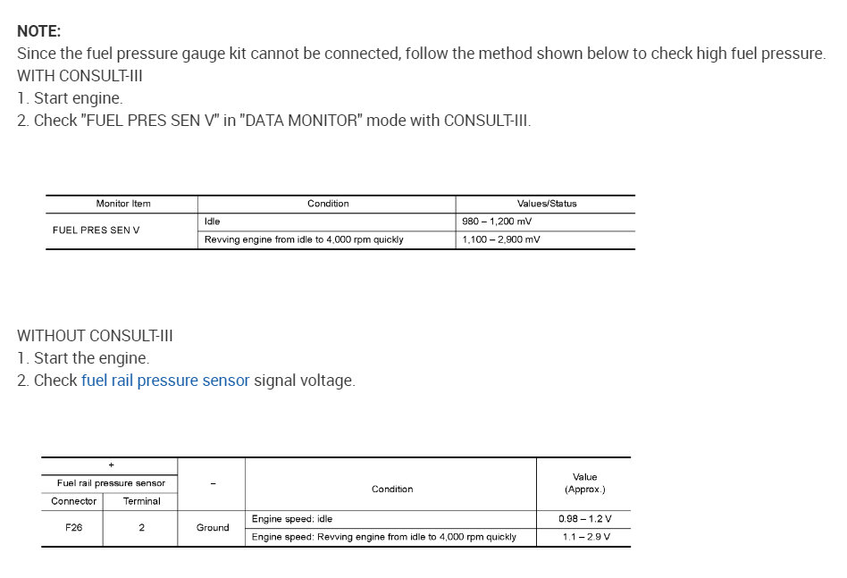

I replaced it and the car tried to start but sounded like it was starting with 3 cylinders. I looked into it, and it turns out the connectors for the camshaft sensor bank 1 and the sensor attached to the intake manifold were melted. I suppose this caused the car to retard the timing and sound this way, at least I'm hoping. When I replace the connectors, I should have 5v reference right? What are the specs for these two connectors? Also, the new starter solenoid wire casing was a powder-y white.
Aug 1, 2023 at 10:17 AM
CANNON1349
  • 861 POSTS
Hey guys. I replaced the connectors and it tried to start like normal. But now I can get the car to start but only with starting fluid. I feel like progress is made because all it takes is a little starting fluid and then the car will run just fine. Here's some quirks I'm thinking are related to the issue:

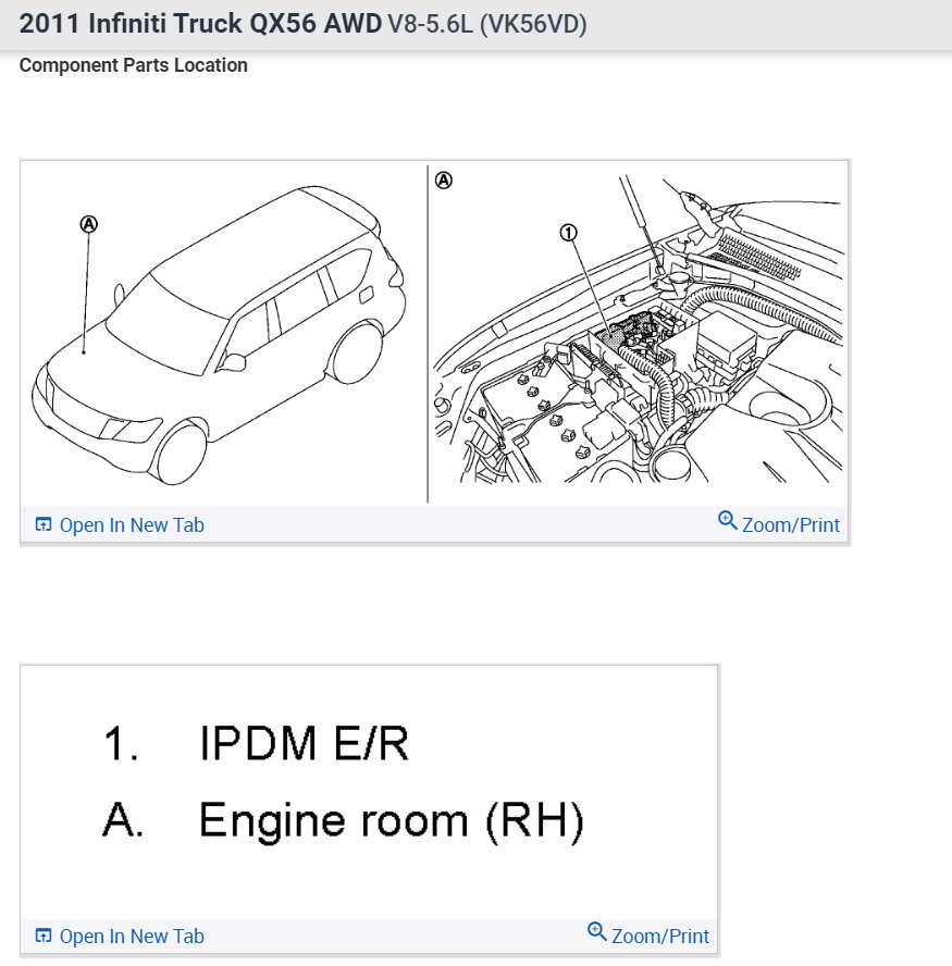

The vehicle was towed in with a crank with no start condition. High pressure fuel pump and low-pressure fuel pump were replaced, as well as the MAF and the electrical connectors for the camshaft sensors and crank sensor. The crank sensor has been replaced with an OE part. The car will start with a little starting fluid but sometimes you just need to have your foot just right on the gas pedal and it will finally start. When using the scan tool, the codes P0335, P0345, P0340 show up as well as C1130 from the ABS module saying no engine signal 1.
When I clear the codes as the car is running it will stop the car. When the code returns usually it is only P0335 and it will show me the freeze frame data showing that the engine RPM is 0. However, if I can get the car running, I can see an RPM signal. I have a feeling that using the starting fluid allows the car to spin just fast enough to pick up a signal and allow it to start, because otherwise the car runs and moves fine. I did a little research about the IPDM having potential issues because of the internal relays or the ECM being toast. The only thing that happened to this car is that it sat without being driven for 6 months.
Aug 10, 2023 at 4:36 AM (Merged)
  • 55,688 POSTS
Sorry for the delay. Oh, yes, the IPDM has problems in these cars, but they are easy to replace because they self-learn. Here is the location and how to change the part out:
IPDM E/R
IPDM E/R has steering lock relay, starter relay and starter control relay inside. Steering lock relay is used for the steering lock/unlock function. Starter relay and starter control relay are used for the engine starting function. IPDM E/R controls these relays while communicating with BCM.
Have you performed a CAN scan? You can get a CAN scanner (Controller Area Network) which will work on most cars from Amazon.
here is a video to show you how:
https://youtu.be/u-4syLc-ifQ
Aug 10, 2023 at 4:39 AM

Hey, I tried an IPDM and it didn't change anything. It looks like to me the ECU has an internal issue. I say this because the diagnostic procedure for P0335 says to check the circuit voltage for other sensors that share the same ground terminal (150 on the E80 connector), like the refrigerant pressure sensor, evap pressure sensor, cam sensor, battery current sensor, etc. And I am getting around 100mV for all of them when the specified voltage is much higher than this. I am back probing the connector with a fully charged battery and I cannot seem to wrap my head around it. I did see in the ABS module a stored C1130 code that immediately comes back every time I erase it. What do you think?
Aug 18, 2023 at 9:28 AM
  • 55,688 POSTS
If you have replaced the sensor and checked the wiring there is only the PCM left, it sounds like you are on the right track.
