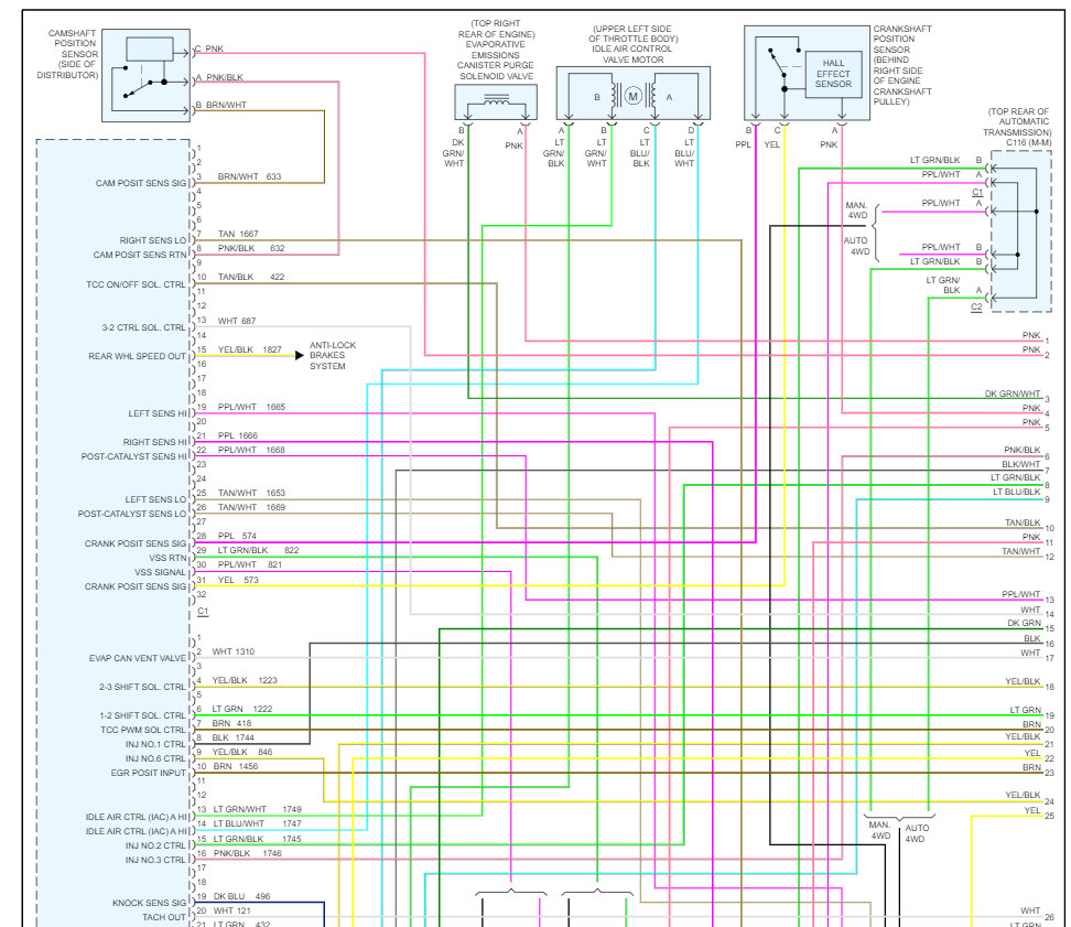

I used my scanner only code that popped up was p1351 which is shows to be ignition control module. I installed a new one and nothing happened. I pulled my distributor cap off and it was a little dirty, so I cleaned it up with a wire brush. The rotor looked good. Did some research saw someone with an identical motor had the same problem and they replaced the crankshaft position sensor and it worked. So, i replaced my crankshaft position sensor and it caused something to spark but I cannot find out where the spark is coming from.

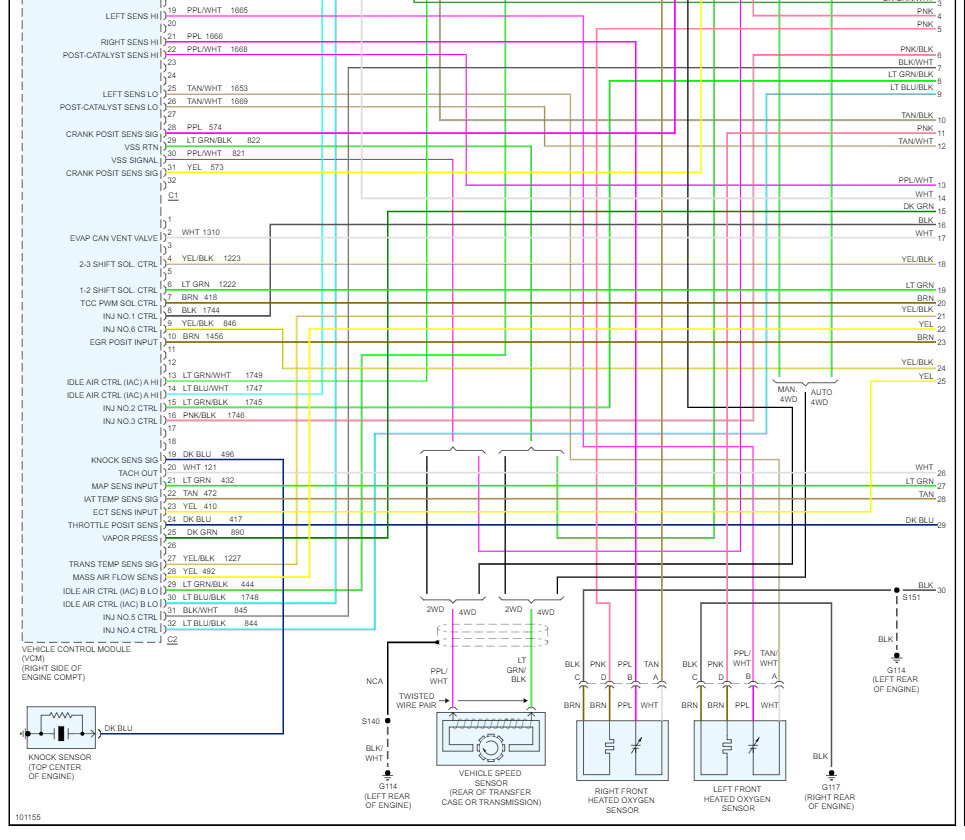

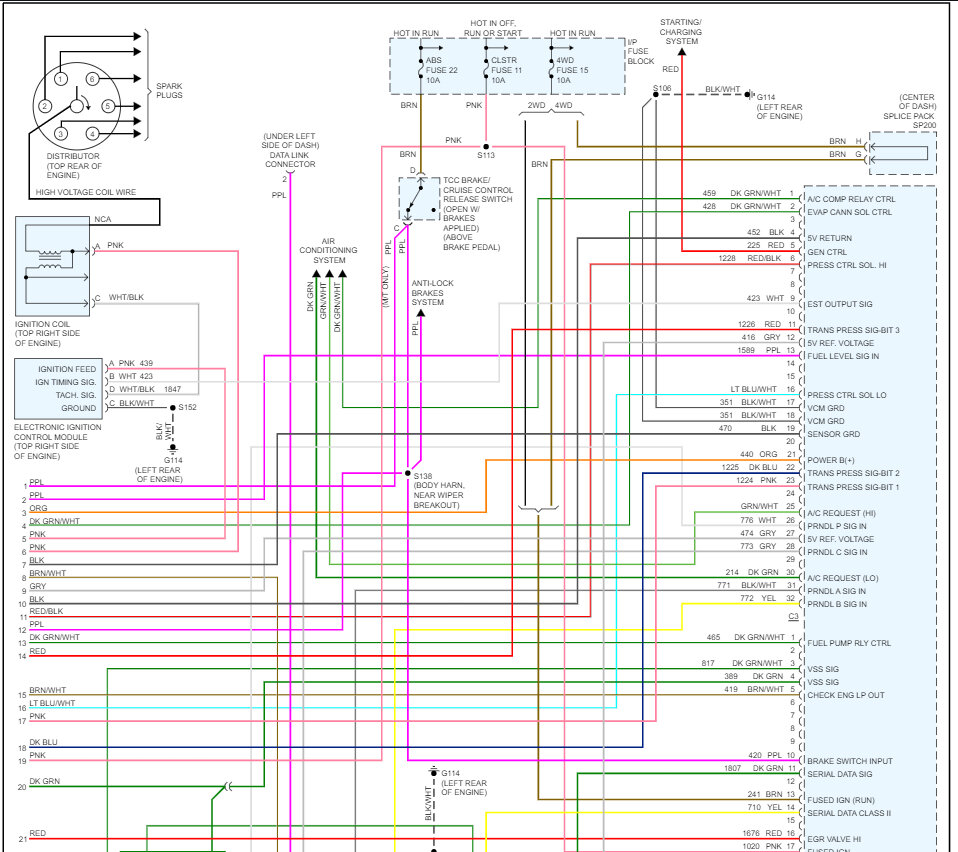

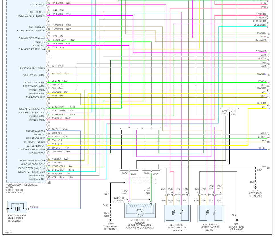

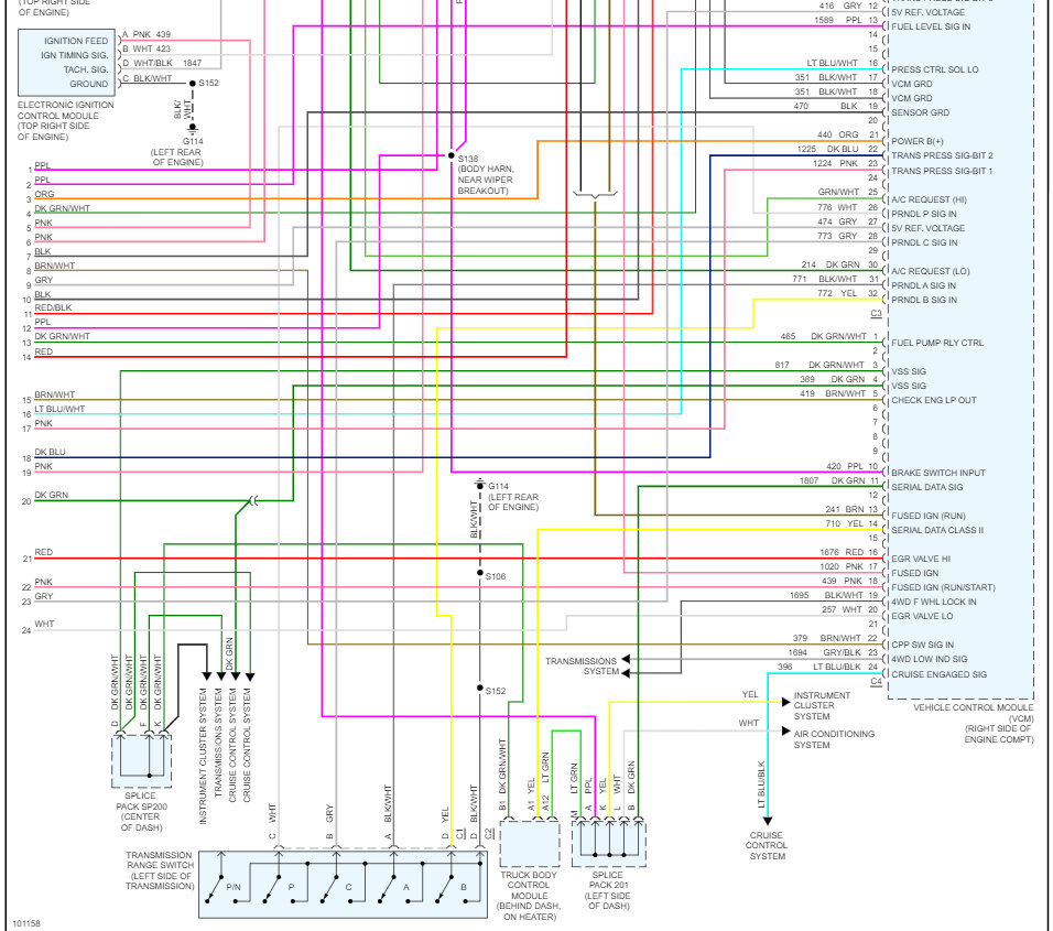

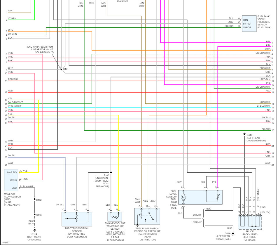

Okay, let's see if the ignition system is getting power. here is a guide to help you test the connections and see how the system works:
Check for power on the pink wire to the coil and at the fuses, also check the PCM ground because the PCM might be bad. Check out the images (below). Let us know what happens and please upload pictures or videos of the problem so we can see what's going on.
