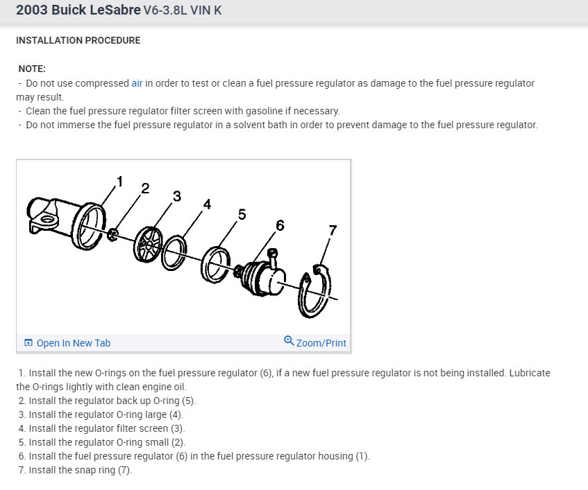

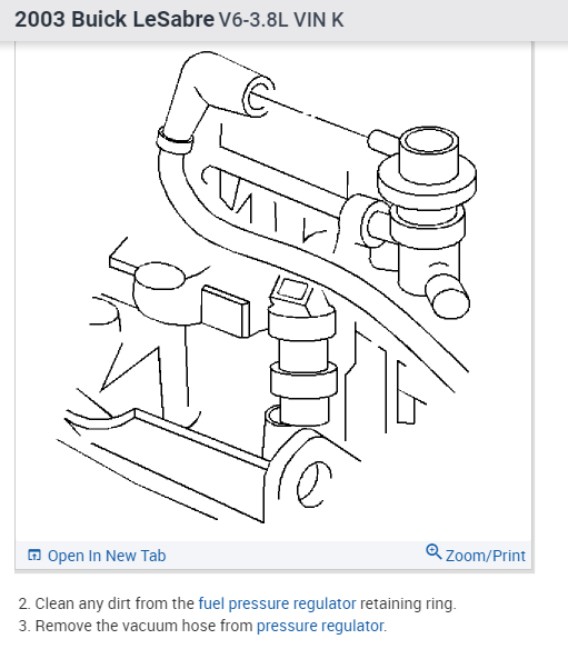

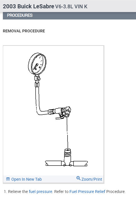

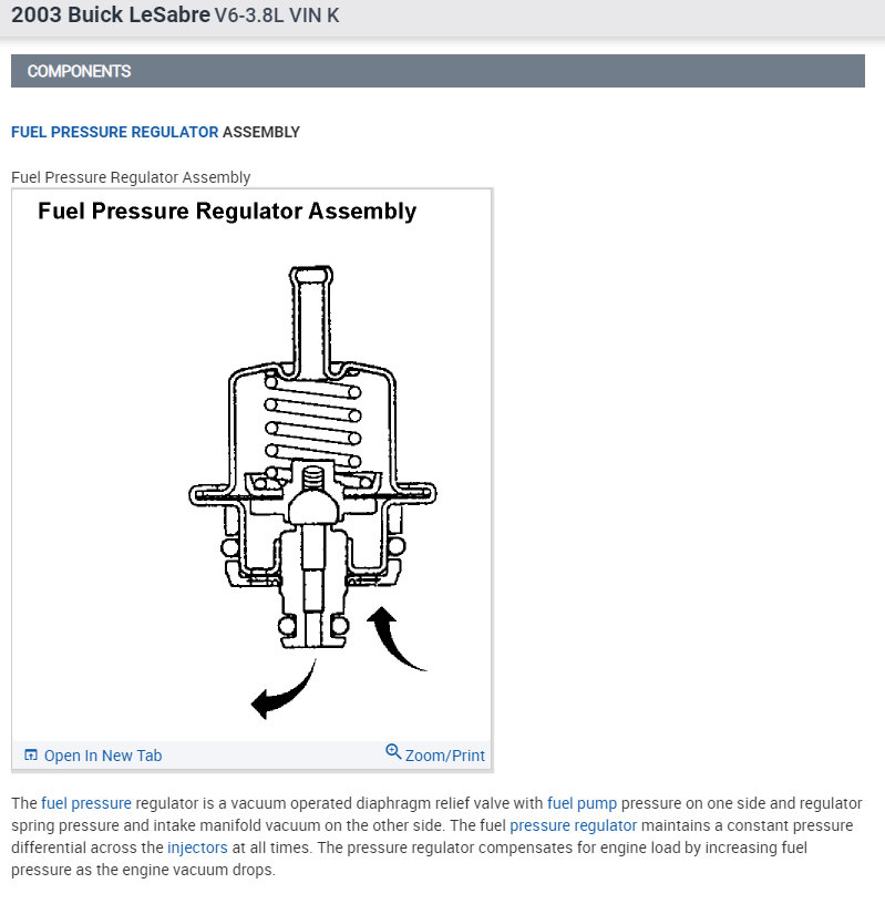

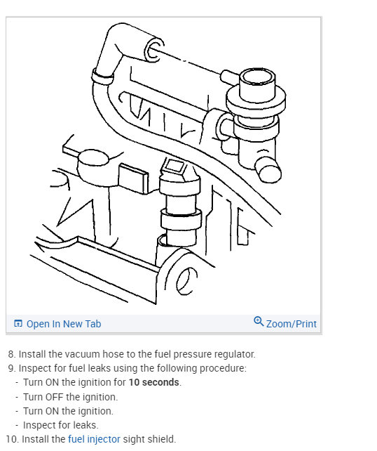

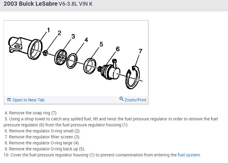

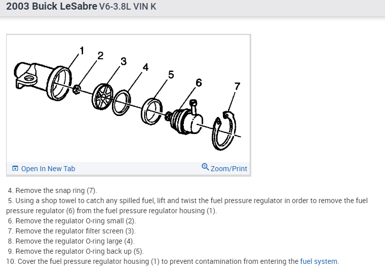

Have you checked to see what the fuel pressure is?
It is possible to have a weak pump of a faulty regulator which won't allow fuel to enter the cylinder.
On this vehicle with the key on and engine off it should have 53-59 PSI of fuel pressure.
Also, what symptoms did you have before this crank/no start issue?
Please let me know a bit more details.
