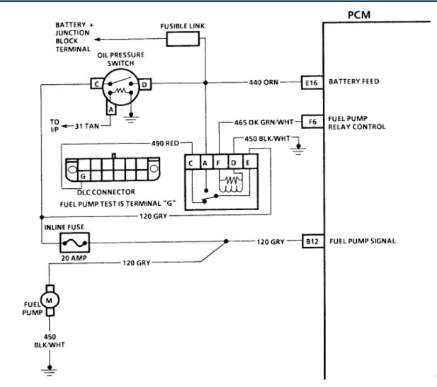

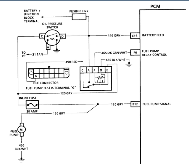

It sounds like you might be having a ground issue at the fuel pump-fuel tank area. The 88-98 obs trucks are notorious for this happening. Here is a tutorial showing how to check wiring:
I've attached the fuel pump wiring diagram below for your truck. The first thing I would suggest is to check the fuel pumps ground to make sure its not loose, broken, corroded, or otherwise damaged. Get back to us and let us know what you find and we'll go from there. Attached is a picture of my 1989 K1500 below. Hope this helps and thanks for using 2CarPros.

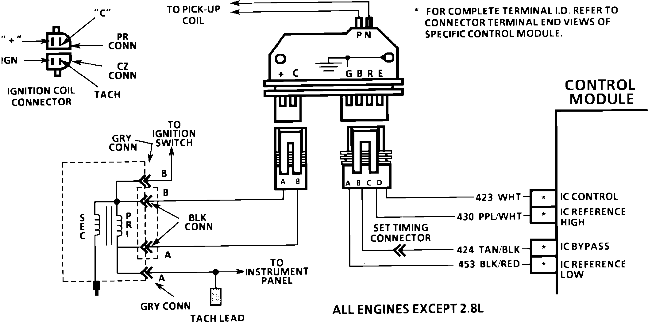

Hey Danny, so I went over the ground wires for the pump and it's still having the issue I can hear the fuel pump now though. it will run for a lot longer now but when I take the key out and try starting it again the truck just sits there and cranks and won't start. could it be spark I know with the 1990s Chevrolet's they had issues with the distributor some times it just doesn't seem like it should have had an issue.

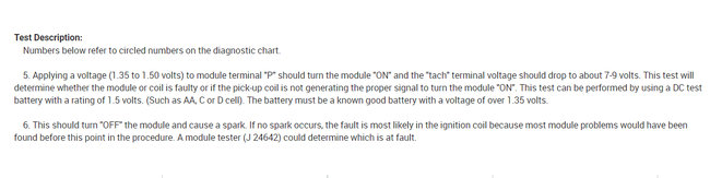

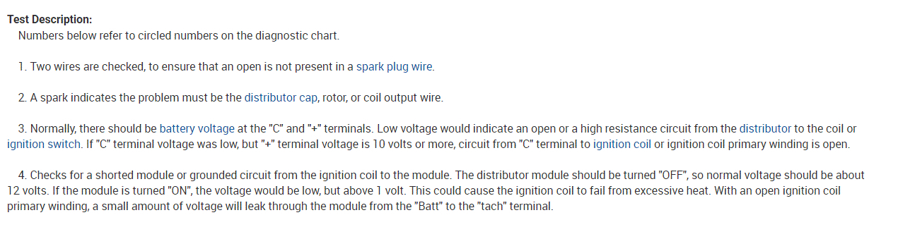

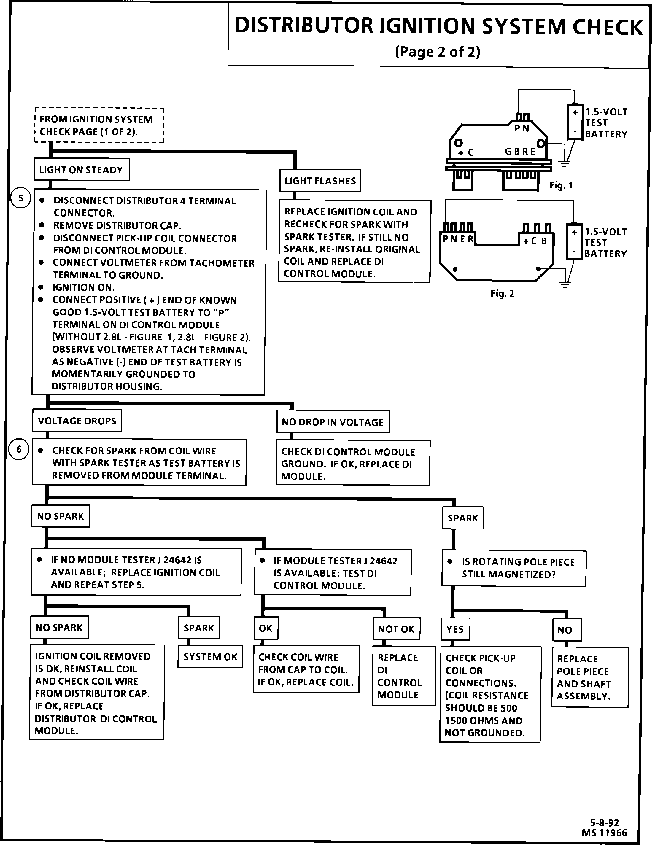

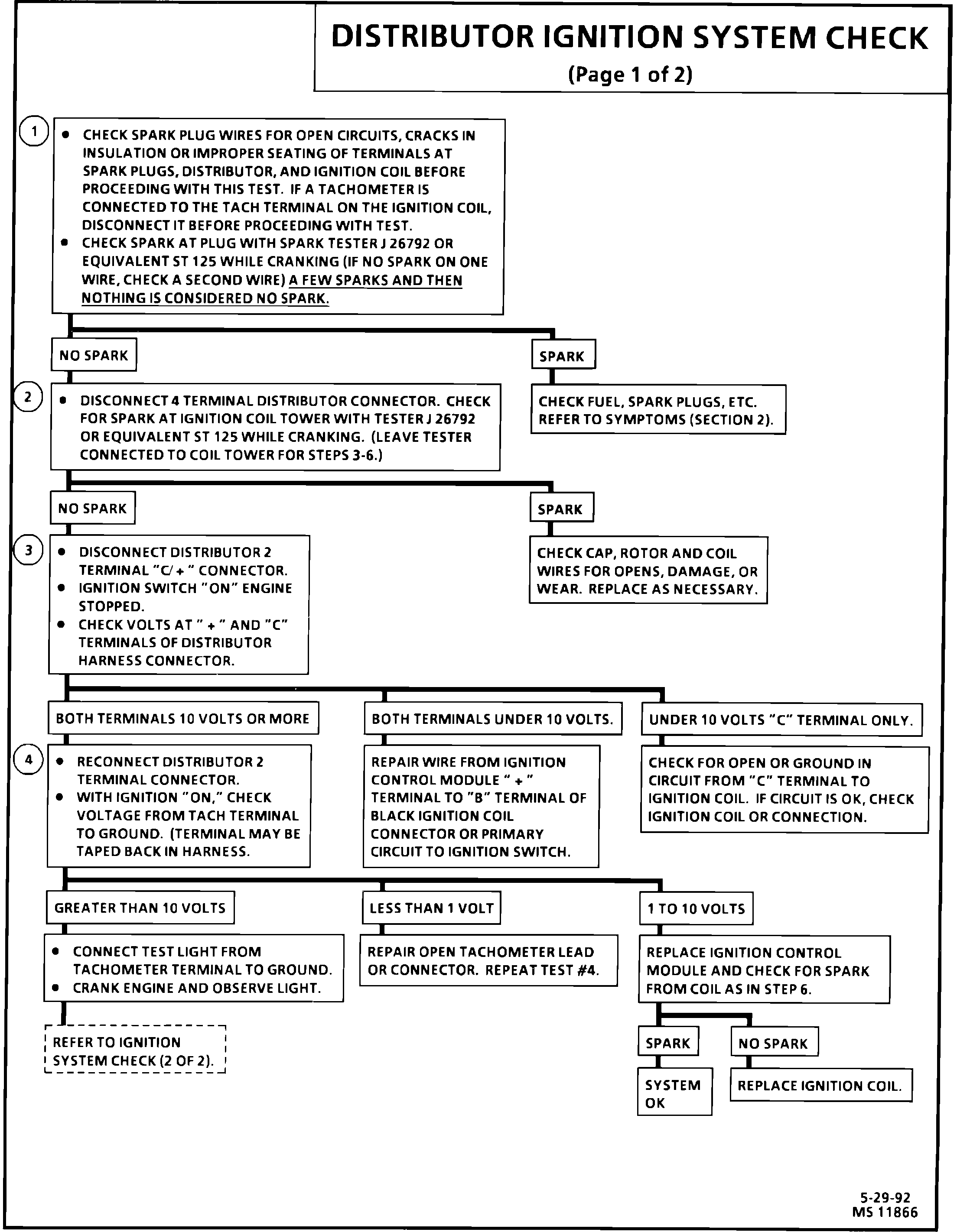

I noticed it has been a couple of days since we heard from you. Has any progress been made? Also, I read through the thread and if you have good fuel pressure, that isn't the issue. So, yes I recommend checking for spark when it won't start. Here is a link to help with that:
Also, if it won't start, see if it will if you use starting fluid. If it starts and then stalls, then we know it is fuel-related. If it still won't start, then it is likely ignition-related.

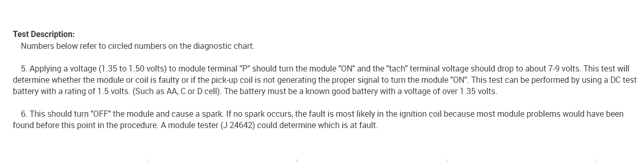

Now, if there is no spark, there is a good chance the ignition control module is bad. What I need you to do is perform the tests listed below in the attachment section.
Also, if you haven't already, check to see if there are diagnostic trouble codes stored in the system. This truck has an OBD1 system. You don't need a scan tool to check it. All that is needed is a short jumper wire or even a paper clip. Here is a link that explains how to check for codes:
https://www.2carpros.com/articles/buick-cadillac-chevy-gmc-oldsmobile-pontiac-gm-1983-1995-obd1-code-definitions-and-retrieval-method
If there are codes, let us know what they are.
Let us know what you find or if you have other questions
