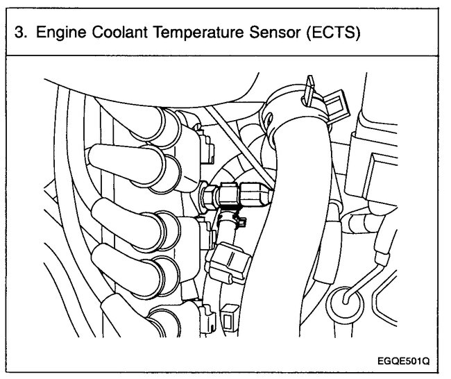

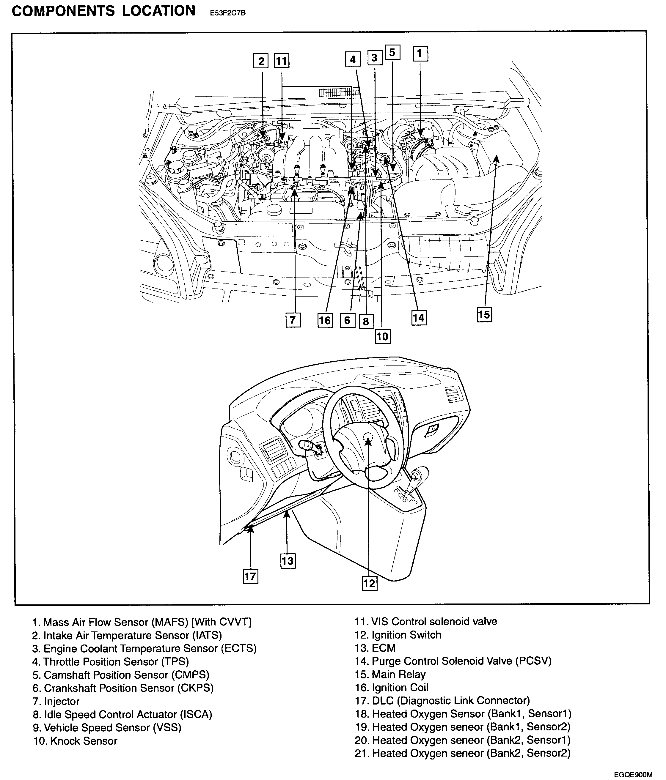

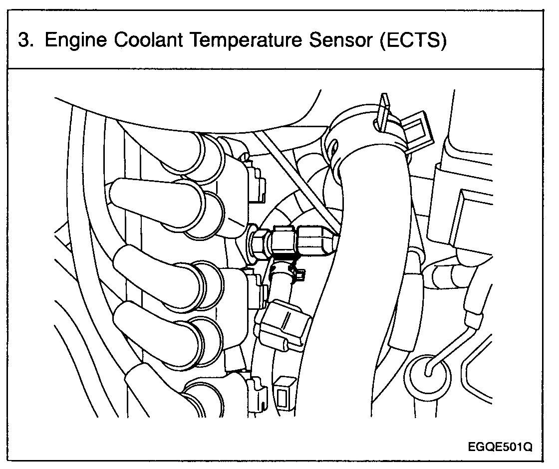

Has the engine coolant temperature (ETC) sensor been checked? The ETC is responsible for telling the computer the coolant's temp. Based on that, the computer determines how rich or lean to make the air/fuel mixture. If it is too lean because it thinks it hotter than it is, the engine will struggle to start.
This can be checked with a live data scanner to determine what temp the sensor is telling the computer. It should be very close to the ambient temp (engine cold).
I attached a picture of sensor location as well as a close up of the sensor. I would suggest starting there.
