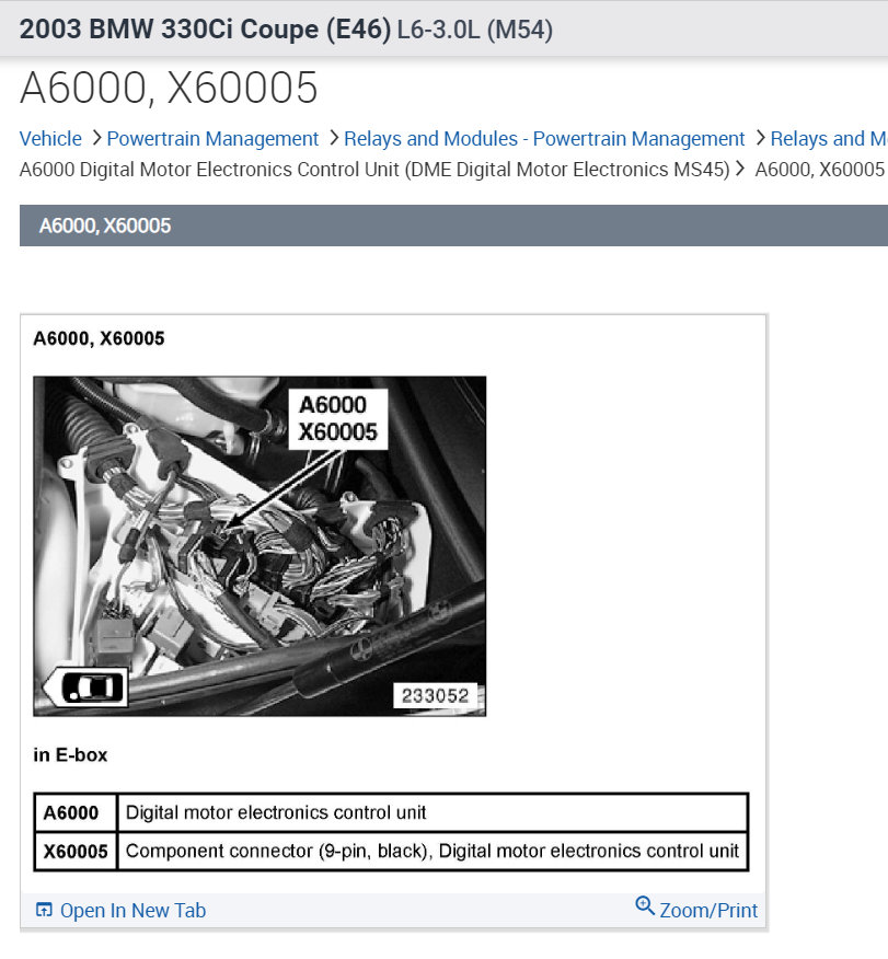

It sounds like the DME is going out. To be sure let's do a CAN scan, you can get a CAN scanner from Amazon for about $30.00. Here is a video to show you how. The thing is you may or may not get a code for the DME because the computer doesn't always tell you it is bad but if there is something else the scan can pick it up.
https://youtu.be/u-4syLc-ifQ
Here is a scanner link:
https://amzn.to/3o41KcZ
Here is the location of the DME in the diagrams below. Check out the diagrams (below). Please let us know what happens.
