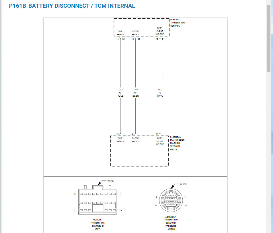

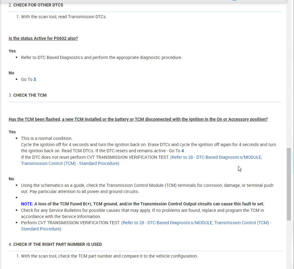

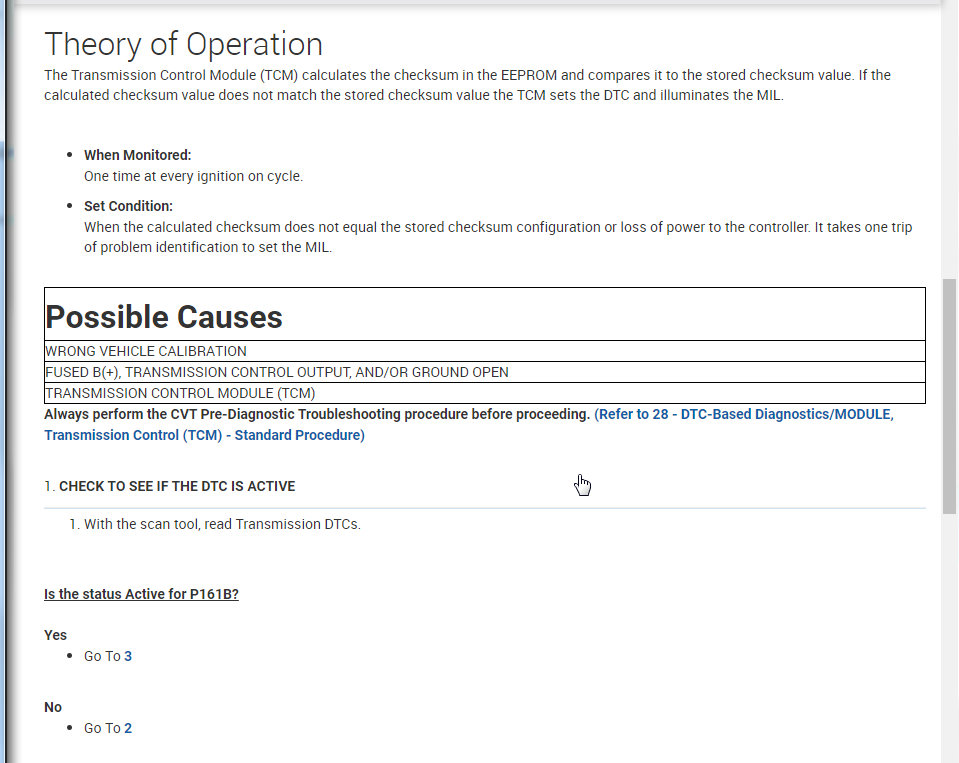

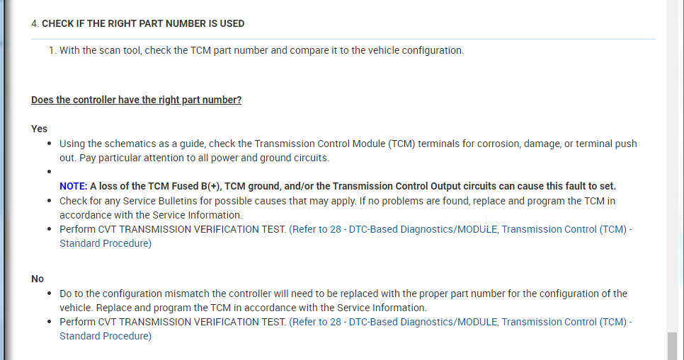

The P161B code if active could be the issue. This code is saying that the TCM is offline.
We need to know this by using a scan tool to see if you can communicate with the TCM.
I attached the testing below for this code. So let's run through this and go from there.
If you have fuel and spark then it should start so I suspect the PCM is not sending spark due to the TCM not communicating the info needed.
Then we need to pull a plug and connect it back to the coil and hold it against the block and crank the engine to see if there is spark and confirm what we are suspecting.
Let us know if you have questions and we can go from there. Thanks
