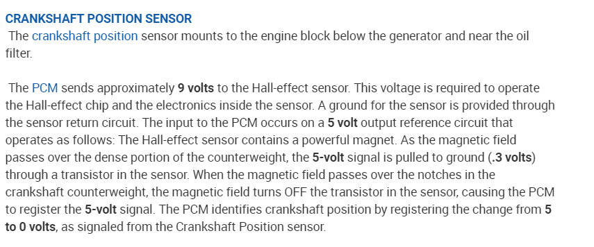

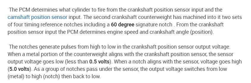

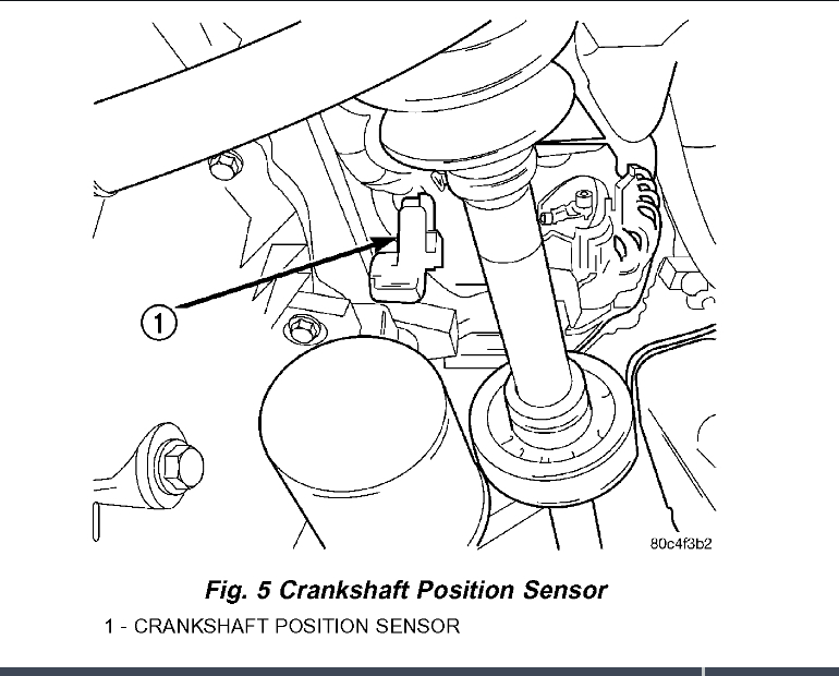

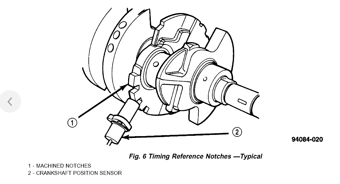

This could be a problem with your vehicle's Crankshaft Position Sensor (CKP). Your vehicle uses the signal from the CKP to determine the location of each cylinder for firing the spark plugs and for misfire monitoring. I have included a few links below for you to go to:
https://www.2carpros.com/articles/how-a-crank-shaft-angle-sensor-works
I have also included specific information on your vehicle's CKP in the diagrams down below. Please go through these guides and get back to us with what you are able to find out.
