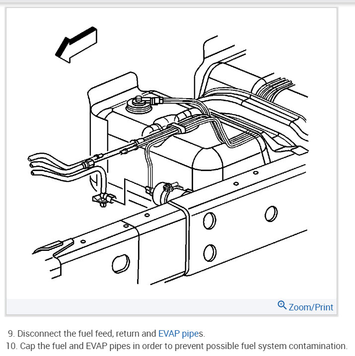

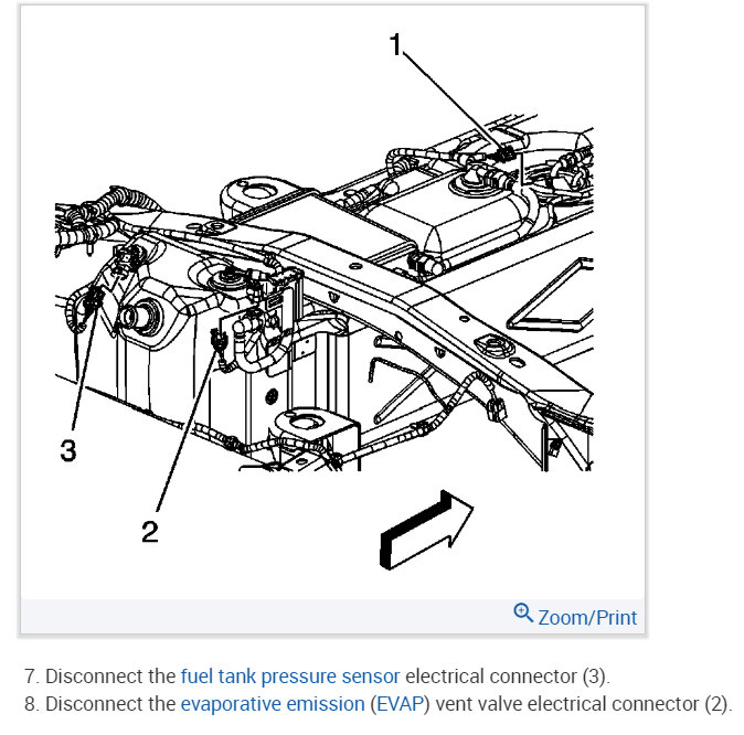

Crank no start?
250,000 MILES • 5.3L • V8 • 4WD • AUTOMATIC
JEFF HERMAN
  • 486 POSTS
I hear the pump prime, no fuel to the rail. Truck has sat for 3 years. I'm suspecting the hose between the pickup and pump rotted away due to ethanol. The same thing happened to my 1989 Suburban that sat. Any other ideas before I pull the sending unit/pump? Is there an access port from the top?
Oct 29, 2022 at 10:31 AM
  • 55,721 POSTS

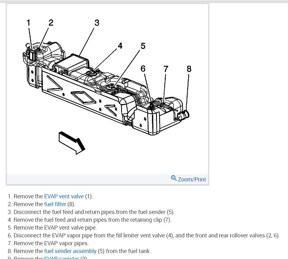

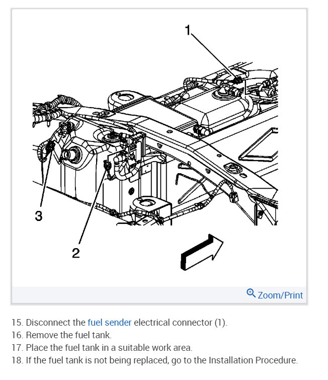

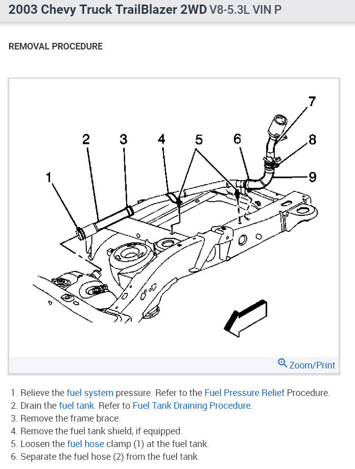

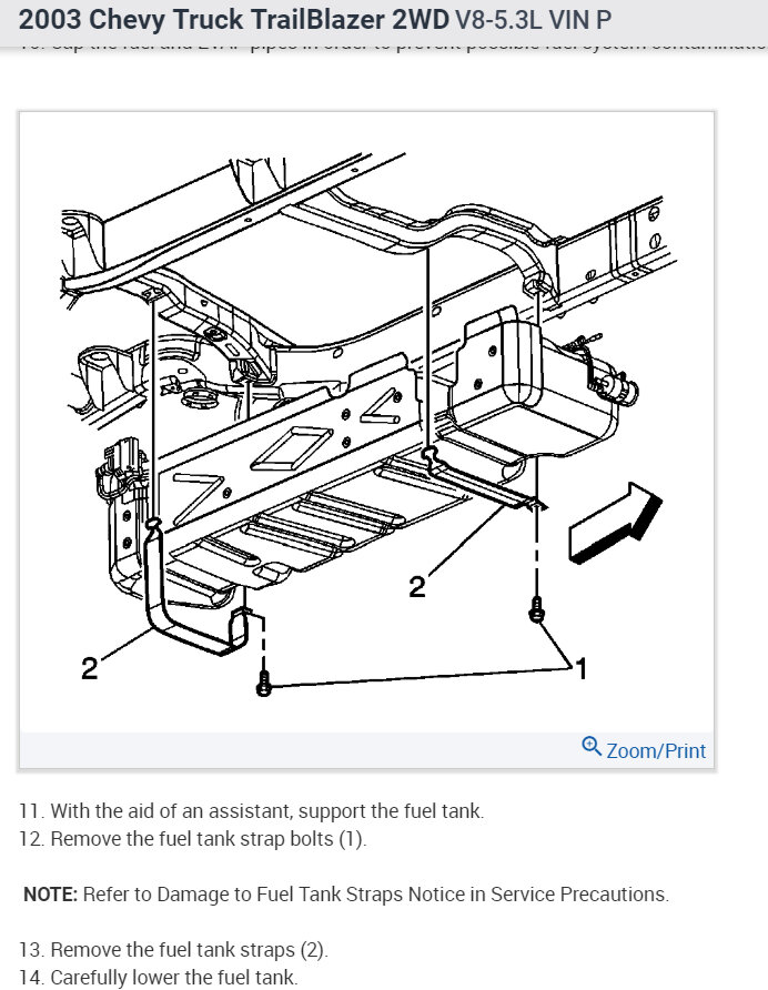

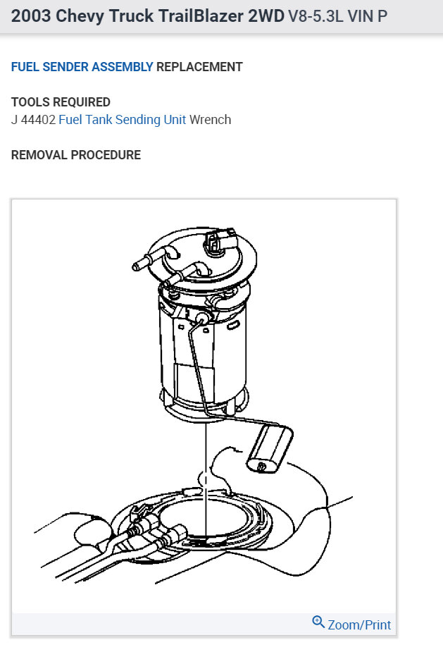

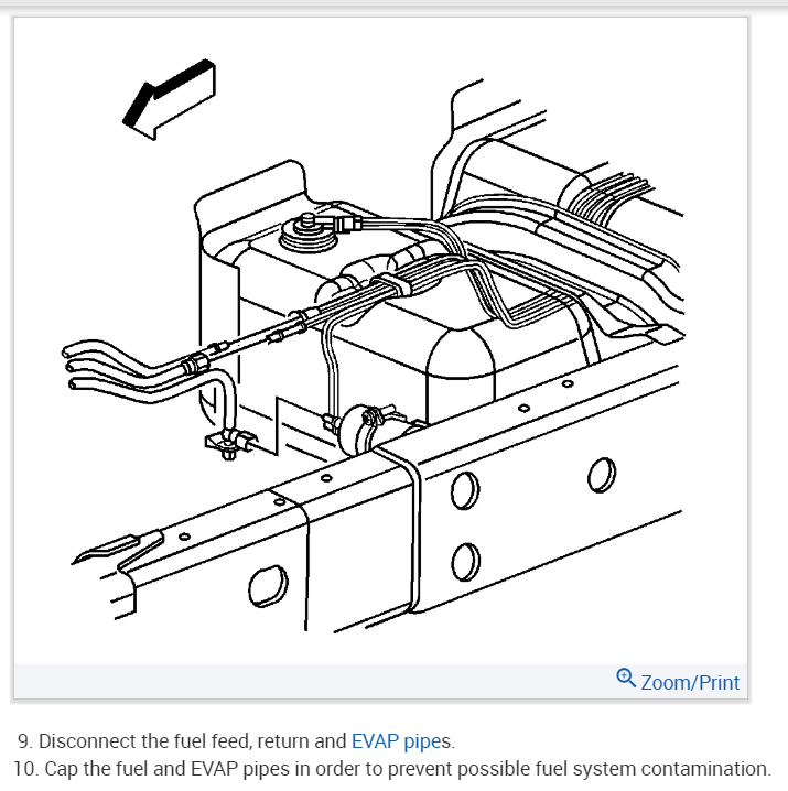

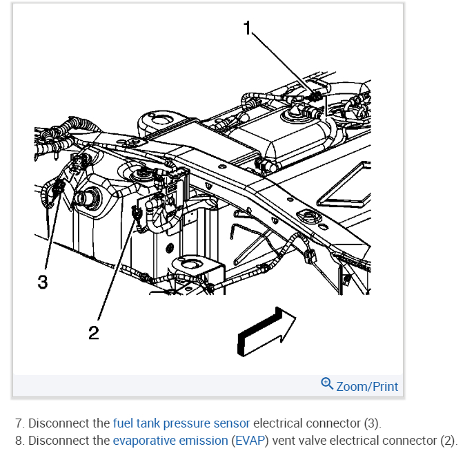

Will it run on starting fluid? If so, I would say you are on the right track. Here are instructions on how to do the job in the images below. Check out the images (below). Please let us know if you need anything else to get the problem fixed.
Oct 30, 2022 at 8:47 AM
