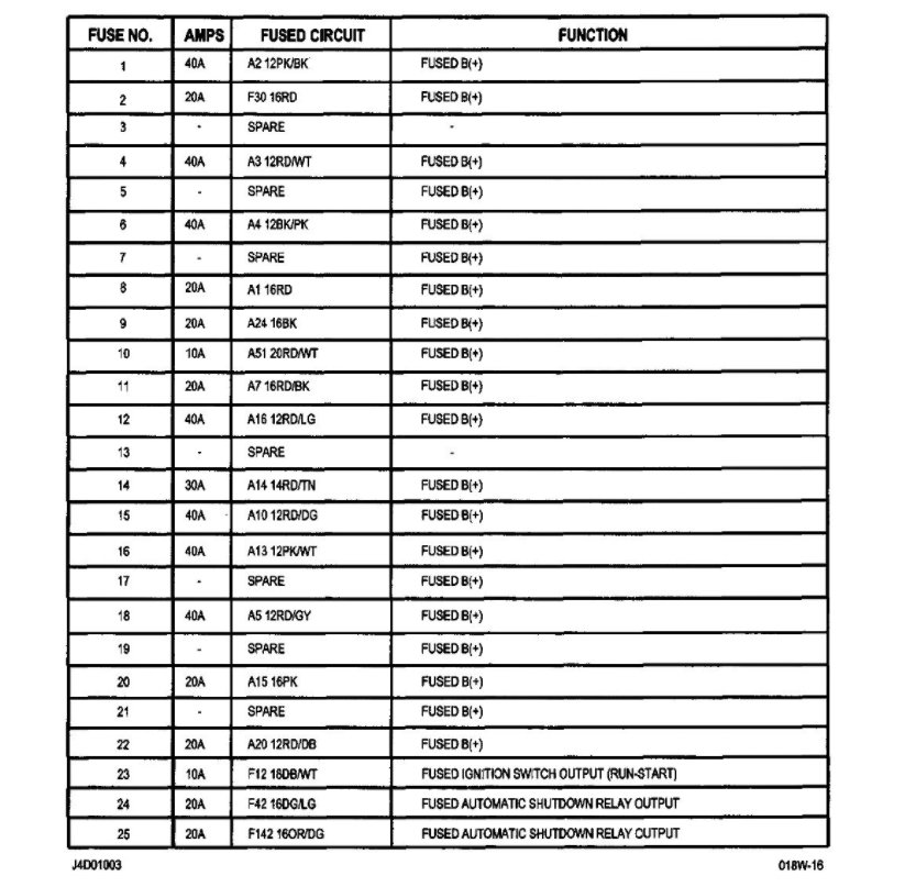

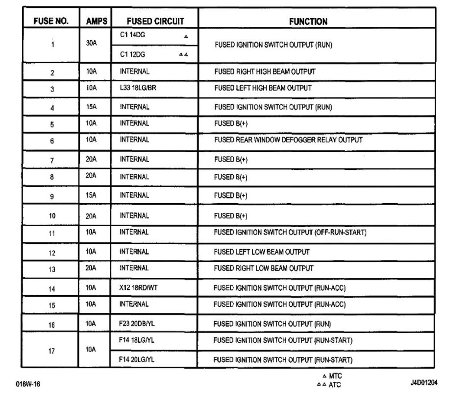

No spark or power to fuel pump and some fuses on outer fuse box have no power.
Nov 20, 2020 at 8:36 PM
Good morning,

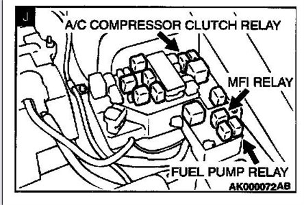

Can you tell me the fuse numbers so I can get a diagram of the fuse box?
I attached the picture of the fuse blocks for you. Please identify which fuses have no power.
Nov 20, 2020 at 10:08 PM
KRISB1985
That some of my problem too. I don't have fuse cover and having hard time trying find one on line it's Dodge Stratus r/t 3.0 Mitsubishi motor the outer fuse box looks like this. I don't know if that helps any.
Nov 20, 2020 at 10:56 PM
That is the first diagram I posted to your question. Please identify the fuses with no power for me.

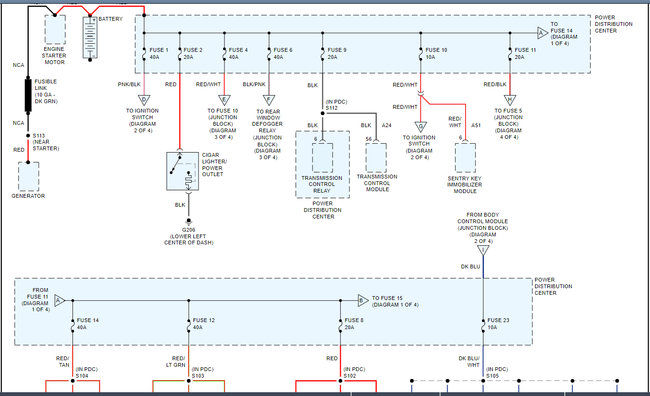

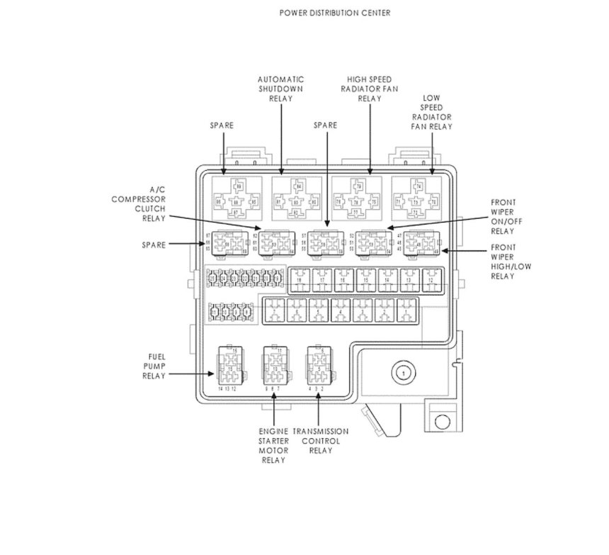

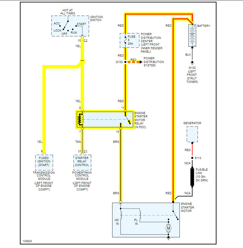

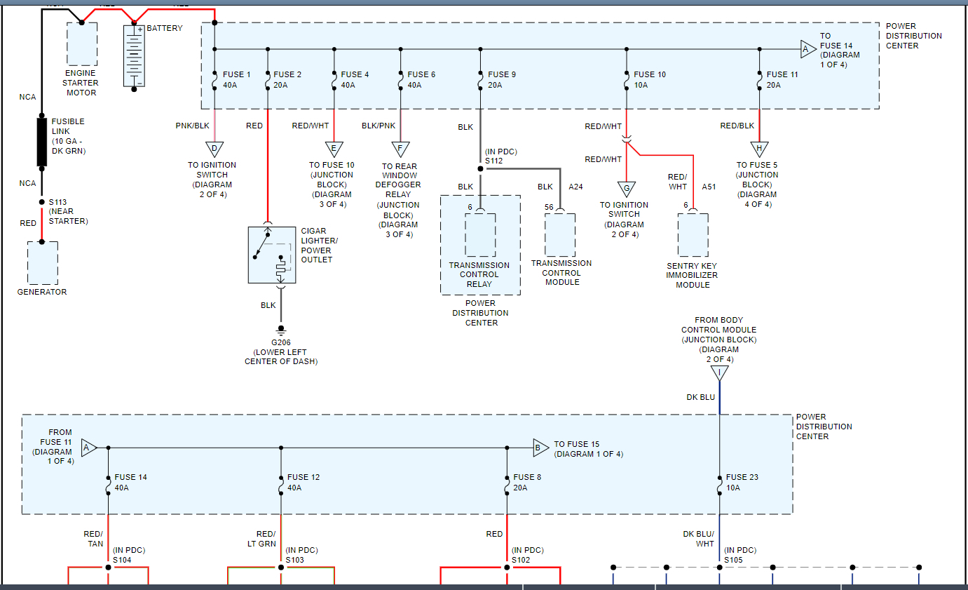

I also attached the wiring diagram of the starting system for you as well so we can test the system and find the failure.
Nov 20, 2020 at 11:06 PM
KRISB1985
It would be fuses 8,9,10,11 and 22 thru 25.
Nov 20, 2020 at 11:17 PM

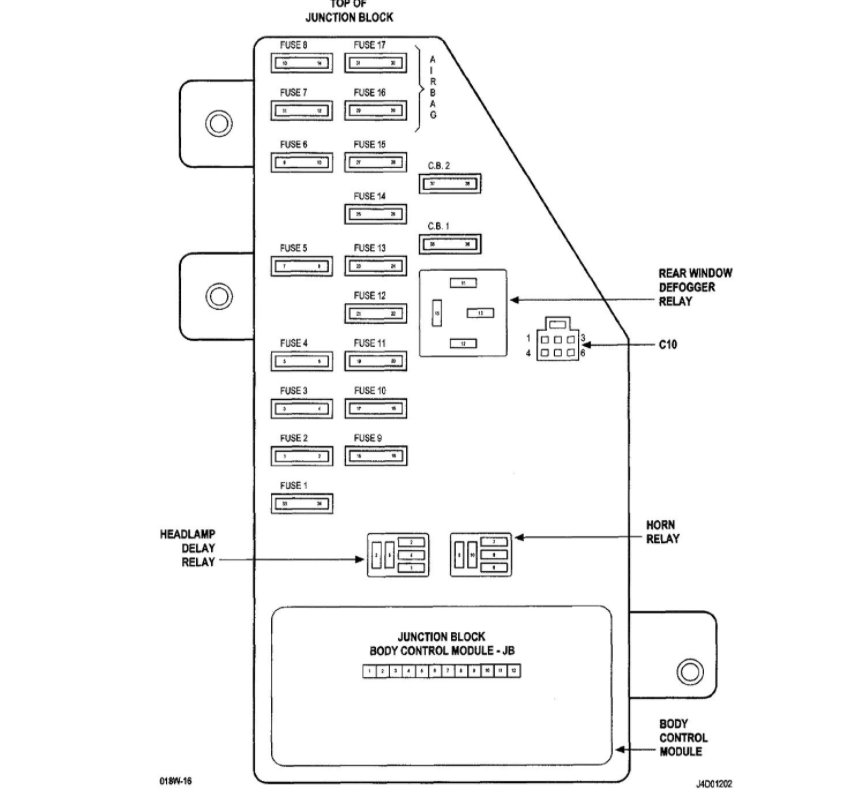

I attached the wiring for the fuses but is there power to any of the fuses in the diagrams I attached?
