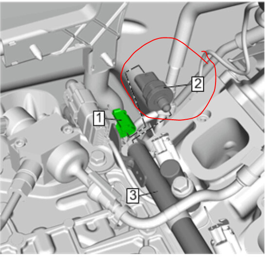

Can you tell me what sensor is on the fuel line of driver's side of cab under the foot well. All spark plugs on the truck have been changed and still the same issue.
Jun 29, 2023 at 3:07 PM
  • 110,244 POSTS
I believe you are referring to the fuel rail fuel pressure sensor. I attached a pic below. Let me know if that is what you are referring to.
Also, if that isn't correct, could you take a pic of what you are looking at and upload it for me to see? That would help.
See pic below.
Jun 29, 2023 at 3:26 PM

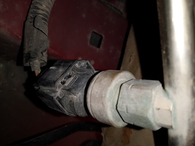

Here is that item I was talking about. It is located on the fuel line under the cab on the driver's side by the driver's door.
Jul 7, 2023 at 5:11 AM
  • 110,244 POSTS
That looks like the same part in a different location. LOL Is there a part number on it? Also, if it is a fuel line it's attached to, it should be protected on the opposite side of the frame rail.
Jul 7, 2023 at 12:08 PM
TAMMYRL
  • 18 POSTS
It also has one like in the picture you sent. The truck has a fuel pump in the tank and a high-pressure fuel pump. The picture you sent is also on the truck on the fuel rail under the hood. The one I sent you is on drivers side where I explained earlier.
Jul 7, 2023 at 3:50 PM
  • 110,244 POSTS
I went to the component locations page. There is a fuel pressure sensor near the transmission cross member under the vehicle. Does the one in your pic sit near the cross member?
See pic below.
Jul 8, 2023 at 1:33 PM
TAMMYRL
  • 18 POSTS
Yes, is there a way to test it?

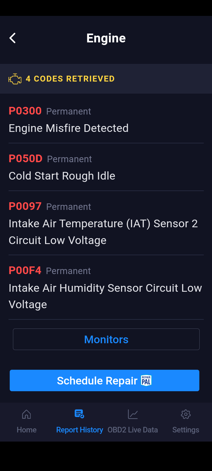

I have a long list of tests related to the fuel system. However, they are not listed by part. Instead, they are identified by diagnostic trouble code. Are any stored in the PCM?
Jul 9, 2023 at 11:44 AM
TAMMYRL
  • 18 POSTS
Here is the latest that I could get with a crank no start.
Jul 10, 2023 at 6:06 AM
  • 110,244 POSTS
Disconnect the mass air flow sensor and see if it starts. The IAT is integral.
Jul 10, 2023 at 3:15 PM
TAMMYRL
  • 18 POSTS
It is still a crank no start there is no change at all.
Jul 11, 2023 at 8:42 AM
  • 110,244 POSTS
Will it try to start with starting fluid? If it does, then we know its fuel related. If there is no change, as mentioned, it is likely ignition related.
As far as the codes are concerned, there really isn't one that would prevent starting other than the IAT. Even that would likely cause it to run poorly but run. When I asked to disconnect it, I did because it forces the PCM into a predetermined setting to allow it to run. So, I am back to narrowing it down to fuel or ignition.

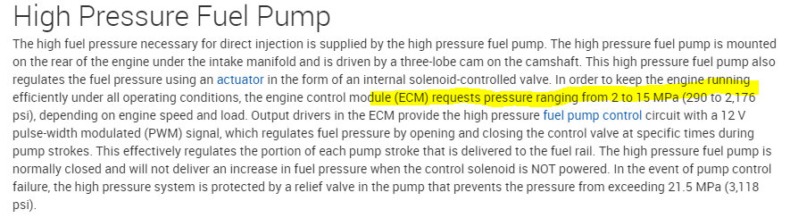

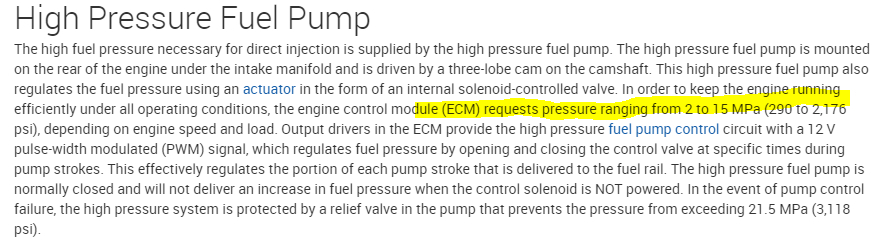

Can you test the fuel pressure in the one in the tank and not the high pressure? How much should the high pressure one put out and the low one? I might be able to test it with my digital car tester that gives me codes if I can get it to run long enough.
Jul 18, 2023 at 3:48 PM
  • 110,244 POSTS
I believe that is how the high-pressure fuel pump is checked on this vehicle, using a live data scan tool. It gets a reading via the fuel pressure sensor.
And for some reason, my manual is not providing fuel pressure specifications. It is extremely limited. I have access to another manual, but for some reason, it isn't working presently.
The only thing I was able to find was a description of the high-pressure pump. The fuel pressure specs are highlighted. See pic below
See pic below.
Jul 19, 2023 at 12:45 PM

This is where I am talking about will try to highlight toward the end the relief valve. injection is supplied by the high pressure fuel pump manifold and is driven by a three-lobe cam on the ca or in the form of an internal solenoid-controlled valve engine control module (ECM) requests pressure Output drivers in the ECM provide the high pressure n regulates fuel pressure by opening and closing the portion of each pump stroke that is delivered to t ease in fuel pressure when the control solenoid is N ed by a relief valve in the pump that prevents the pr.
Jul 19, 2023 at 1:50 PM
  • 110,244 POSTS
I believe the control valve is integral to the pump. I don't feel it is a separate unit.
