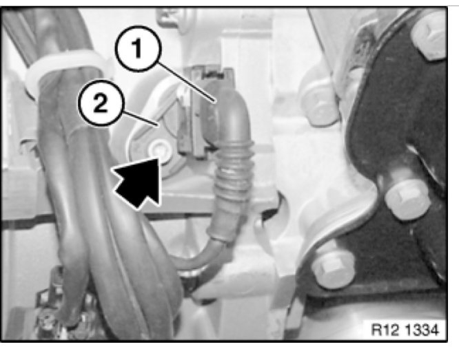

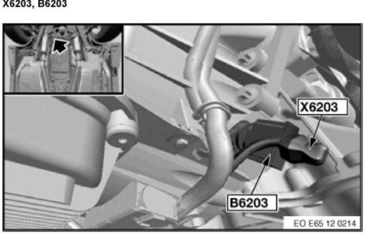

My car is the LI model. i replaced the engine but it will not turn on. it cranks but will not start. I have replaced fuel pump, fuel filter,cam sensors, crank sensor and spark plugs. I sent the DME computer to be checked and all is good. I have a Matco max me scanner and checked. No codes. But i still do not have spark on my coils. Any idea as to what i can check or what can be causing this no spark?

It sounds like you have a bad crankshaft angle sensor but to confirm please take a look at these guides to help us in the right direction.
and
and
Here are some diagram (below) that shows where it is on your car.
Please run some tests and get back to us we are interested to see what it is.
Jul 9, 2017 at 5:47 AM
JLGLZ
  • 9 POSTS
Thanks got the car to start. I used my brother's. Matco maxme scanner and reset all codes and reset all values for most valves like the intake and the throttle and. And i reset the software and esw car turned on like new . crank sensor was good all along it was just a code that it was reading from before i replaces the engine. Again Thank you very much for your help
