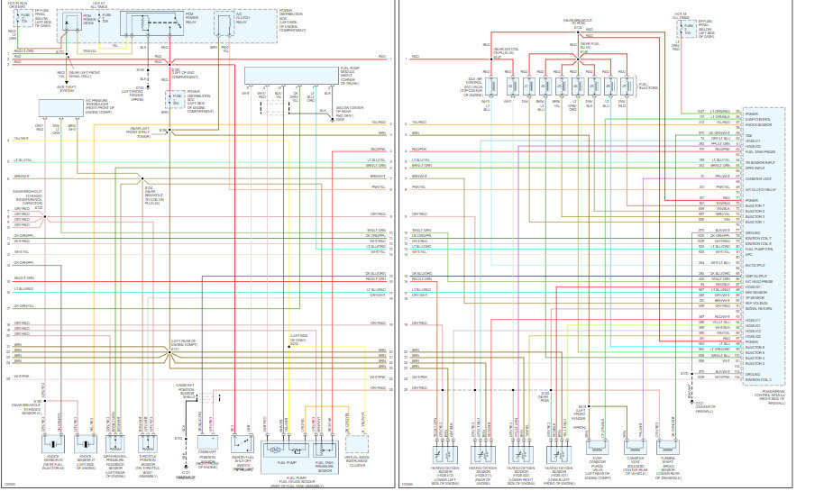

I drove the car last night parked it and this morning went to start acted like it was going to twice and then would shut off a second later. Noticed no lights on dash except for battery oil and airbag. The digital display that is normally there does not come on and which is what controls a lot of things. I have pulled every fuse out checked and replaced. security system recognizes key and will crank but no fuel in fuel rail. What would be my next step?

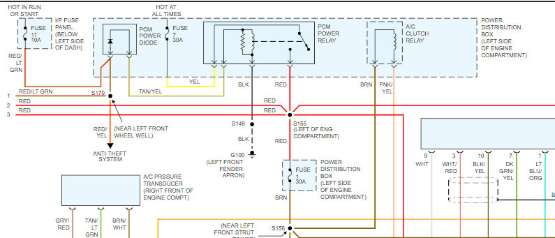

I attached a wiring diagram of the system. There is a power relay in the fuse block under the hood that provides power to all the accessories. You need to verify voltage to the relay to see if it is working.
Did you verify power to the fuel pump?

I have one in car we have tested to see if power to fuel module. Here is where i am stuck at there is a digital display that is in dash and it stopped working sane time from the wiring diagram above i see that it goes through the fuel pump module for power and its not getting it to work which is yellow/white wire so i am stuck with that it has to do with that not working cause as of right now with fuel pump kicked on will not start.

We jumped the fuel pump out so it had power and tried to start car we did not check pressure because the fuel module was not allowing the power to the fuel pump in the first place so i replaced thinking maybe it was fried and was not allowing power to get to fuel pump and now that is not the case we was thinking PCM or something along those lines cause the digital display and the module not getting power to turn pump on this weekend i am going to see if it is giving spark now because before when i tried right after this problem started it ran for couple seconds now it wont even do that. i am trying to find a diagram of everything that is tied into the fuel/display that stopped working so far all i see is that module in fuel system but has to be further tied in.

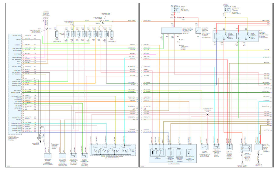

so as far as control modules what are the list of them i tried to zoom in on wiring diagram and it gets to blurry to read is there just a PCM? or is there multiple ones that control fuel and spark ?

ok so now im trying to see if the pcm has power and see what all i canfigure out. i am looking for what wires get power to pcm i looked on diagrams and i cannot see clearly enough to see what colors get the power i know it is only 5v but not sure which ones
