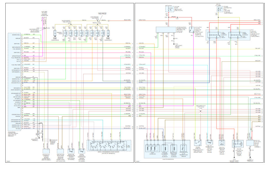

I drove the car last night parked it and this morning went to start acted like it was going to twice and then would shut off a second later. Noticed no lights on dash except for battery oil and airbag. The digital display that is normally there does not come on and which is what controls a lot of things. I have pulled every fuse out checked and replaced. security system recognizes key and will crank but no fuel in fuel rail. What would be my next step?

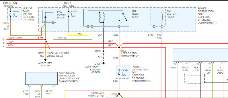

I attached a wiring diagram of the system. There is a power relay in the fuse block under the hood that provides power to all the accessories. You need to verify voltage to the relay to see if it is working.
Did you verify power to the fuel pump?

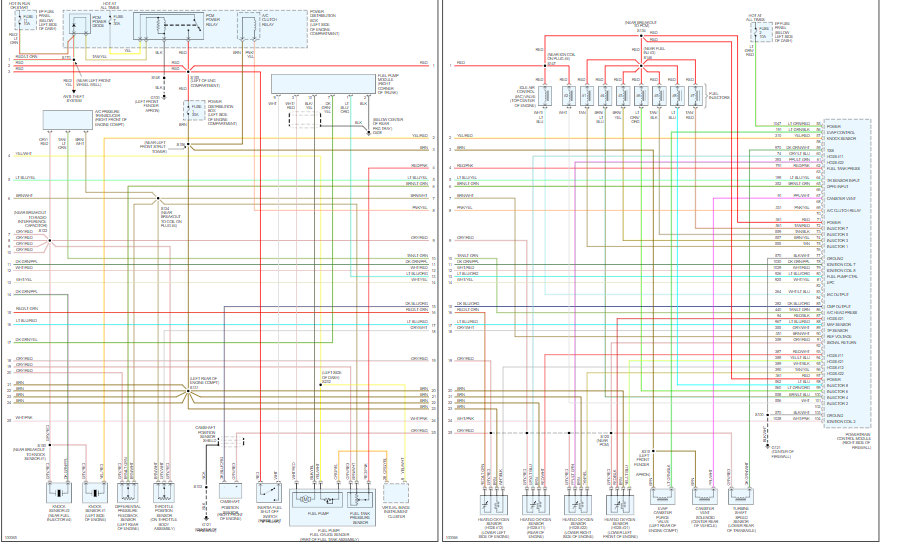

Okay, my dad pulled it apart I have power to inertia switch to fuel pump module nothing after that. it's supposed to have power to white with red and ground is black with yellow but no power there. I can't see the diagrams very well about the yellow with something that goes to fuel pump then virtual dash. is there a way to test if module is bad or if I can put power past it to see if I can get fuel pump to run so I know where to start?

I have one in car we have tested to see if power to fuel module. Here is where i am stuck at there is a digital display that is in dash and it stopped working sane time from the wiring diagram above i see that it goes through the fuel pump module for power and its not getting it to work which is yellow/white wire so i am stuck with that it has to do with that not working cause as of right now with fuel pump kicked on will not start.

so as far as control modules what are the list of them i tried to zoom in on wiring diagram and it gets to blurry to read is there just a PCM? or is there multiple ones that control fuel and spark ?

ok so now im trying to see if the pcm has power and see what all i canfigure out. i am looking for what wires get power to pcm i looked on diagrams and i cannot see clearly enough to see what colors get the power i know it is only 5v but not sure which ones
