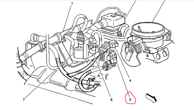

Truck started normal drove my girl friend to work about 2 miles away went to back out to leave her work and the trucked shut off. I cranked for a good minute and it started. drove 30 feet was waiting to pull out into to traffic and it shut off just cranks no fire. i have replace the crank shaft sensor and coils. it has fuel pressure and starting fluid sprayed in it and no fire.

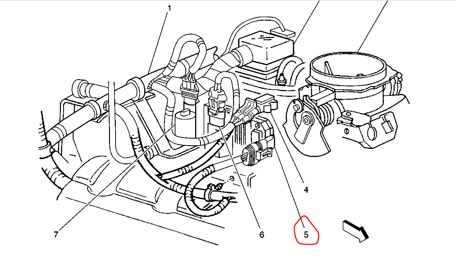

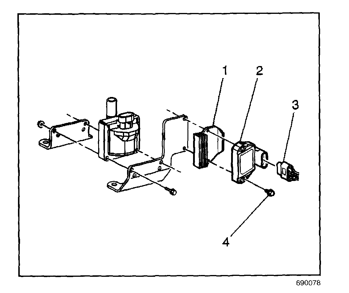

My first suspect is the ignition control module. Here are directions for replacement. The first pic below shows location. Pics 2 and 3 correlate with the directions.

pic 2
1. Remove the air cleaner outlet resonator.
2. Disconnect the ignition coil driver electrical connector (3).
3. Remove ignition control module (2) screws.
4. Remove the ignition control module (2) and heat sink (3).

pic 3
1. Position the ignition control module (2) and heat sink (3).
NOTE: Refer to Fastener Notice in Service Precautions.
2. Install ignition control module (2) screws.
Tighten
Tighten the screws to 3.5 N.m (31 lb in).
3. Connect the ignition coil driver electrical connector (3).
4. Install the air cleaner outlet resonator.
