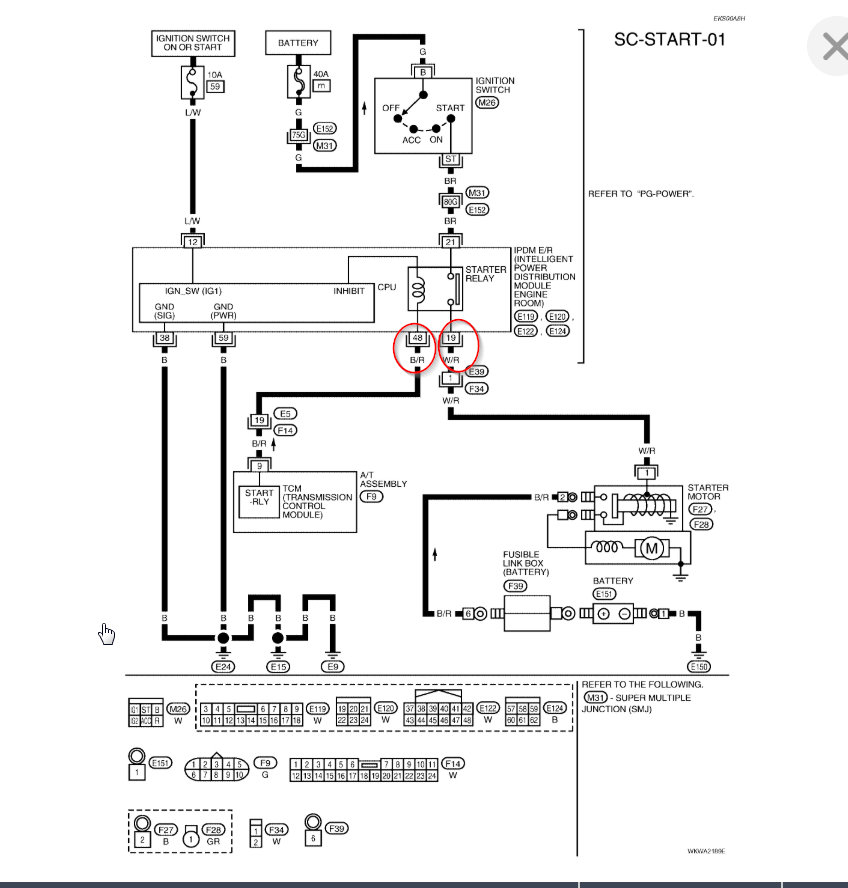

Truck wont start. Key turns and dash turns on but a further turn doesn't crank the engine. After a few reps of turning the key and leaving the dash on it finally cranks. "Service engine" light has flashed 5 times before. Starter, battery, spark plugs, oil and oil filter are all brand new. Truck has 202,011 miles. What could be the cause of this?
Apr 24, 2020 at 5:49 AM
Okay. We need to get a little more info to figure this out because it could be a number of things. First does the theft system turn off when you turn the key to the on position?
Next we need to check for codes. If the check engine light was flashing then there are most likely stored codes that will point us in the right direction.

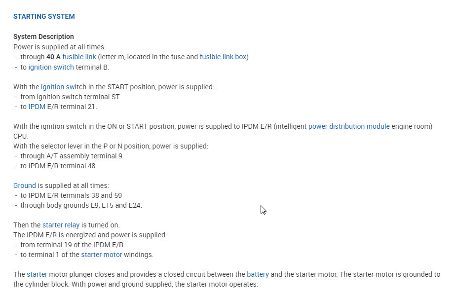

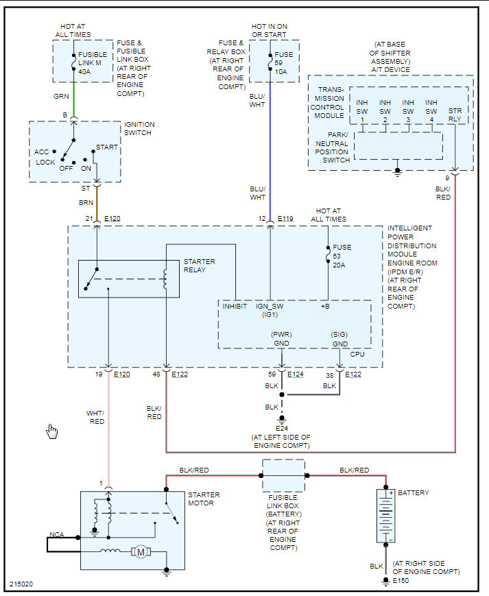

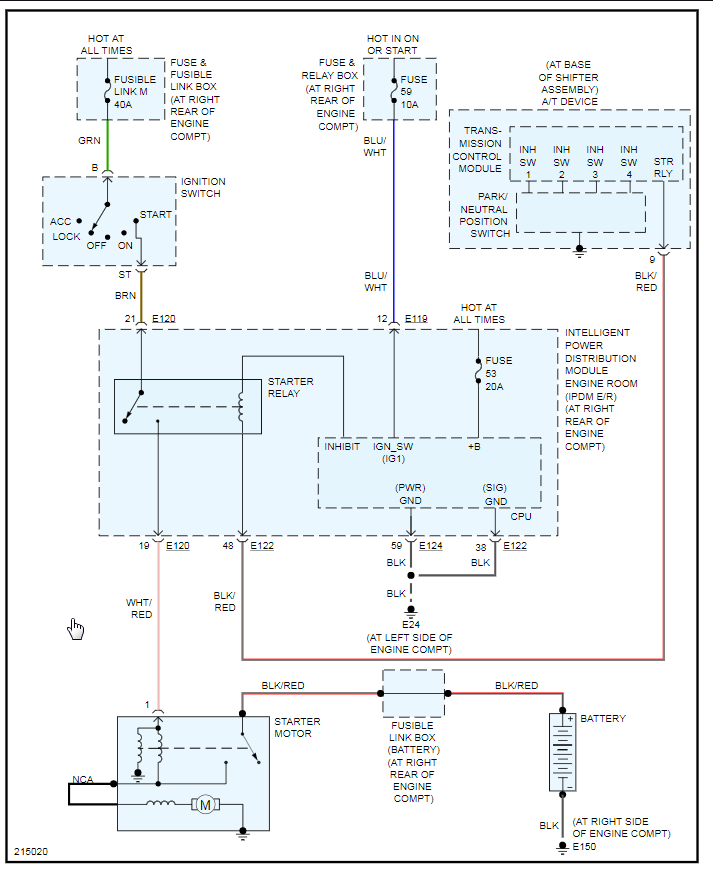

Lastly I attached the wiring diagram for us to test voltage at the starter and then depending on what we find we can go backwards in the system to find where the voltage is. As long as the theft system is not active then we have a component issue and we can find that by doing this. Hopefully there is a code that will take us right to it but if not we can still find it.
Here are some guides that will help with this info. Let me know and we can go from there. Thanks

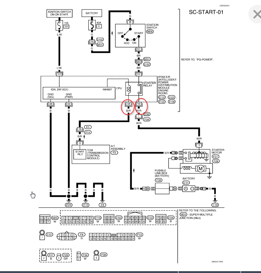

Unfortunately we need an actual scan tool that can monitor live data and not just pull codes. So we need to look at the PCM data for the ignition switch and as you turn the key it should correlate with what position the key it in. I suspect that the PCM will not see it go to the crank position which means the ignition switch is most likely faulty. However, we can try to find this by checking voltage at a couple of locations that I circled in the wiring diagram attached. If you have voltage at both these locations then the ignition switch is not the issue.
