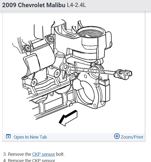

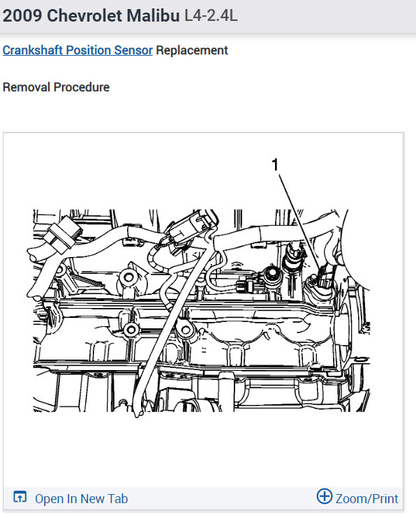

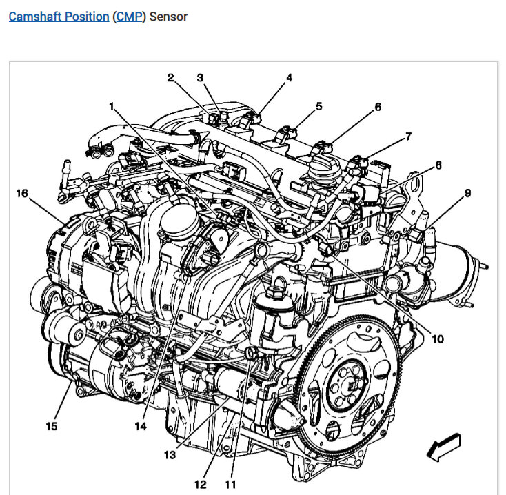

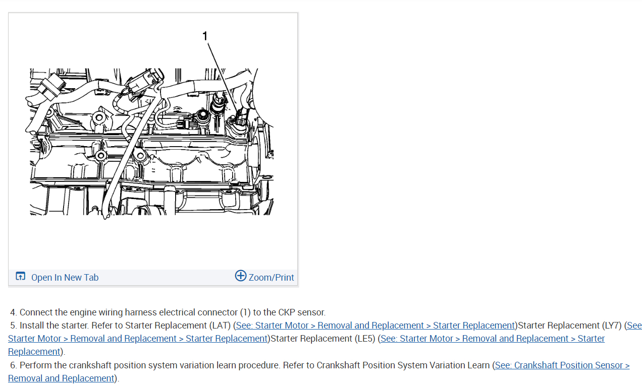

Where is the crankshaft and camshaft position sensor located?

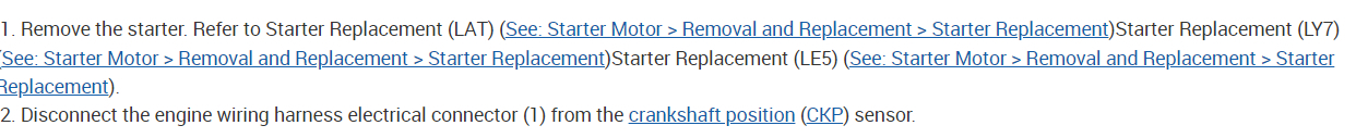

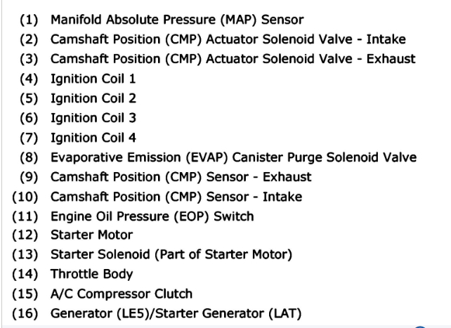

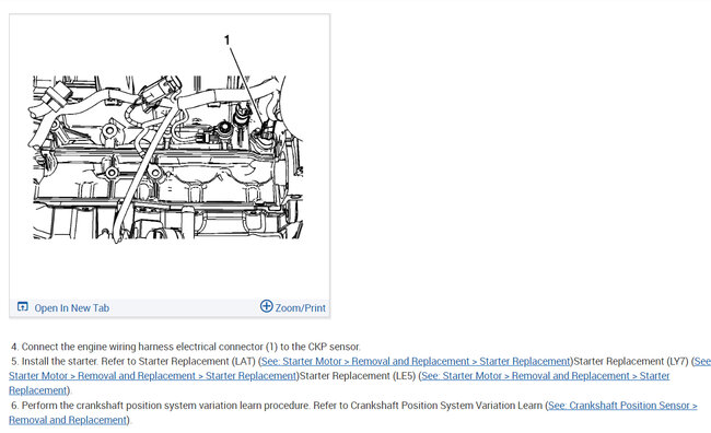

Crankshaft sensor is on the left side of the engine toward the bottom rear right above the starter motor. Camshaft sensors are on the top front of the engine. One on each side. Please check the images below.
