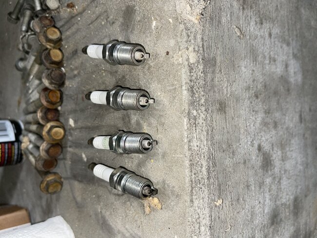

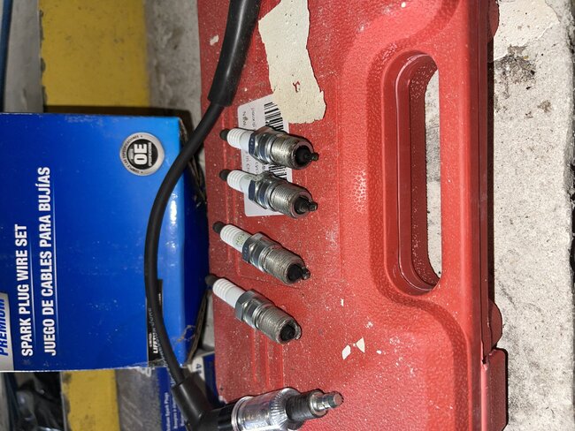

Here are pictures of spark plugs red background is passenger. Concrete is driver side
Here are compressions
1- 90 oil. 130. 100
3- 105 oil 120 120
5- 50 oil. 60 60
7- 140
2- 140
4- 150
6- 140
8- 150
Sep 9, 2025 at 7:37 AM
  • 55,848 POSTS
So when you had the head off did you see any damage in the cylinder walls? You still have low compression, IT should still run and if you replace the spark plug it should start, 4 of the spark plugs are carbon fouled and will not work. Can I ask if the truck still has catalytic converters on it? If so the one on the passenger side might be clogged.

Also, those plugs were brand new

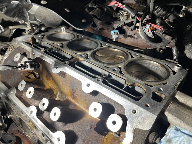

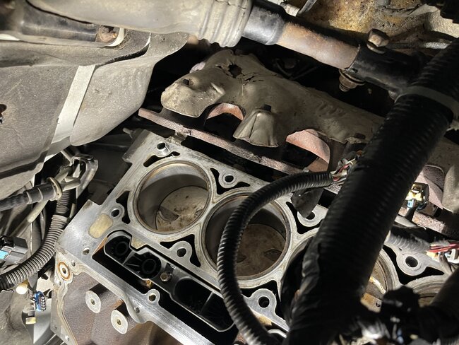

Pics before putting heads back on
Sep 9, 2025 at 11:21 PM
  • 55,848 POSTS
The pistons look okay, if your torqued the rockers they should be okay. I would not remove the cats but you can loosen the flange bolts to allow the exhaust to breath. I know the spark plugs are new but the one that are black or not working (carbon fouled). But none of this would cause low compression so that is our main concern. Lets try this, remove the valve covers and have a helper crank the engine over so you can watch the rocker arm movement. Is there a chance the bottom end is broken like a crankshaft failure? Do all off the pistons go up and down?
