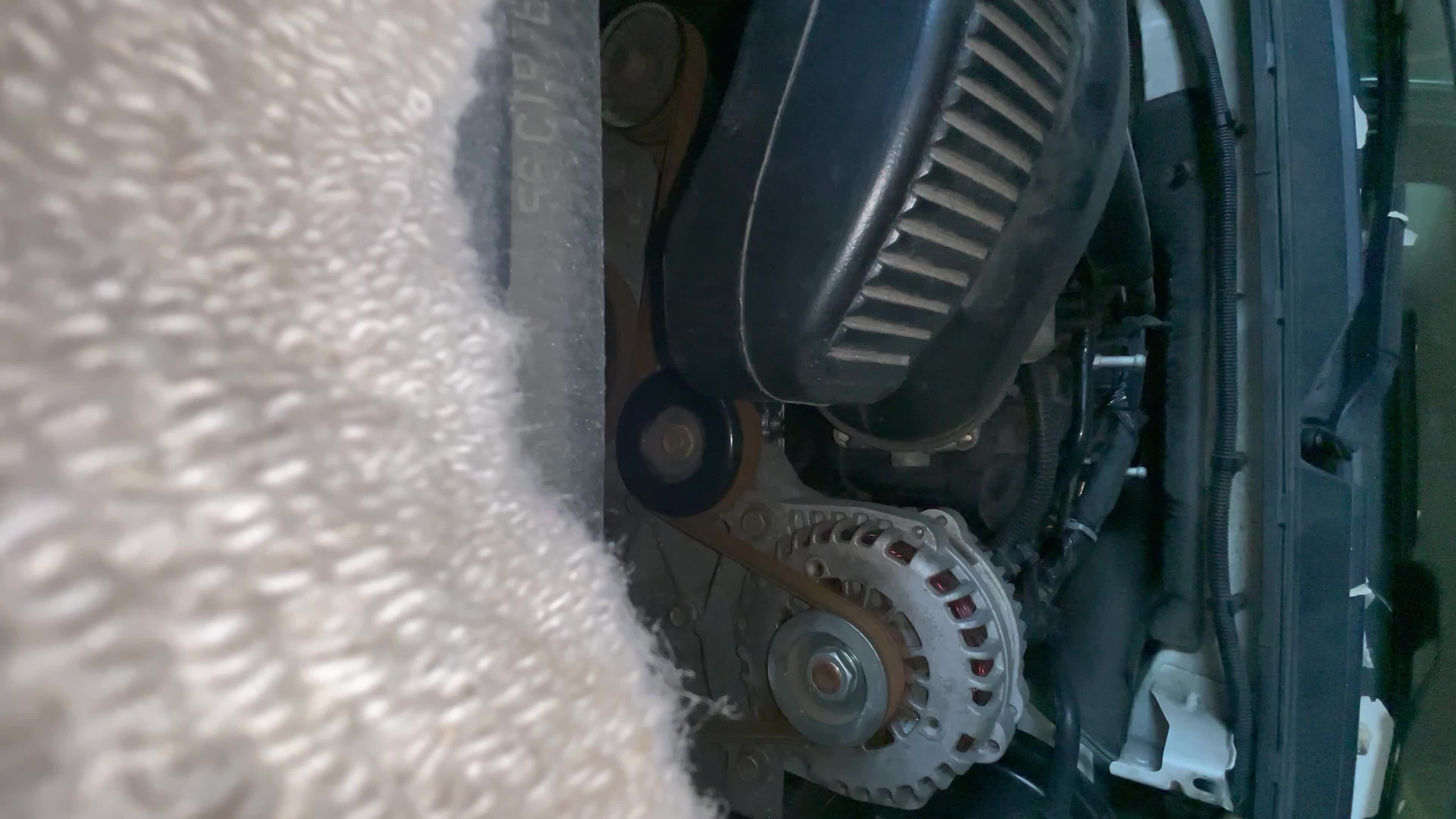

I removed the passenger side o2 sensor upstream of the catalytic converter and the engine didn’t start or sound any different. I do hear a ticking noise after trying to start the engine. Video of that attached plus a video of it cranking today. It almost starts. I’ll do the compression tests today and report back.

Video of crank today
Sep 9, 2025 at 12:48 AM
  • 55,423 POSTS
Yep, still the engine is cranking like it has no or low compression, I would rent the gauge from the Autozone for free and do the test. Thanks for the video it helps.

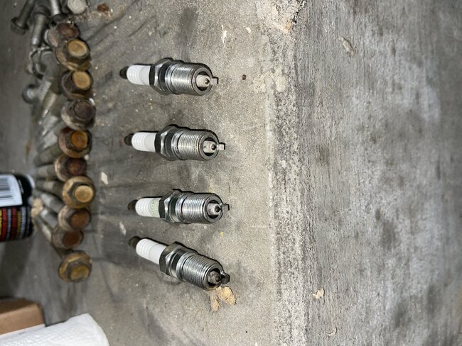

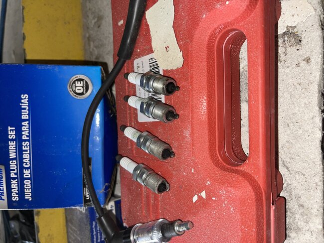

Here are pictures of spark plugs red background is passenger. Concrete is driver side
Here are compressions
1- 90 oil. 130. 100
3- 105 oil 120 120
5- 50 oil. 60 60
7- 140
2- 140
4- 150
6- 140
8- 150
Sep 9, 2025 at 7:37 AM
  • 55,423 POSTS
So when you had the head off did you see any damage in the cylinder walls? You still have low compression, IT should still run and if you replace the spark plug it should start, 4 of the spark plugs are carbon fouled and will not work. Can I ask if the truck still has catalytic converters on it? If so the one on the passenger side might be clogged.

Also, those plugs were brand new

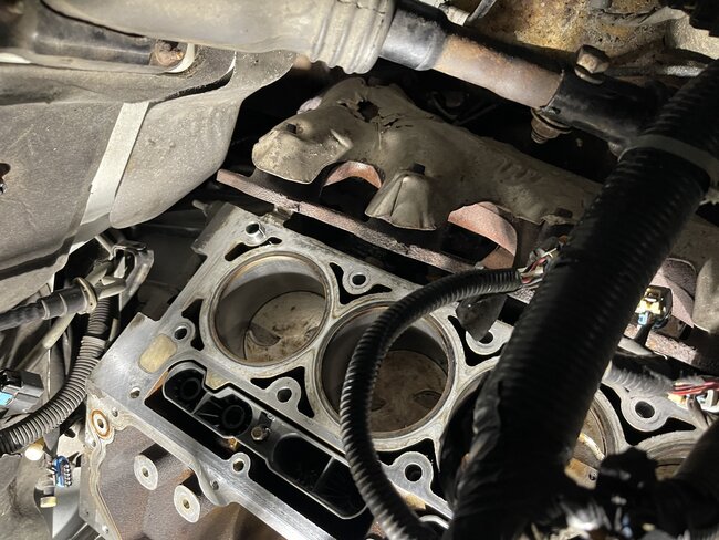

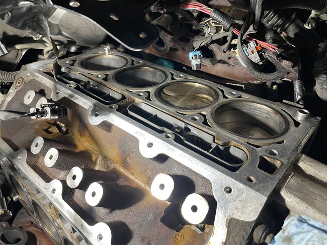

Pics before putting heads back on
Sep 9, 2025 at 11:21 PM
  • 55,423 POSTS
The pistons look okay, if your torqued the rockers they should be okay. I would not remove the cats but you can loosen the flange bolts to allow the exhaust to breath. I know the spark plugs are new but the one that are black or not working (carbon fouled). But none of this would cause low compression so that is our main concern. Lets try this, remove the valve covers and have a helper crank the engine over so you can watch the rocker arm movement. Is there a chance the bottom end is broken like a crankshaft failure? Do all off the pistons go up and down?

I’ve changed the spark plugs, what would cause them to foul up so bad without it even running?

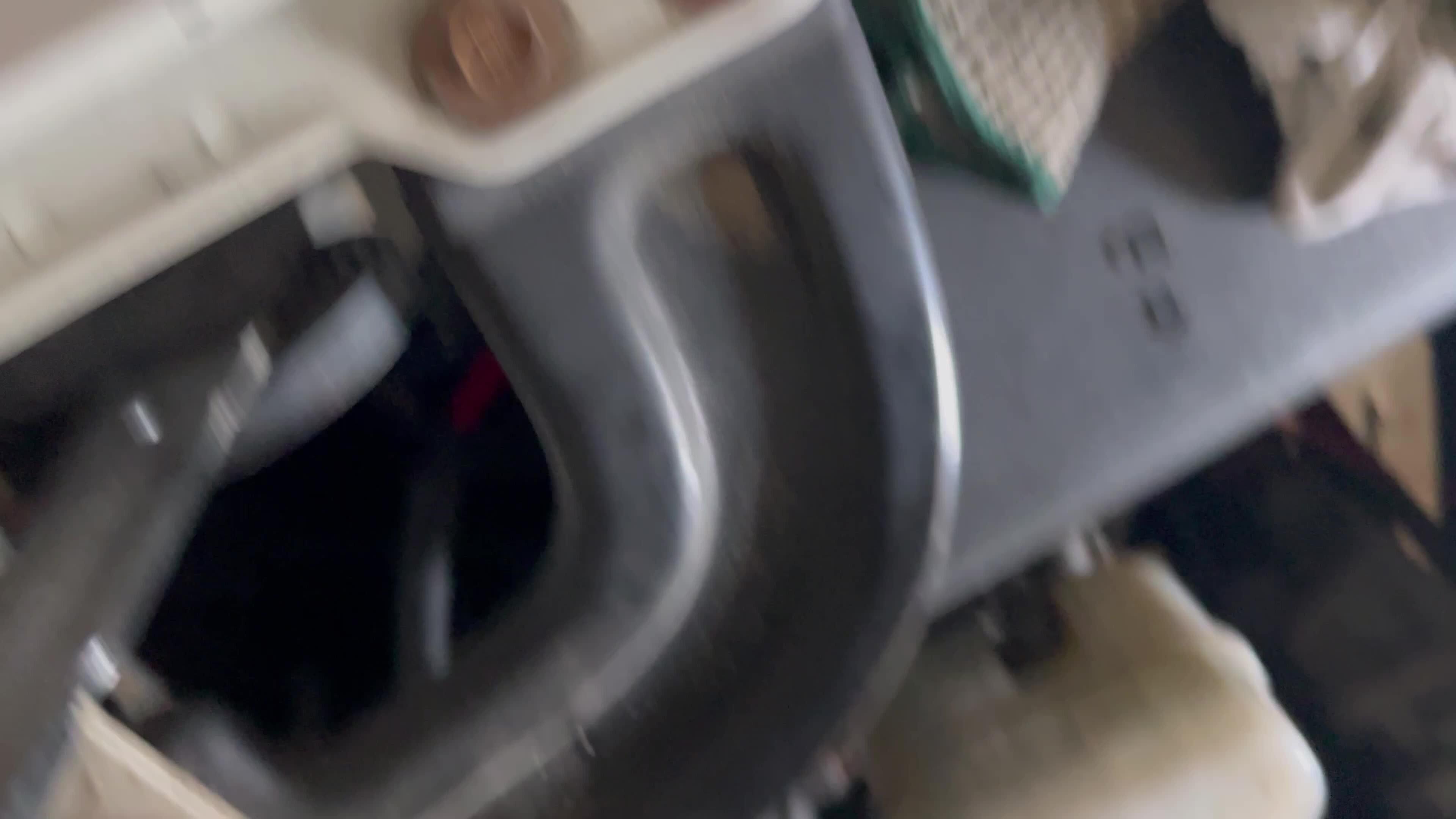

This was when I tried to start it. Of note is it still kept cranking for a second or two after I released the key. Almost started. What’s next, take lifter covers off and check for all valves moving?
Sep 10, 2025 at 10:31 PM
  • 55,423 POSTS
Yep, you can tell you still have cylinders with no/low compression. I would remove the valve cover on the side with the compression issue to see if the rockers to see if on the compression stroke the rockers are holding the valves open, if so the valve job was not done correctly and the valve height is incorrect.
