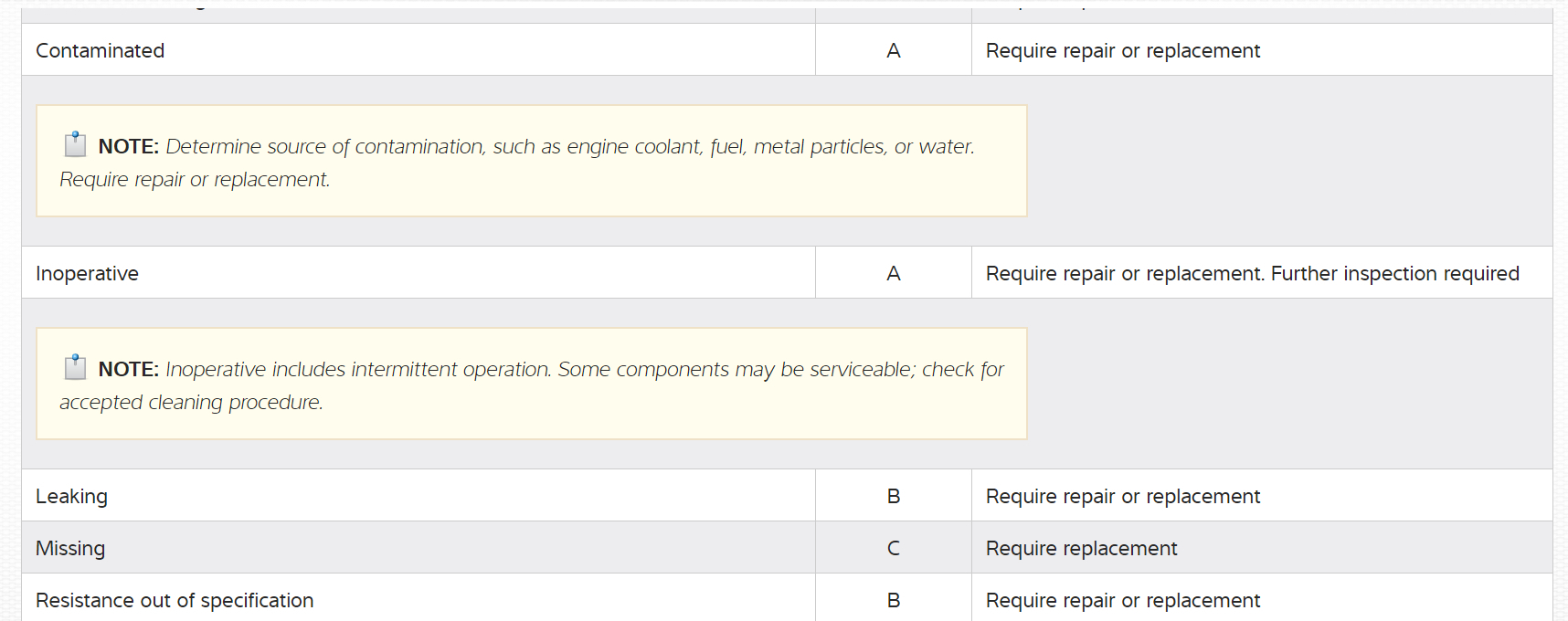

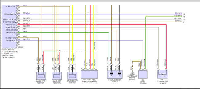

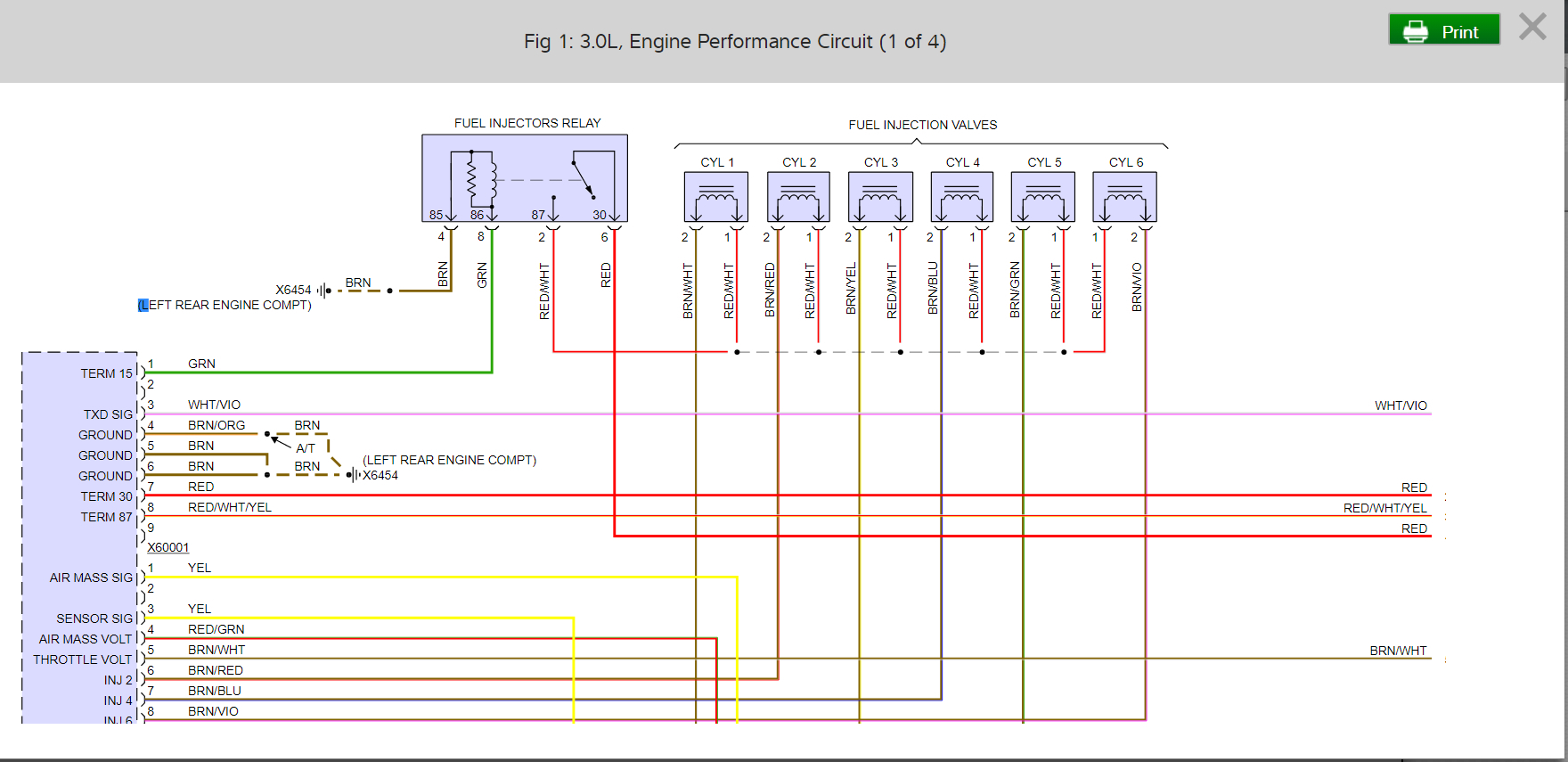

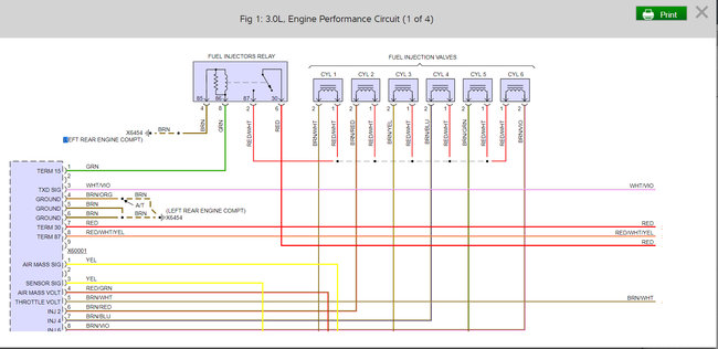

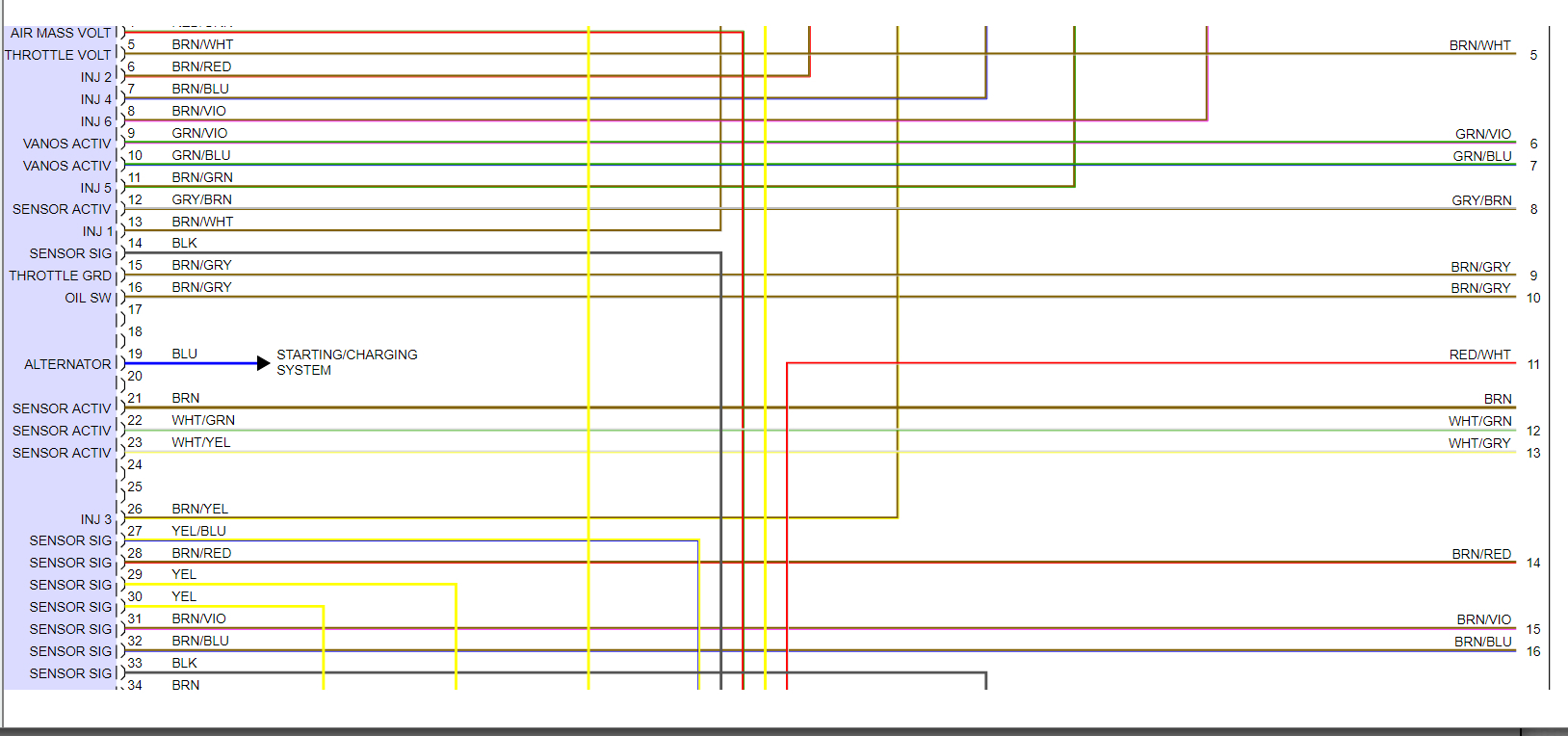

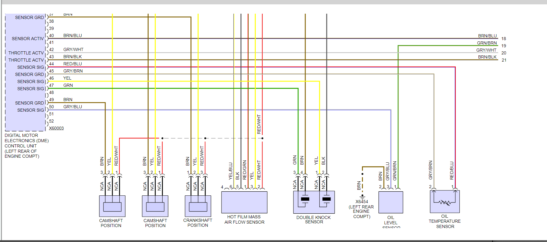

I tried to crank but won't start, it turns over but will not start. I changed fuel pump, and relay.
Saturday, March 9th, 2019 AT 5:52 PM
SCGRANTURISMO
MECHANIC
4,897 POSTS

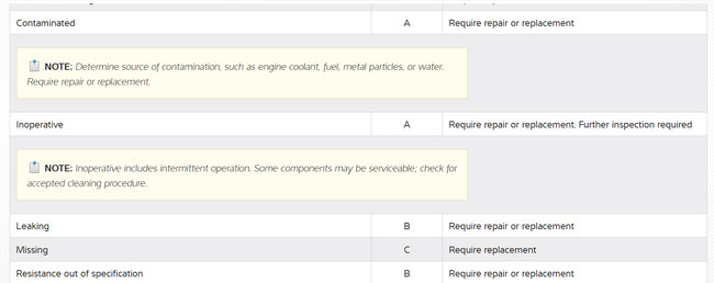

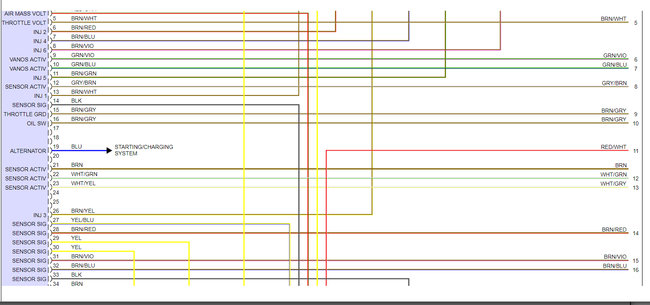

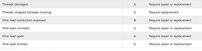

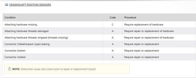

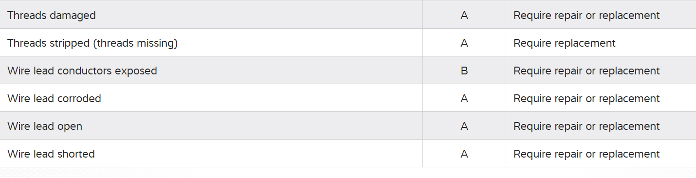

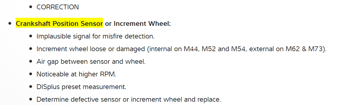

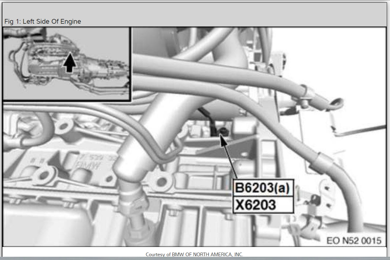

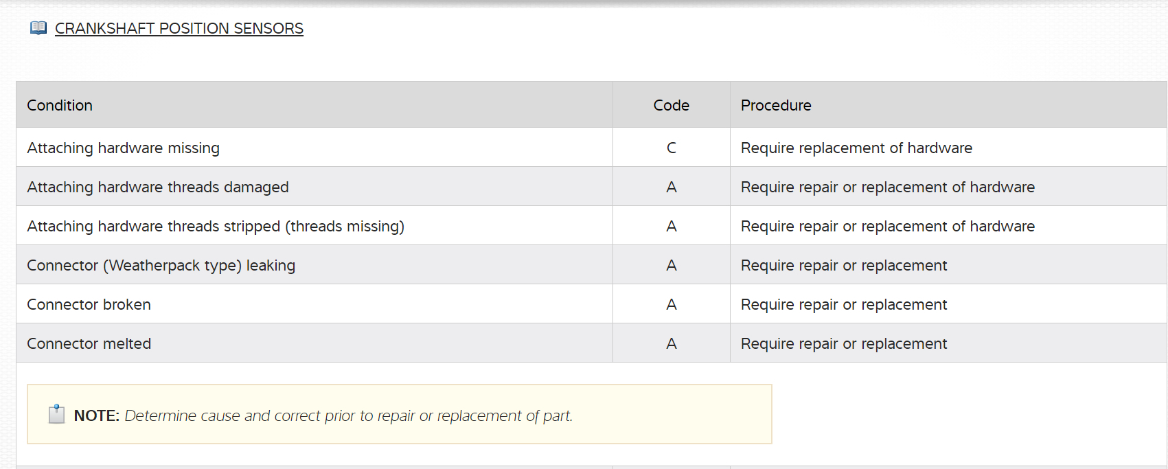

This could be a problem with your Crankshaft Position Sensor (CKP). I have included a few links for you to go to down below.
https://www.2carpros.com/articles/how-a-crank-shaft-angle-sensor-works
They are guides on what it is, what goes wrong, and how to replace it. I have also included some vehicle specific stuff for you in the diagrams below. Please go through all of it and get back to us with what you find out.
