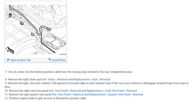

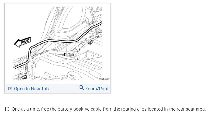

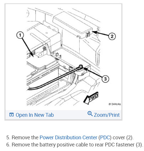

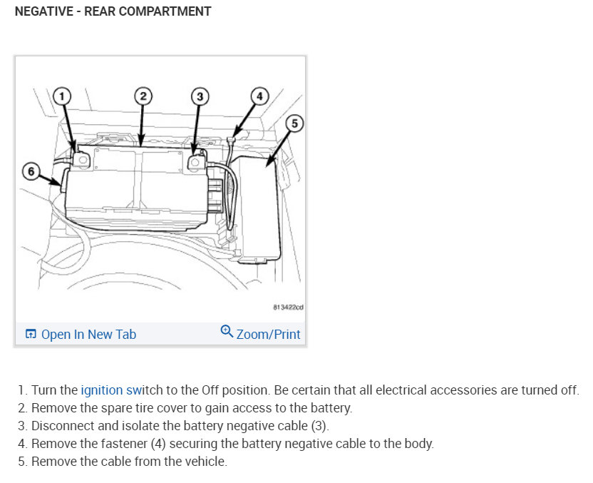

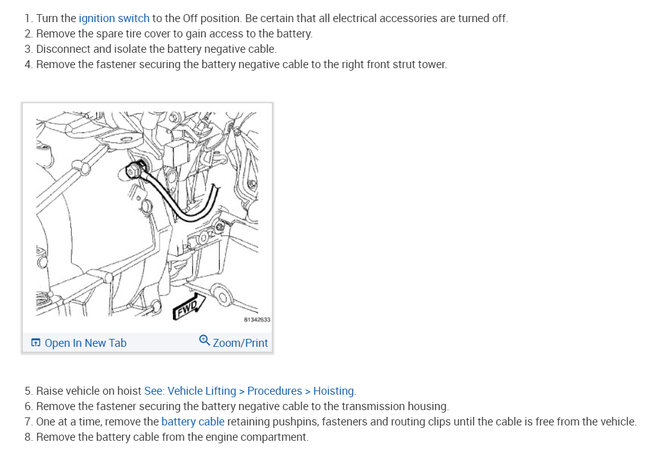

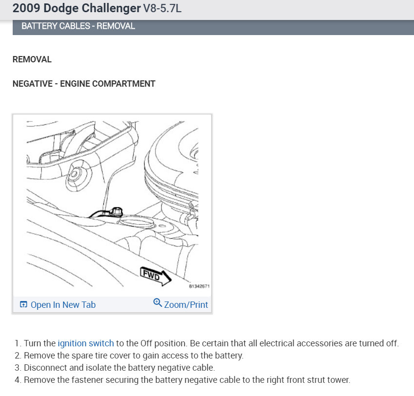

It sounds like the battery ground cable wire from the battery to the frame or engine is loose/missing/corroded. Here are diagrams to help us check things out. I would replace the battery as well. Check out the diagrams (below). Please let us know what you find. We are interested to see what it is.
