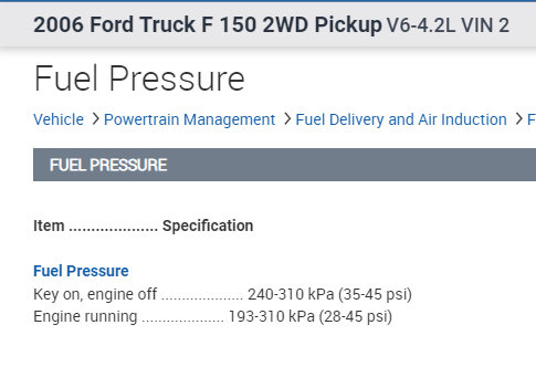

Next, based on your description, it sounds like you may have lost fuel pressure. I would suggest checking the pressure to make sure it is within the manufacturer's fuel pressure specifications.
Here is a link that explains how it's done:
You will need a fuel pressure gauge to do this, but if you don't have one, most parts stores will lend one to you. If you look below, I attached the pressure specifications.
joe
See pic below.
