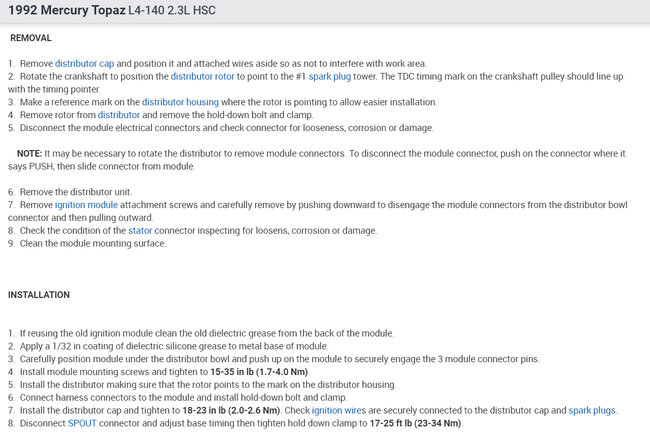

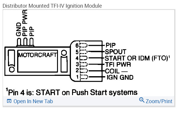

No check engine light shut off while driving. Battery and connections are good, tested power to the coil that's good. Getting no spark from the coil. Replaced the coil but still no spark. I think it's the ignition control module issue, but I need a second opinion.

Yep, these cars had the thin film ignition module which had problem, here is how to change it out which should solve the problem. Please check out this guide as well:
https://www.2carpros.com/articles/engine-stalls
Check out the images (below). Please let us know how it goes
