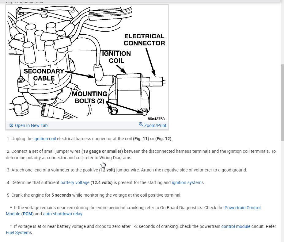

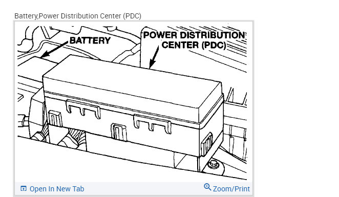

i have a no start problem. all sensors are new, ASD is functioning fine. no spark and no injector pulse. all fuses are good and i have full power at the pdb.

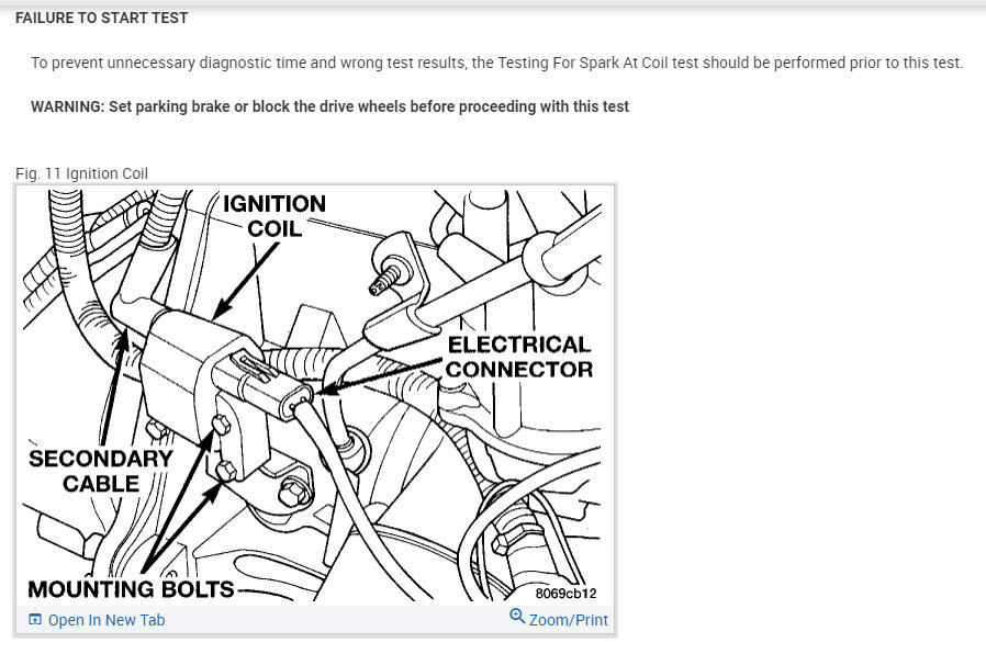

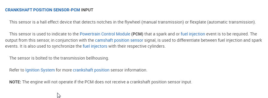

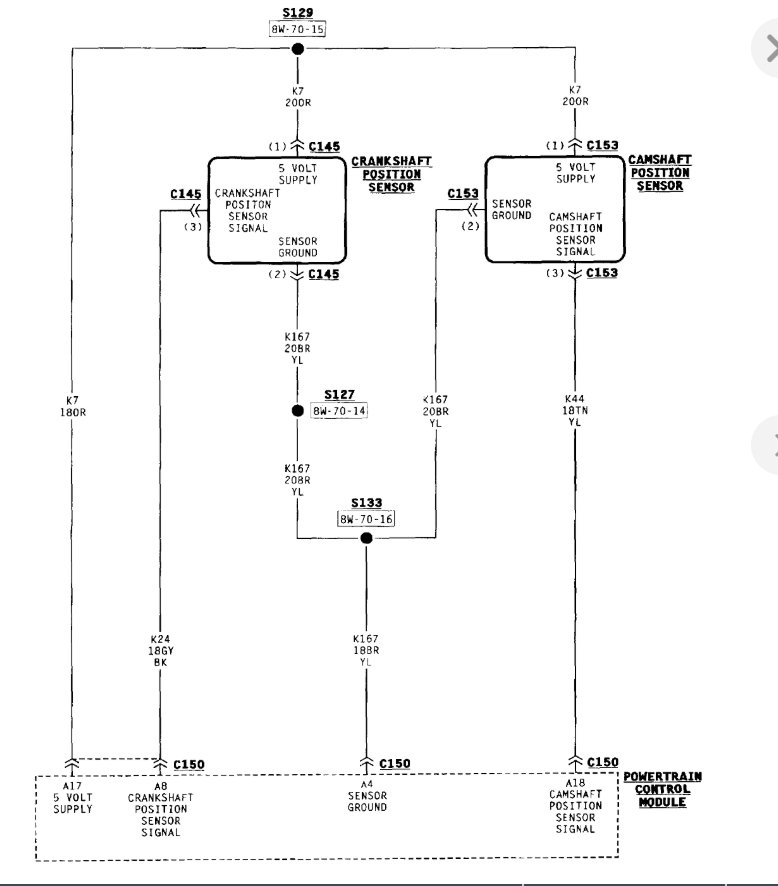

Have you check for a crankshaft sensor signal? The PCM uses the crank to determine spark and fuel timing.

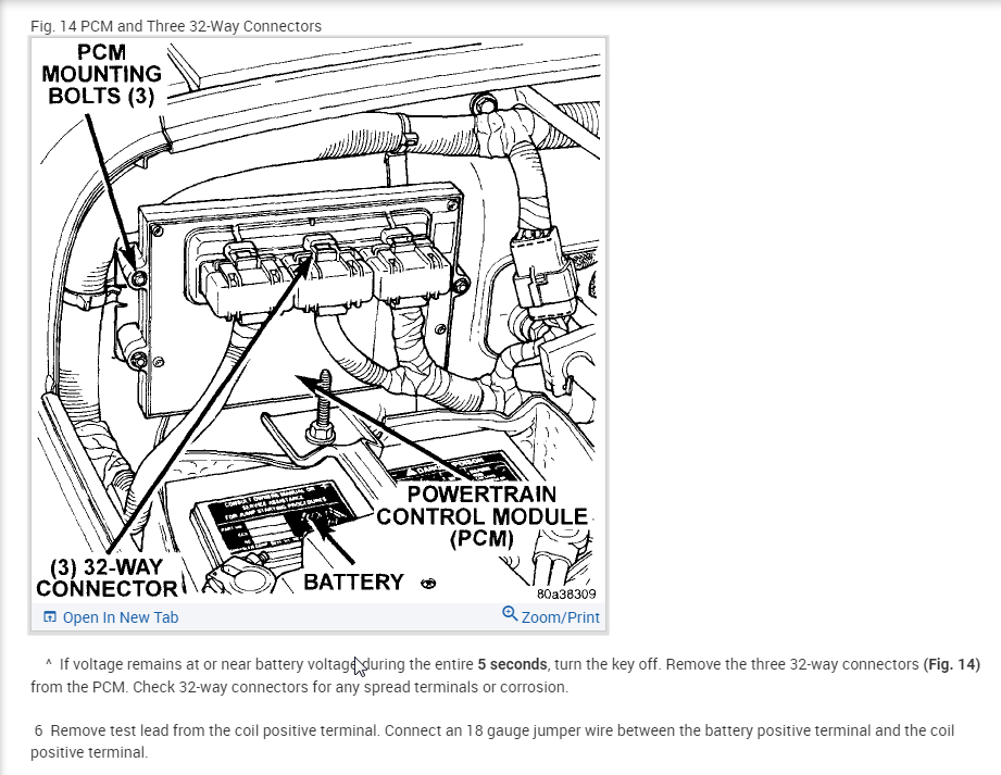

I included a test for no starts but i would just jump to the PCM and see if the crank has a signal. It would be great to see a lab scope pattern of it but since you don't have spark or fuel, I imagine the crank sensor is the issue.

yes, i replaced the engine and all sensors are new i even warrantied them out and replaced them again. all gauges work, tachometer does not bounce when cranking. ASD clicks on. all pin checks are good. i am about to ripe apart harness to see if i have a broken wire, but this thing has me very flustered.

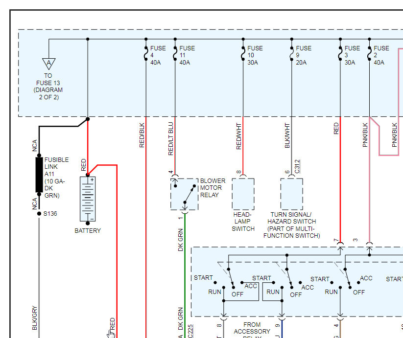

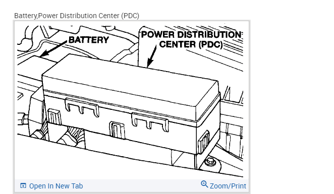

also, i can't remember if i should have constant power at pdb under hood with key off because currently i do.
Sep 24, 2020 at 11:18 AM
Are you referring to the Power Distribution Center (PDC)? And when you say constant power, you mean on the feed wire from the battery? If so, then yes. This is normal.

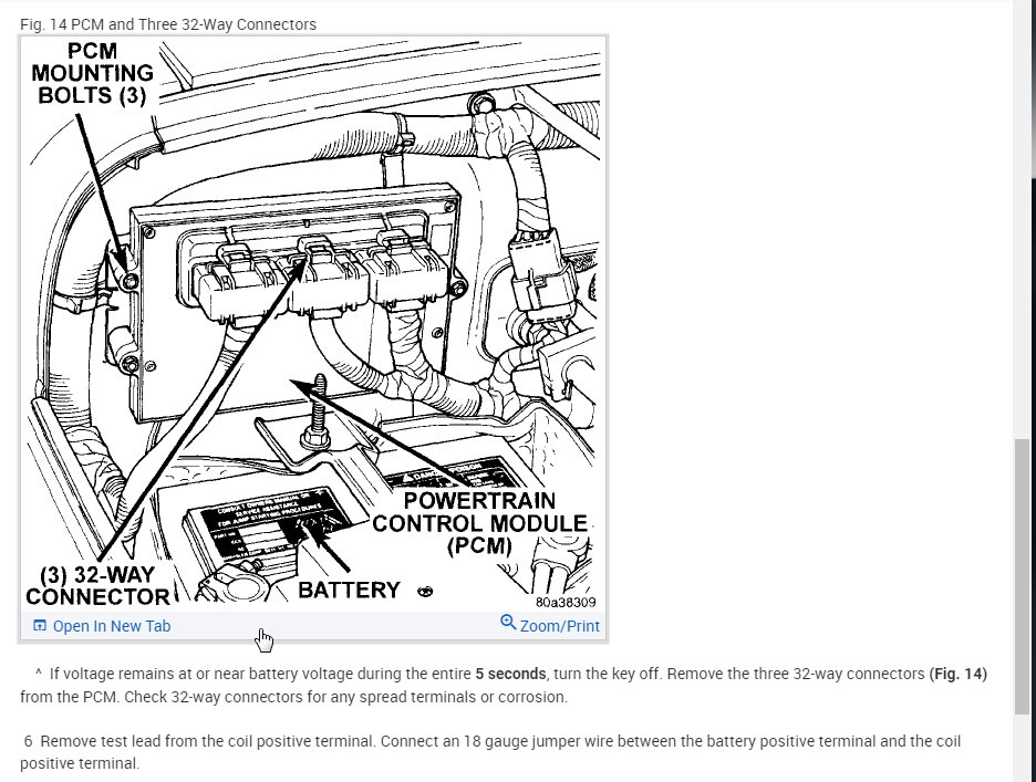

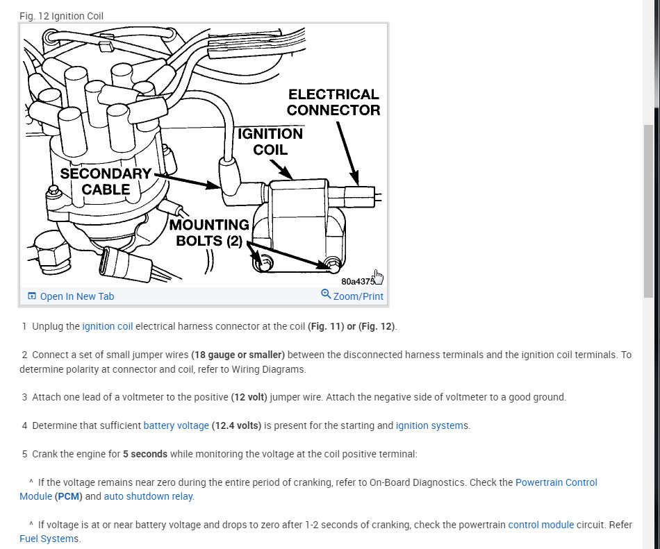

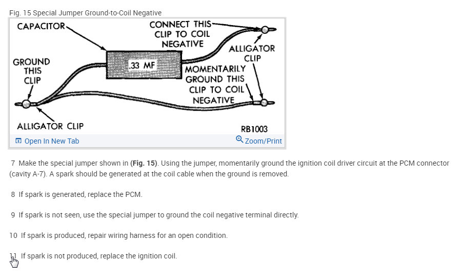

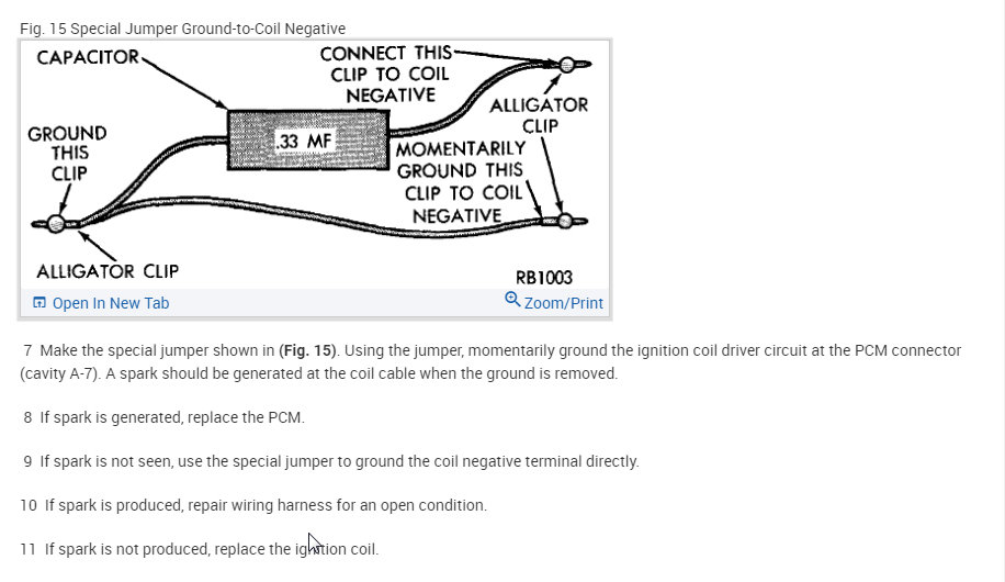

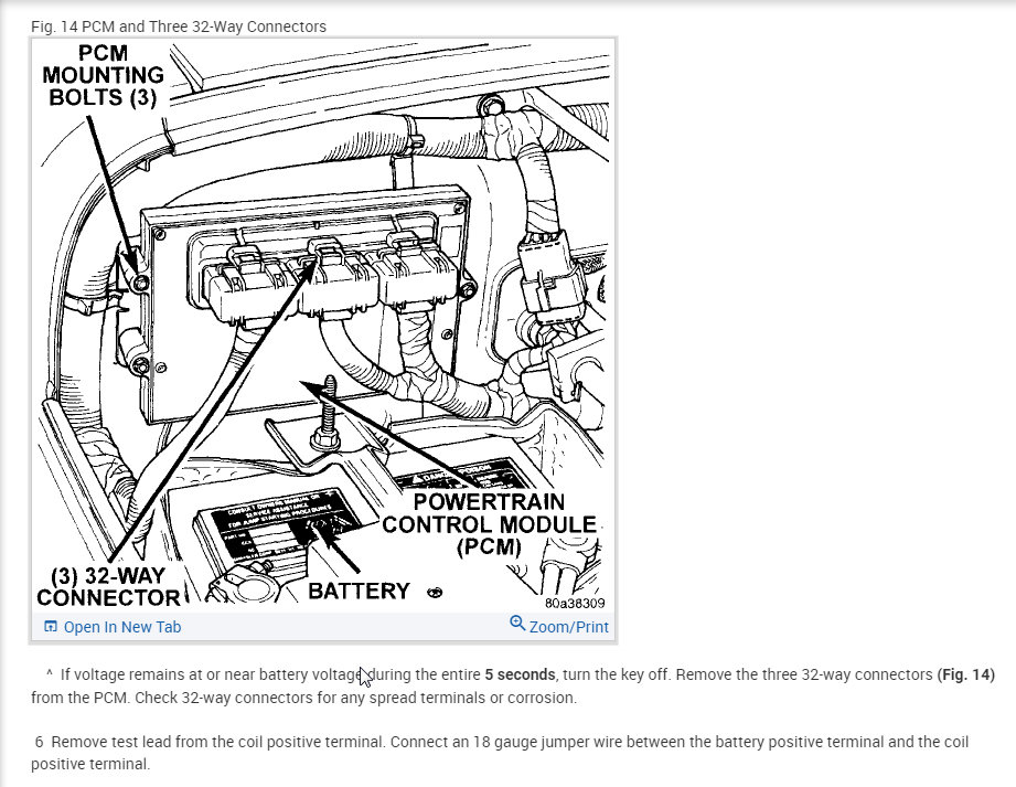

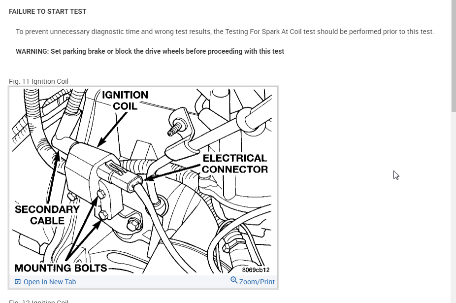

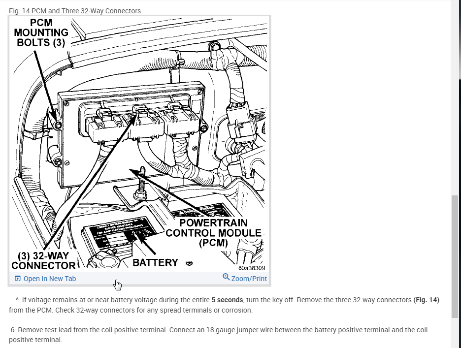

Okay. I suspect the PCM is the issue if you have no spark or fuel and it is getting a crank signal.

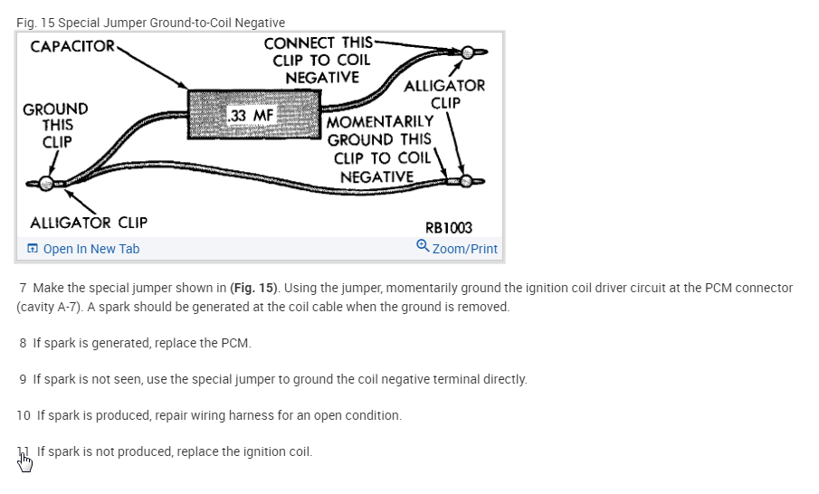

Run through this test or just jump to step 7 and run that jumper and see if you get spark. If you do then you need a PCM and that may fix both issues.
