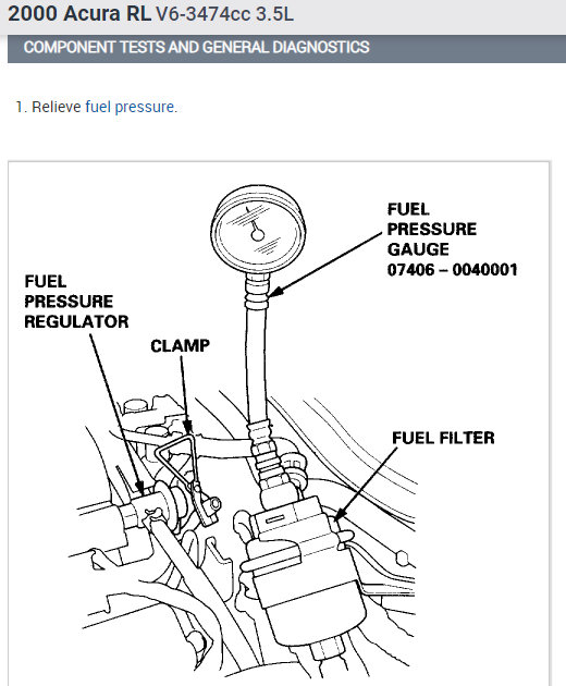

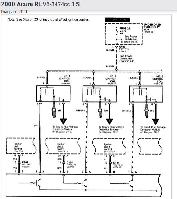

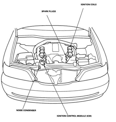

i have been able to rule out fuel pump plenty of gas coming through the fuel line when i try to start it.i have also been able to rule out my PGM relay because i replaced with another relay from another Acura that was running just fine.the only thing left is spark.i cannot see spark after a few tests.what could cause this?
I don't know what else i'm missing to test.
could camshaft sensor cause this?
please help.
Jul 18, 2021 at 11:56 AM
SQM
  • 6,383 POSTS

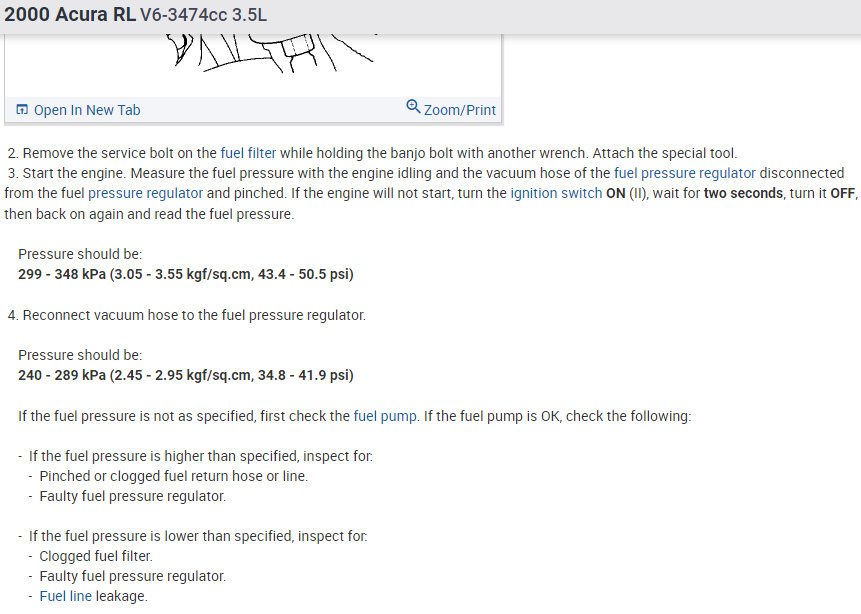

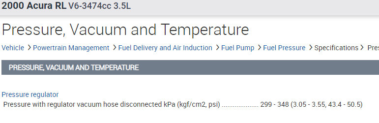

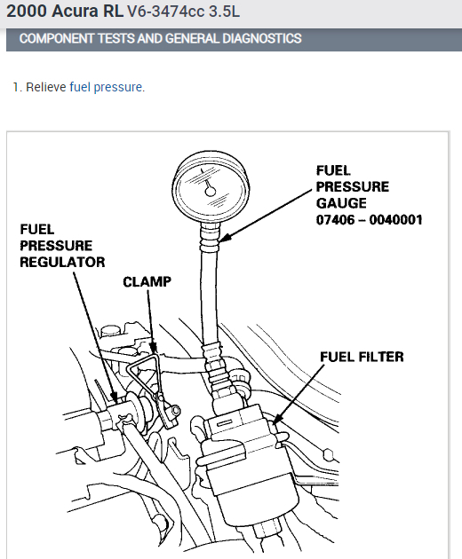

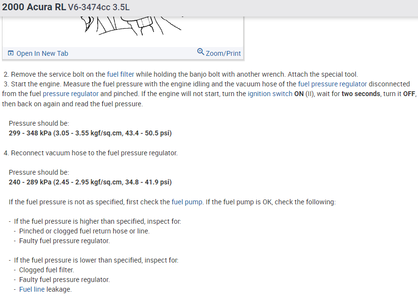

Have you got a chance to check the pressure of the fuel at the rail?
The ideal pressure should be 43.4-50.5 PSI with regulator vacuum hose disconnected.
Is your service engine light on? If so what is the code(s)?

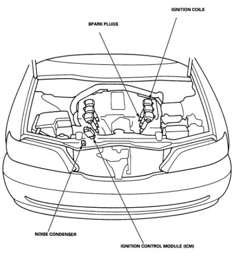

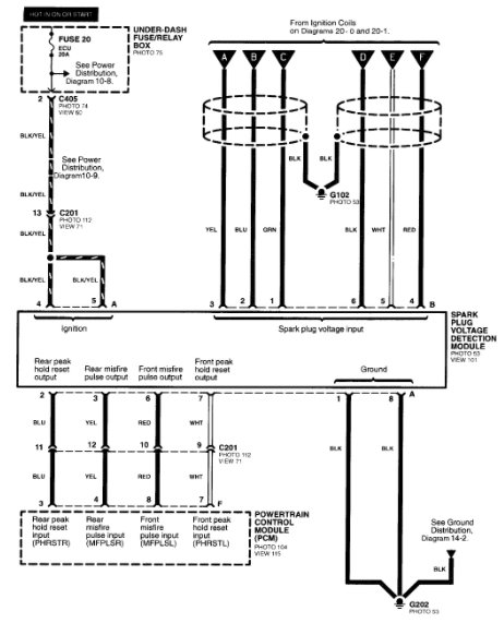

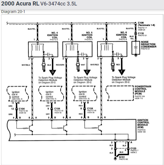

You also could have a faulty crank position sensor. Or even a ignition control module.
Let me know of any questions.

thanks for your help.i got a fuel gauge to measure fuel pressure.i cannot retrieve computer codes because the car has not been running for awhile.but will try your recommended tips.
