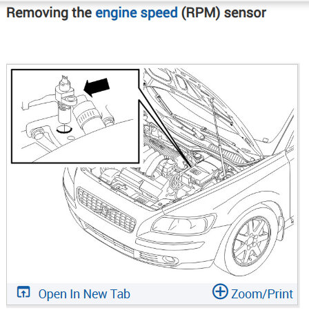

Injectors dont seem to be firing
Sep 17, 2026 at 12:31 AM
  • 55,845 POSTS
Okay, if the crankshaft sensor is not working you will have no spark or injector pulse. Here is a video to help and the location of the sensor so you can check it out.
https://www.youtube.com/watch?v=lXLJbuAZ4CE
They call it an RPM sensor FYI. Please let me know.
