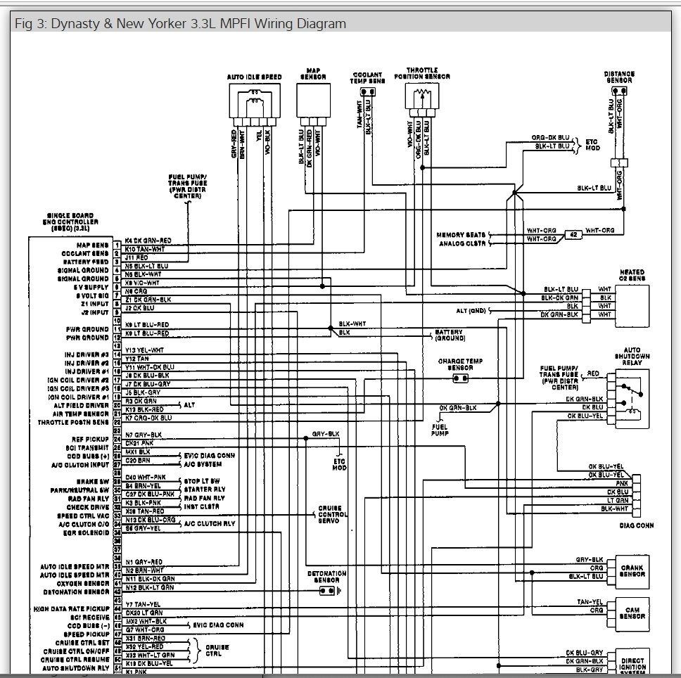

After a total engine rebuild I found the timing was off, I corrected it. It would back fire. I rechecked the timing again. I changed it 180. Now it cranks but "has lost spark. Both cam and crank sensors have been replaced, as well as the engine computer "new" and a new coil pack. All of the wires have been checked for breaks or opens, all good. I replaced the fuel relay which also is the ASD relay. At this point it cranks but still has no spark.
After finding an article saying it is in "theft mode". It said to lock the doors then unlock with key and try. It tried to fire on one cylinder. Retried, Did a little more then nothing. It also said if I changed the engine computer it is a must that I change the body computer too "or" one will teach the other and think it has an anti-theft system which it do not have. I have not found the body computer as of yet. The Haynes book is no help.
It is getting good fuel and when I removed the plugs there was evidence that plugs have fired, but not all the time. This car is notorious for flooding, so I pulled plugs and wait before trying again. It has not tried to fire in the last dozen times tried.
The last suggestion was to check for a blockage in the return fuel line, have not got that far as of yet.
Even Chrysler has been no help. They do not even know where some of the parts are located.

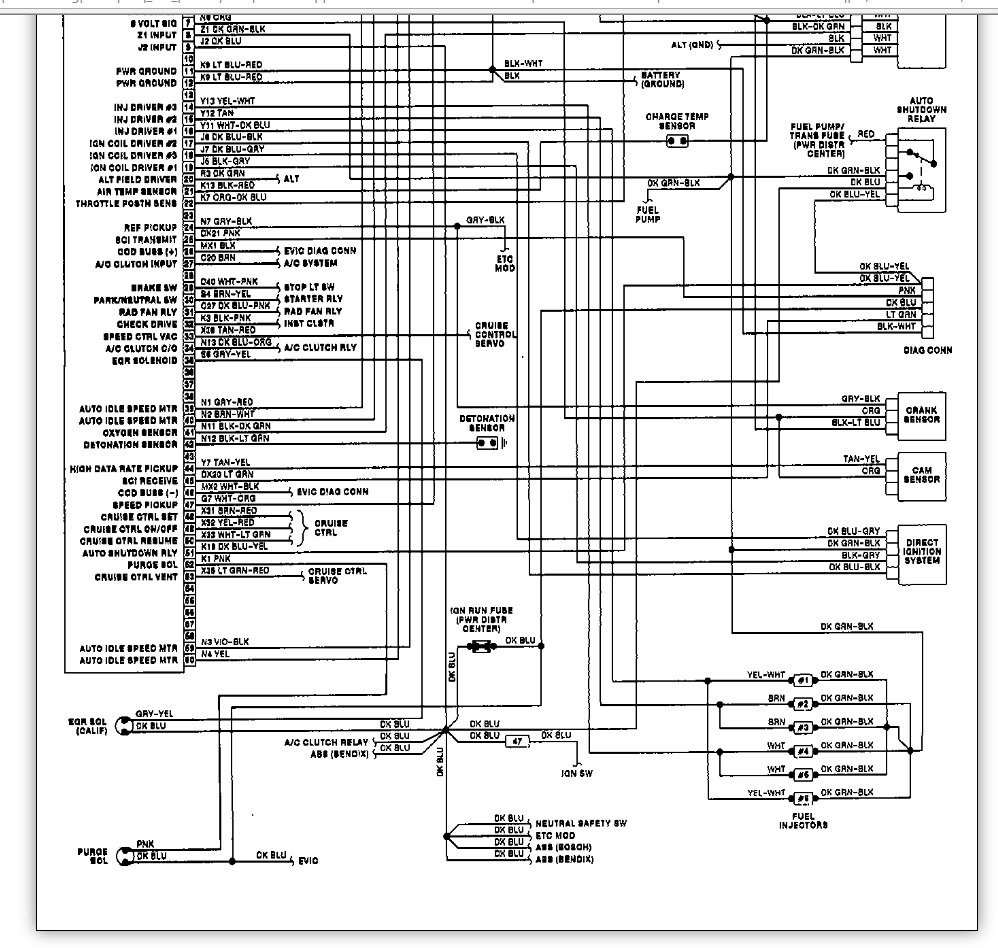

Okay, When I turn on Key, I get 12v input on coil for about 2 seconds, then no voltage. A spark tester shows no spark on any plug while cranking. Of course I cannot check all six at the same time. Plugs do show they have fired at one point.

Also I just found out that when I crank the motor the 12v on the coil pulses on/off.

Disconnecting the Alternator did not help, no change. And I let it sit overnight so it would not be flooded. Again, when I cranked the engine the 12v on the coil pack, "+B" pulses on/off. Should it do that?

No it should not, are you sure its pulsing or is this just voltage fluctuation from the battery being low? Do you have all the engine grounds hooked up? I would double check those.

Lets try a different approach, unplug all of the injectors and crank the engine over, this will clear the cylinders out, next use a volt meter to test the ohms , I'm thinking one of the injectors is shorted causing the computer to full dump fuel.

Injectors are not shorted and all test between 2.8 and 3.0 ohms.

Lets try disconnecting all 02 sensors, if the internal element has shorted to the heater circuit it will cause this problem as well.

If none of these things has helped I say the next step would be to try another computer it must have gotten shorted somehow and needs replacement.

New question.. "IF" the flywheel is on wrong "or" has been damaged as in a dent in the crank sensor ring.. (would this cause it not to spark)?
Jul 26, 2016 at 3:19 AM
  • 55,837 POSTS
Hey Steve,
Yes this would be a problem. Lets use a voltmeter set on millivolts and test the sensor while the engine is cranking over to see if you can get any voltage out of it.
Also have you tried the auto shutdown relay, they had big problems with thoses.
Here is a wiring guide to help out.
Sorry for the delay, the post must have fallen through the cracks. :(
Let me know if you got the problem fixed
