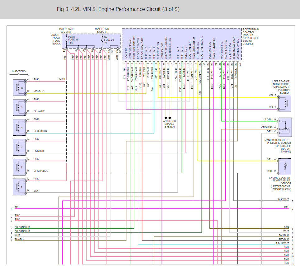

in my car I have delaying start and the scanner give code p0335.
so I replaced the crankshaft position sensor then erased the code,
but still have the same issue.
Update:
I replaced the cranckshaft position sensor. delaying start engine, the car has no power in running. the code of p0335 comes again.
Oct 8, 2017 at 11:02 AM
STEVE W.
  • 15,411 POSTS
That code means that the actual wiring to the crank sensor has a problem. It is either broken or the signal is shorted to ground. Check the connector and test for continuity from the sensors wiring to the PCM. Common areas are at the corners of the heads and intake manifold.

MOHAMED FATHY
  • 7 POSTS
Can you please you send me chart or diagram for the wire if you please?

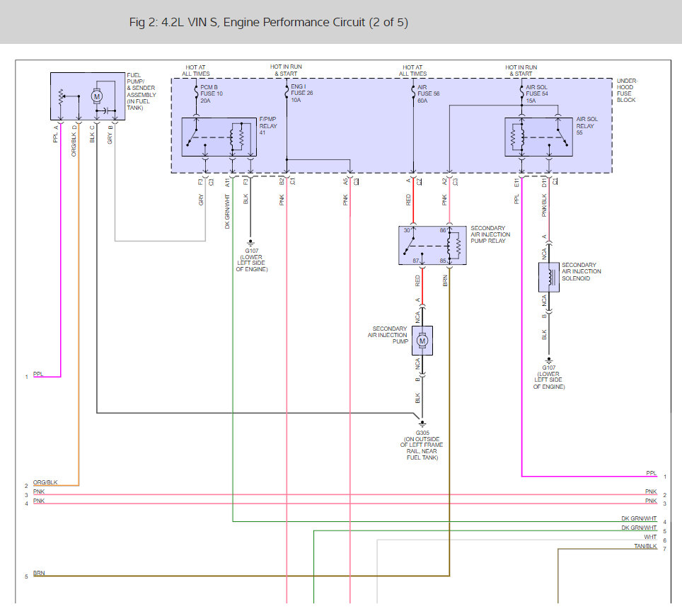

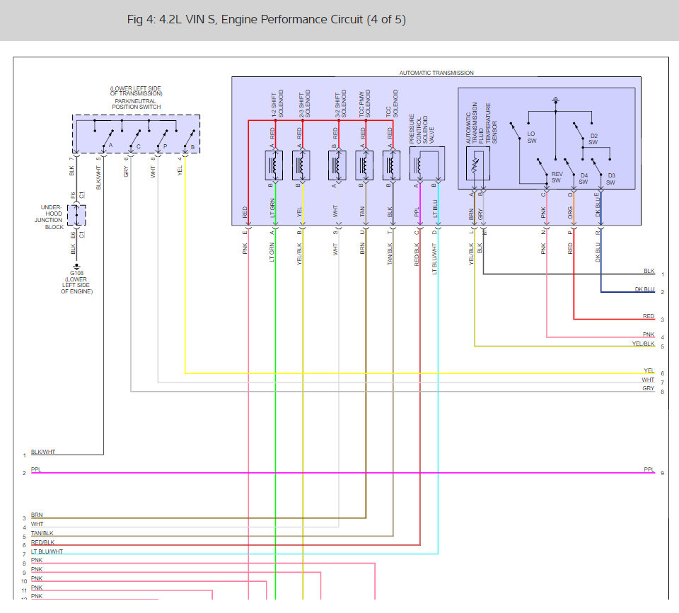

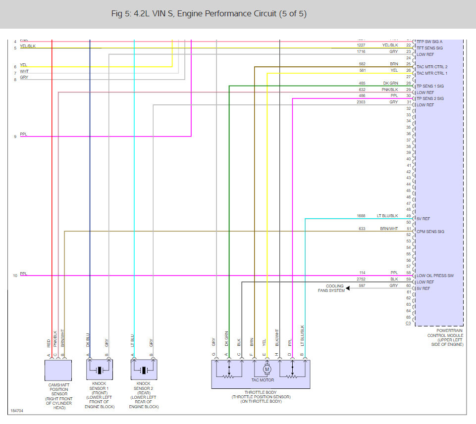

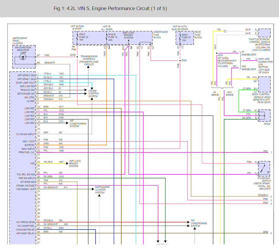

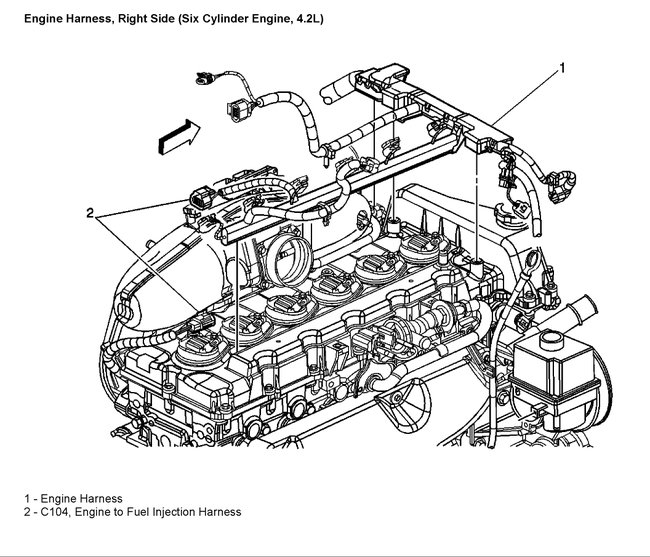

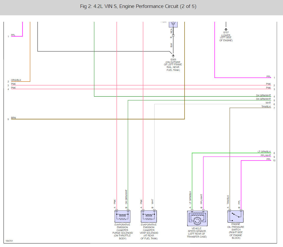

  • 55,716 POSTS
Here is a guide and the wiring diagrams for the engine you will need to get the problem fixed.
Please let us know what happens and upload pictures or videos of the problem.
Oct 11, 2017 at 3:54 AM
STEVE W.
  • 15,411 POSTS
This is the full engine harness it shows all of the engine related wiring and the colors to look for.

MOHAMED FATHY
  • 7 POSTS
hi there
i am so grateful to your response
by checking the cranckshaft position sensor connection and the sensor beside ive found the tow connectorrs wire are attached together
i separate them
covered them
detached the battery
then erase codes
still delaying start but car in moving goes mor powerful than before
can you please guide me what to do

MOHAMED FATHY
  • 7 POSTS
i am so grateful the issue was tow wire of connector crankshaft position sensor attached together i confirm separate them then everything goes well
