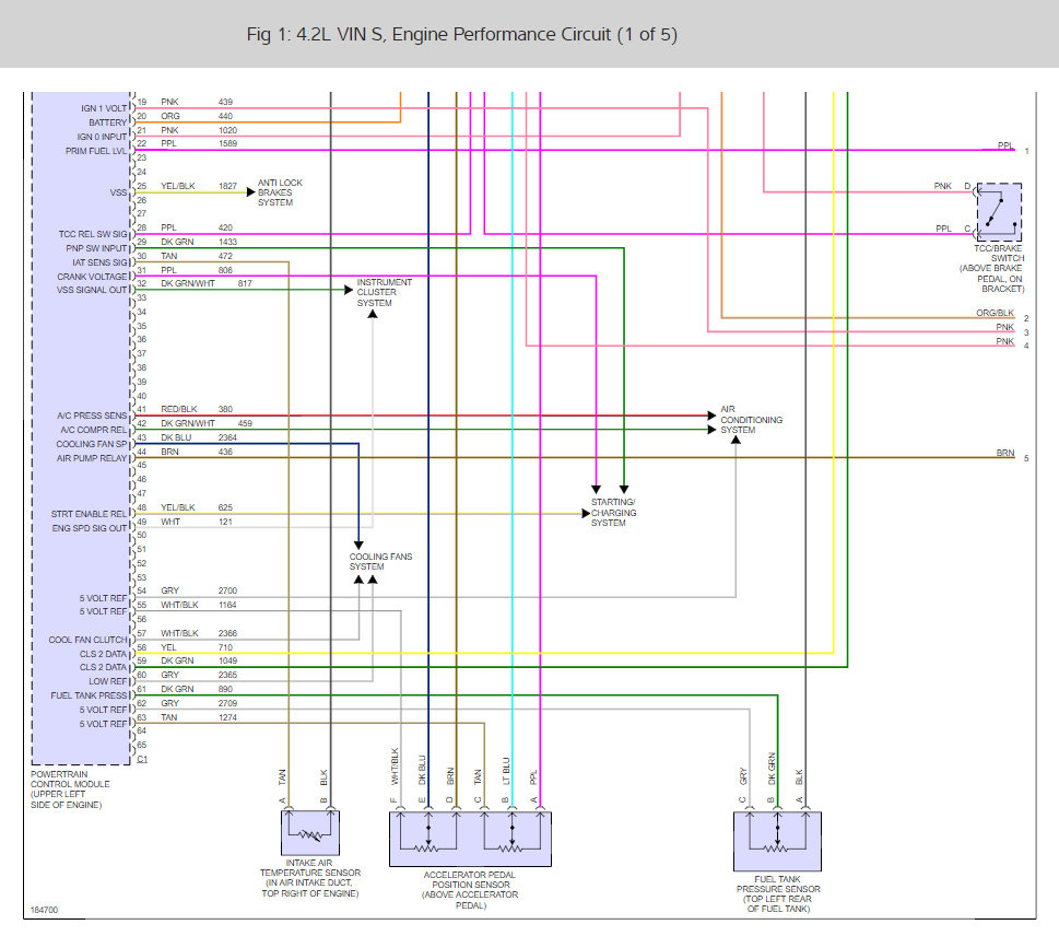

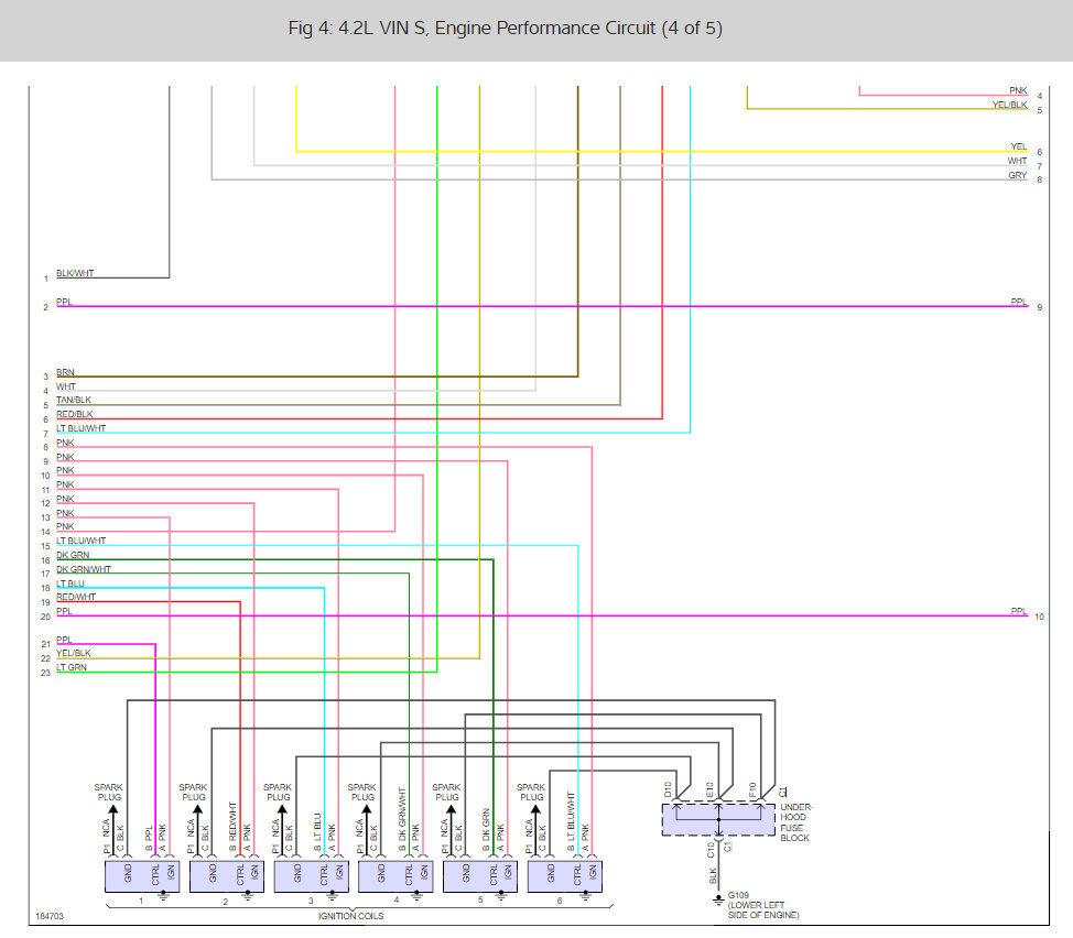

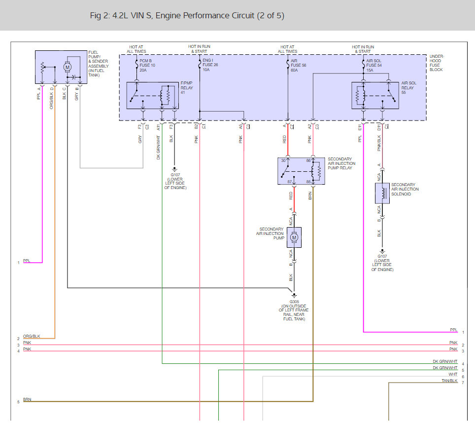

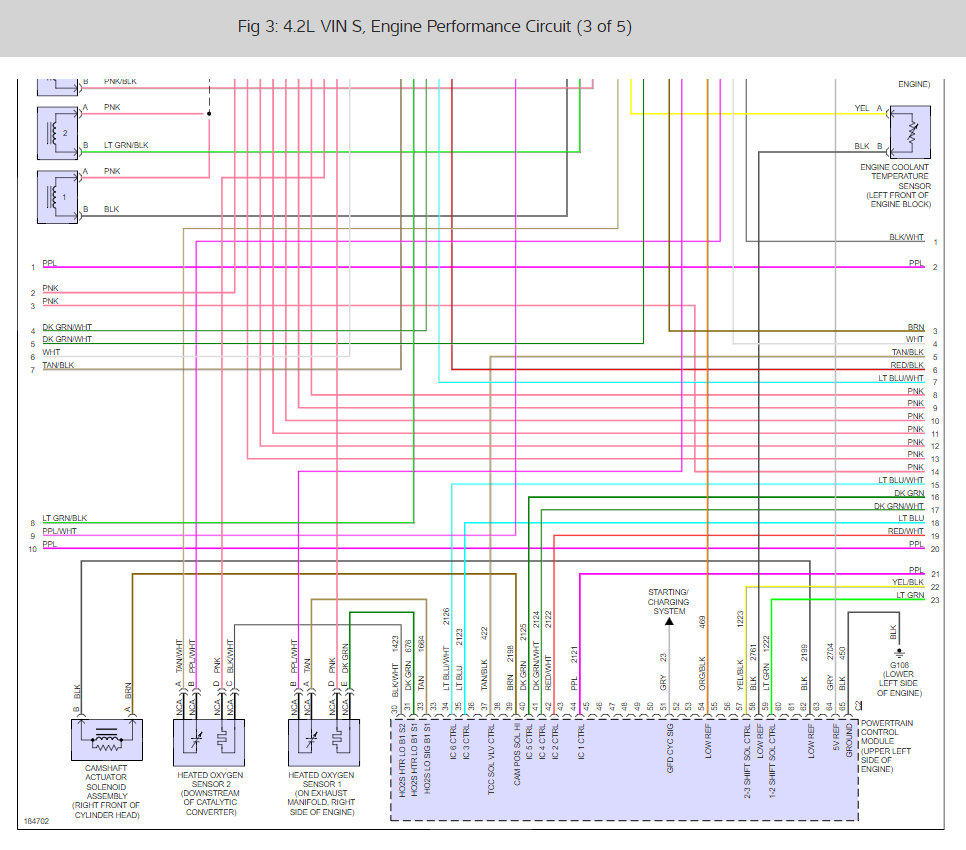

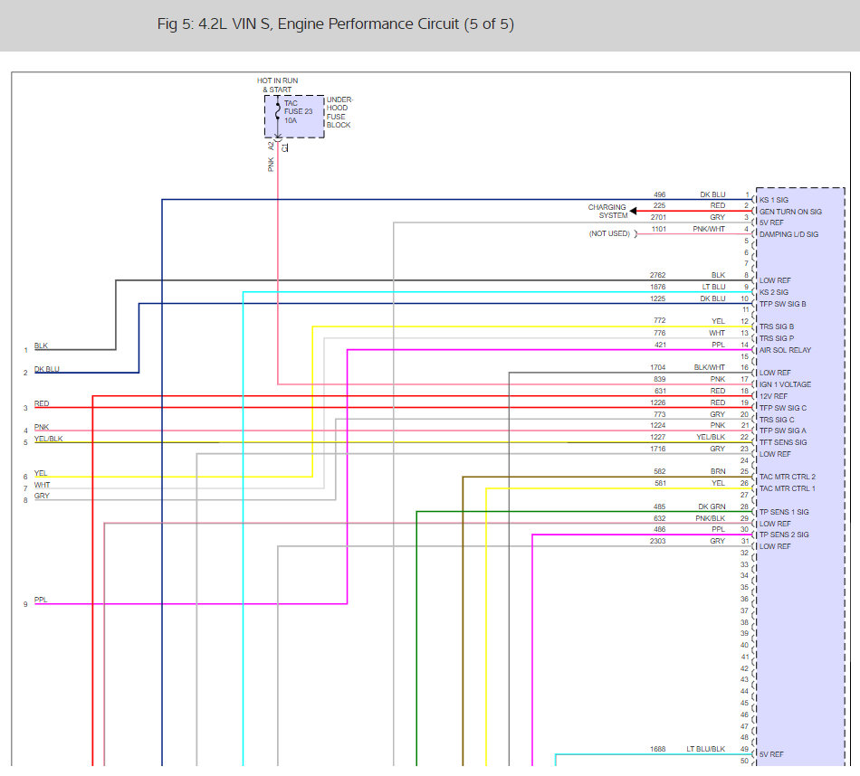

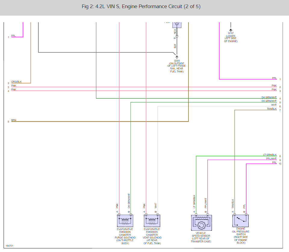

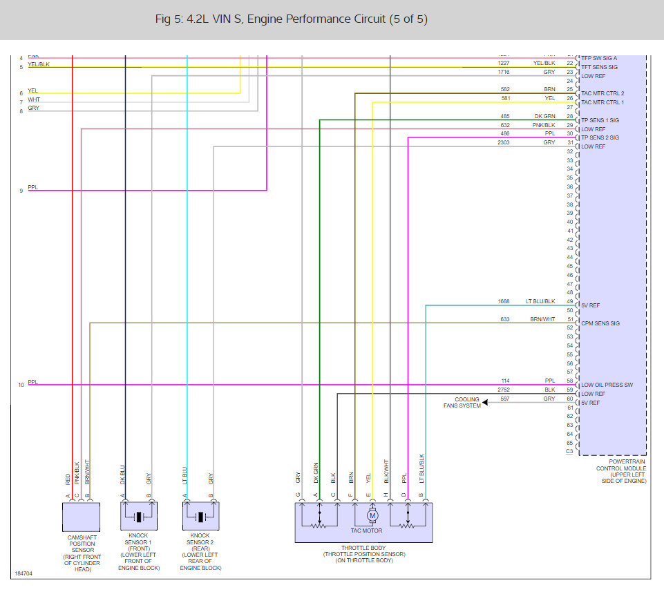

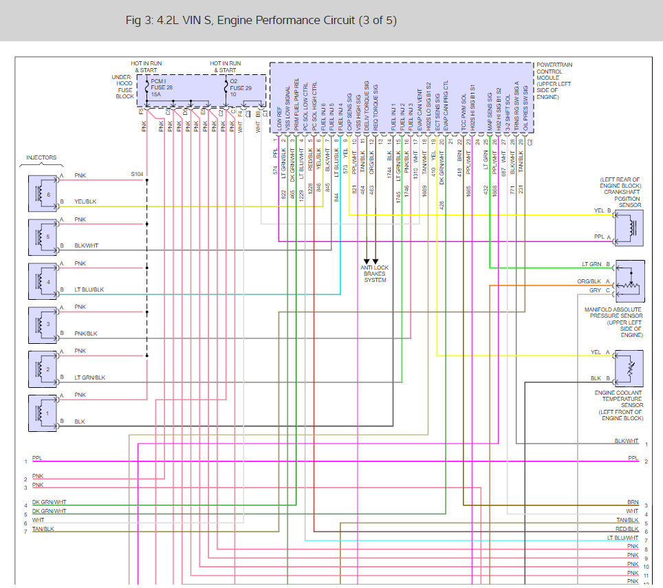

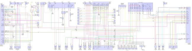

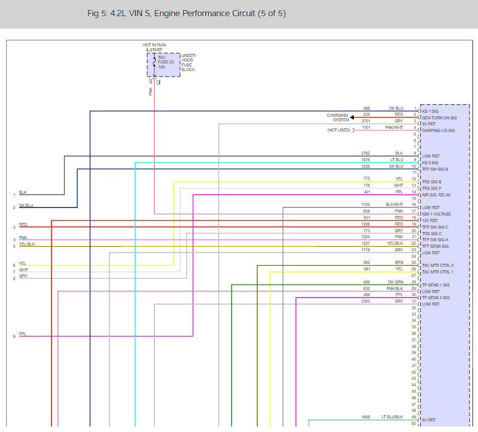

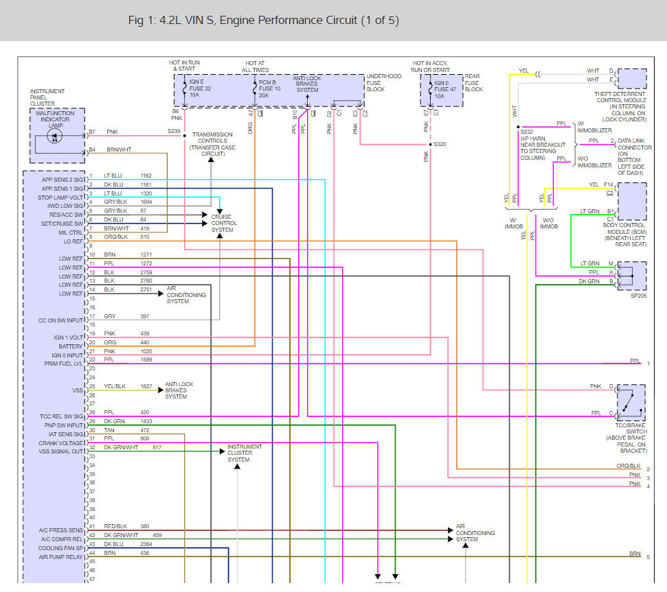

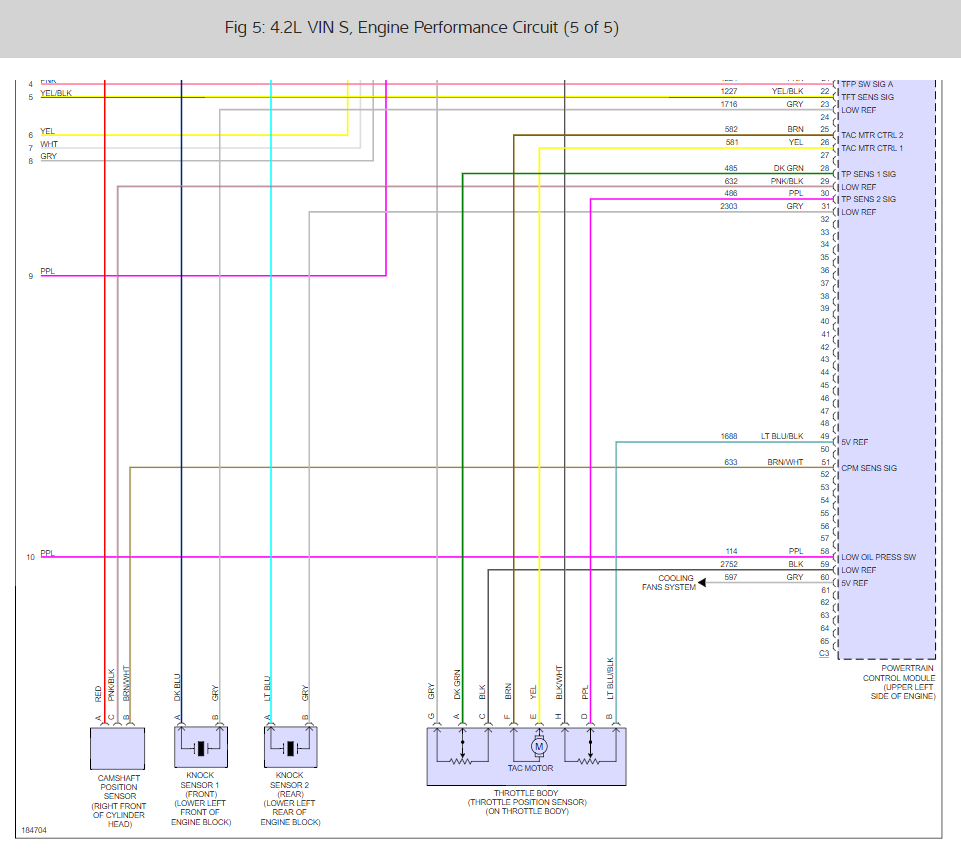

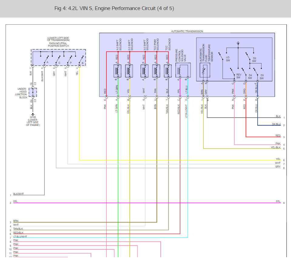

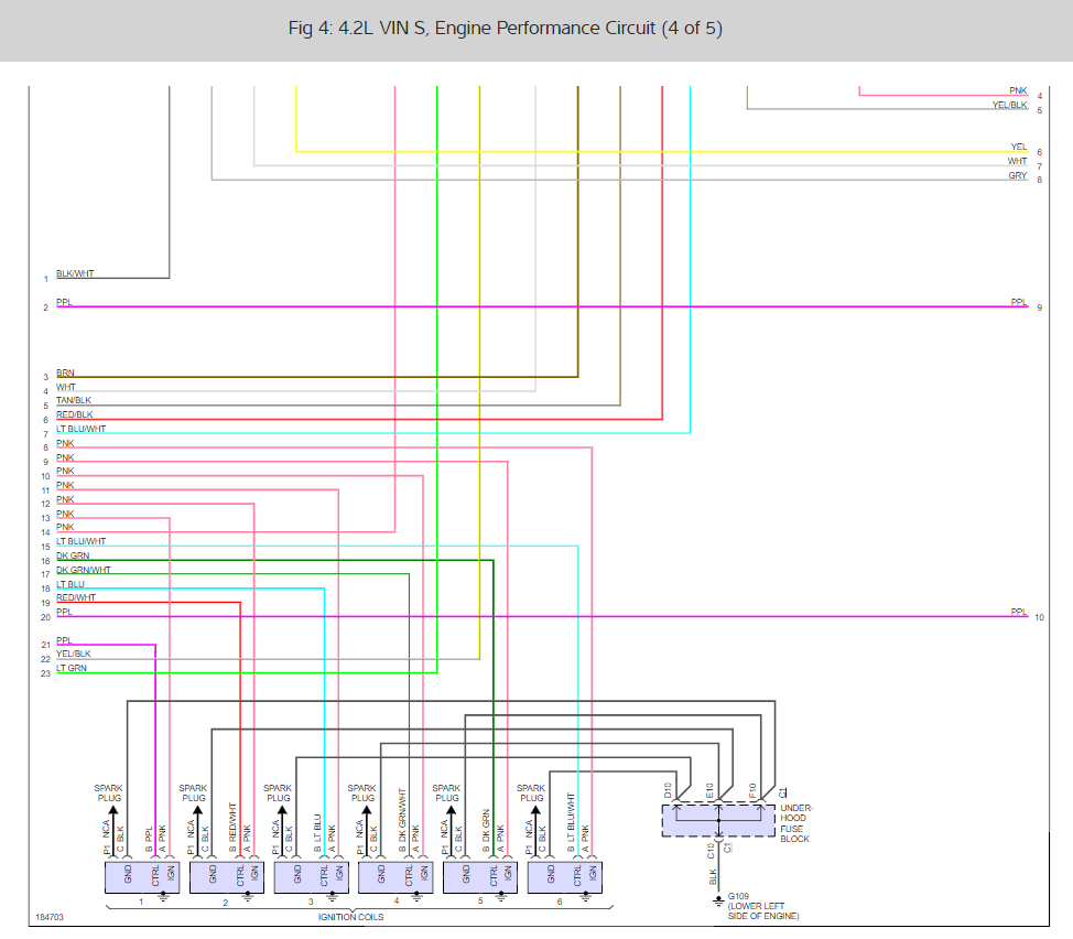

Here is a guide and the wiring diagrams for the engine you will need to get the problem fixed.
Please let us know what happens and upload pictures or videos of the problem.
Oct 11, 2017 at 10:54 AM
STEVE W.
  • 15,200 POSTS

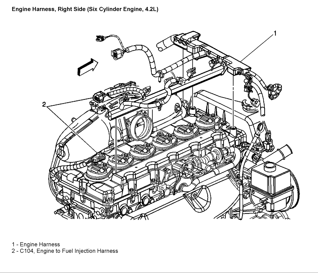

This is the full engine harness it shows all of the engine related wiring and the colors to look for.
Oct 11, 2017 at 11:36 AM
