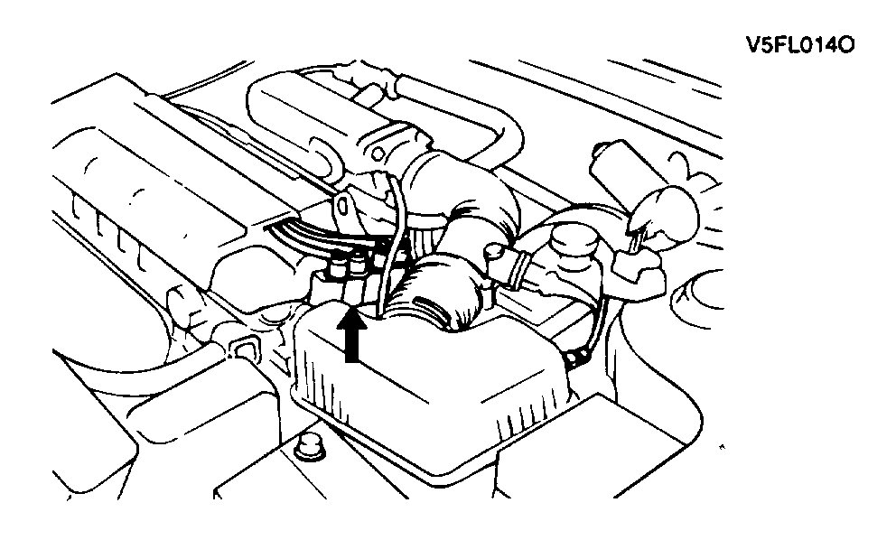

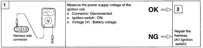

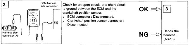

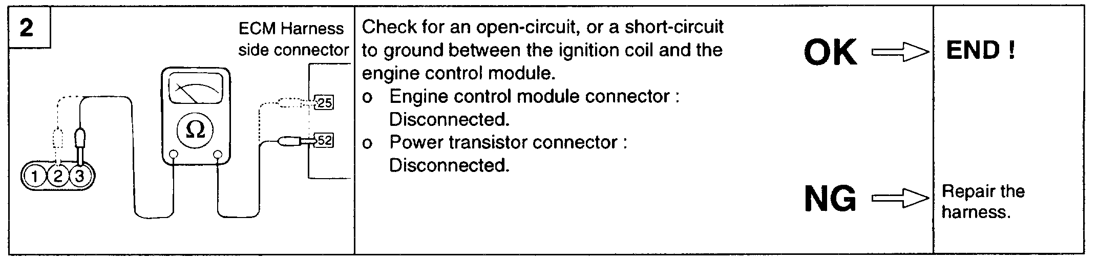

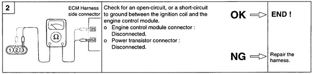

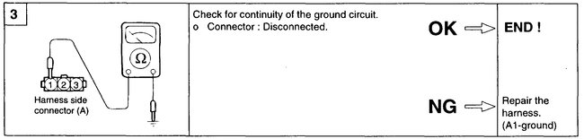

the ignition crank but no spark.
Oct 15, 2019 at 11:33 PM
  • 110,244 POSTS
Welcome to 2CarPros.

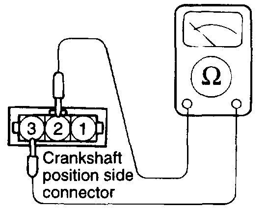

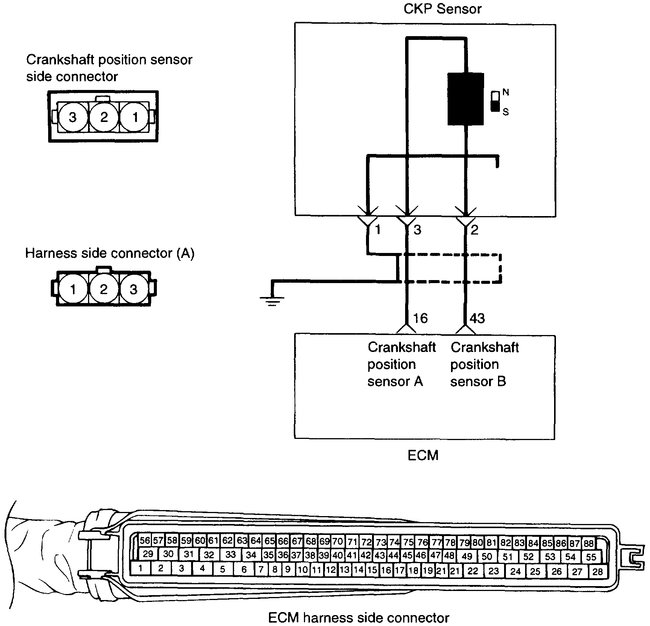

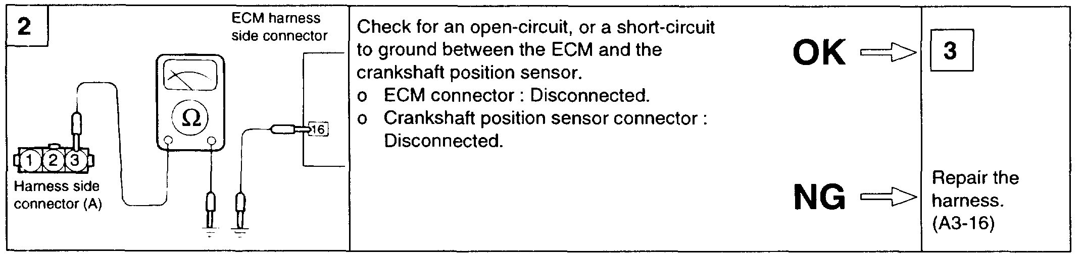

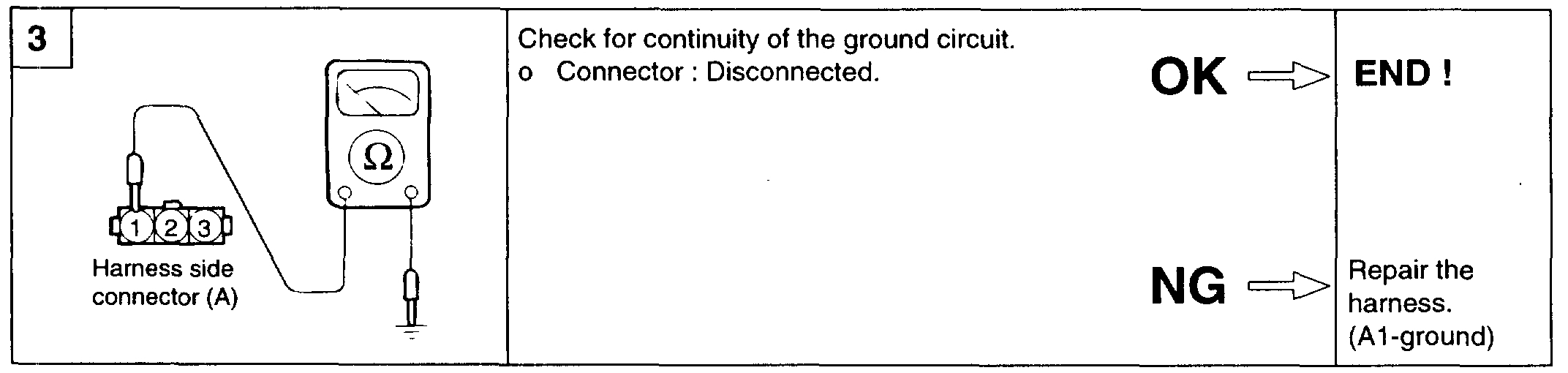

Have you checked for an RPM signal when cranking? I'm suspecting an issue with the crankshaft position sensor. Here are the directions for testing that circuit. I note you are a mechanic, so hopefully this will help.
The attached pics correlate with the directions.

1998 Hyundai Elantra GLS Sedan L4-1.8L
Component Tests and General Diagnostics
Vehicle Powertrain Management Sensors and Switches - Powertrain Management Sensors and Switches - Computers and Control Systems Crankshaft Position Sensor Testing and Inspection Component Tests and General Diagnostics
COMPONENT TESTS AND GENERAL DIAGNOSTICS
pic 1
CIRCUIT DIAGRAM
pic 2
pic 3

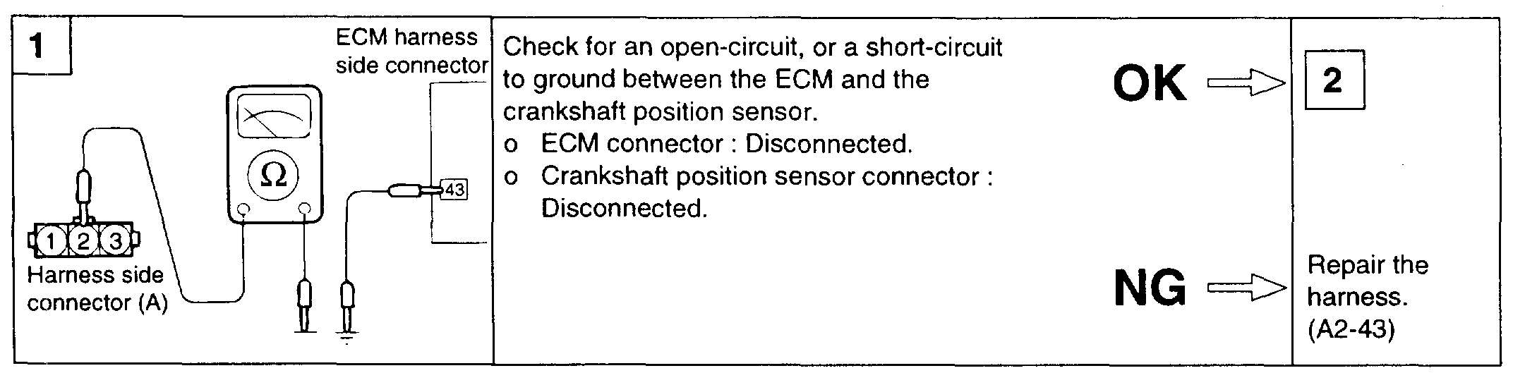

pic 4

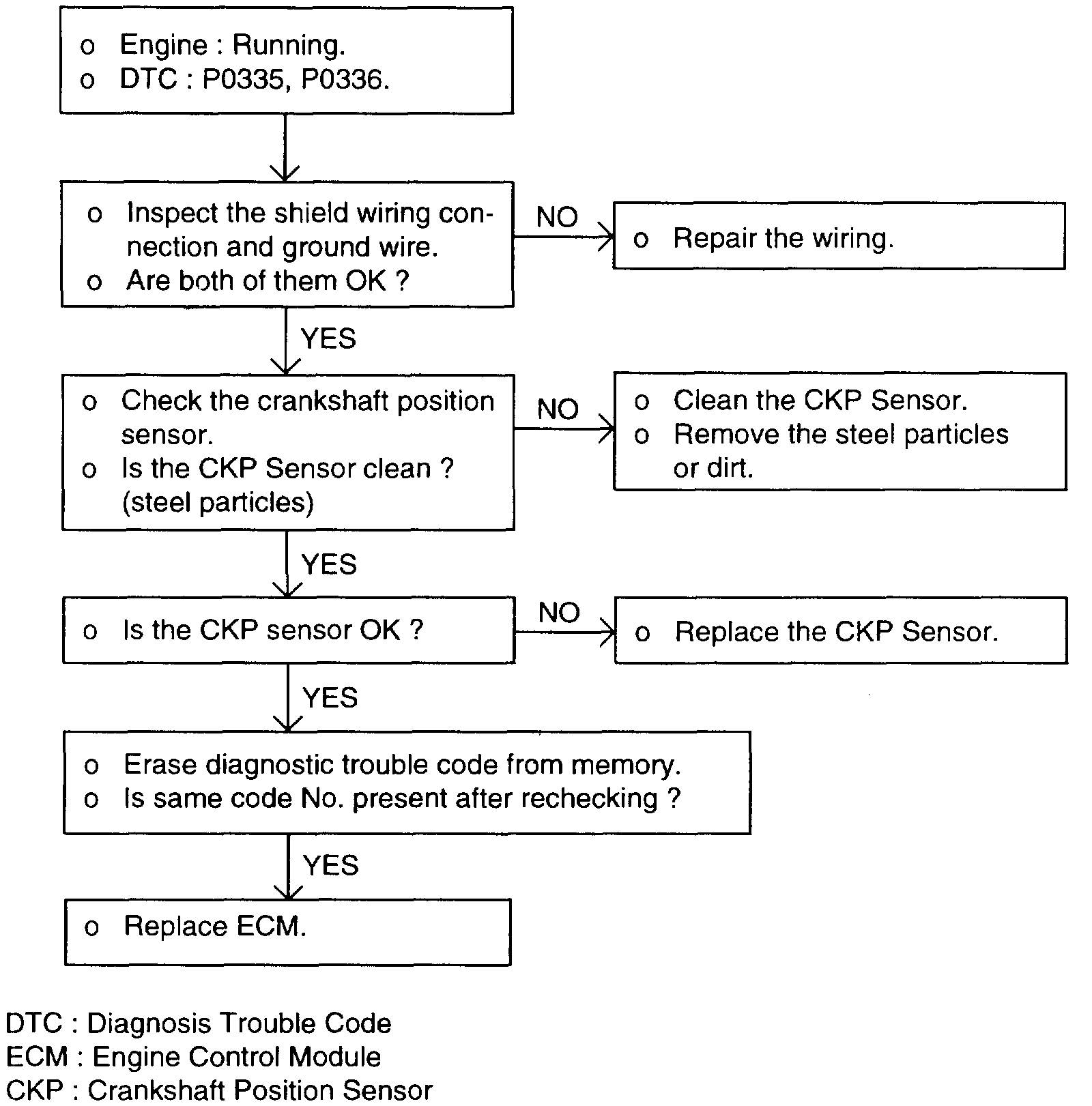

HARNESS INSPECTION PROCEDURE
pic 5
SENSOR INSPECTION
1. Disconnect the crankshaft position sensor connector
2. Measure the resistance between terminal 2 and 3.
Standard value: 0.486-0.594 K Ohms @ 20°C (68°F)
3. If the resistance deviates far from the standard value, replace the sensor.
Clearance between the crankshaft position sensor and crankshaft position sensor wheel: 0.5-1.5 mm (0.020-0.059 in.)
Crankshaft position sensor torque: 9-11 Nm (6.6-8.1 ft.lbs.)
pic 6
TROUBLESHOOTING PROCEDURES
HINTS:
1. If unexpected misses are felt during driving or the engine stalls suddenly, shake the crankshaft position sensor harness. If this causes the engine to stall, check for poor contact at the sensor connector.
2. If the tachometer reads 0 rpm when the engine is cranked, check for faulty crankshaft position sensor or ignition system problems.
3. If the tachometer reads 0 rpm when the engine is cranked and it does not start, ignition coil, power TR, or an ECM defect can be considered.
4. Engine can be stalled when the crankshaft position sensor cable is close to the high voltage cable due to the electronic noise caused by the high voltage induced.

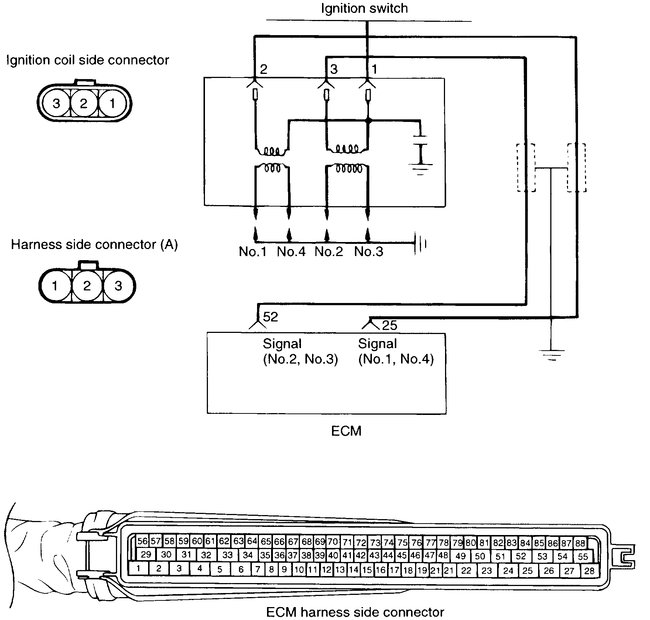

Here are the test procedures for the coil.

17 Ignition Coil
Pic 9
IGNITION COIL
When the ignition power transistor is turned ON by the signal' from the ECM. It sends the signal to the ignition coil, then primary current is shut off and a high voltage is induced in the secondary coil.
pic 10
CIRCUIT DIAGRAM
pic 11

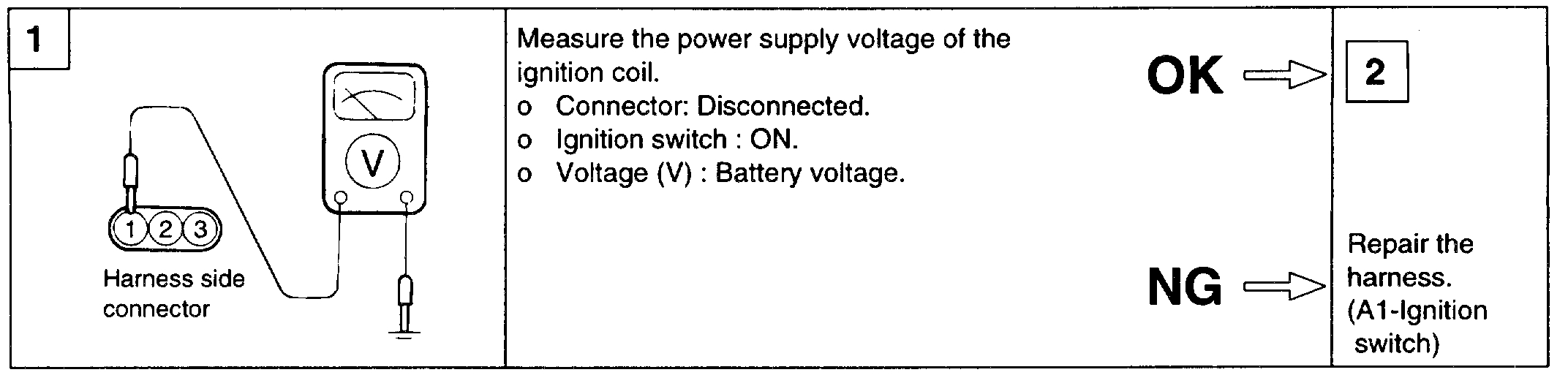

pic 12
HARNESS INSPECTION PROCEDURES
