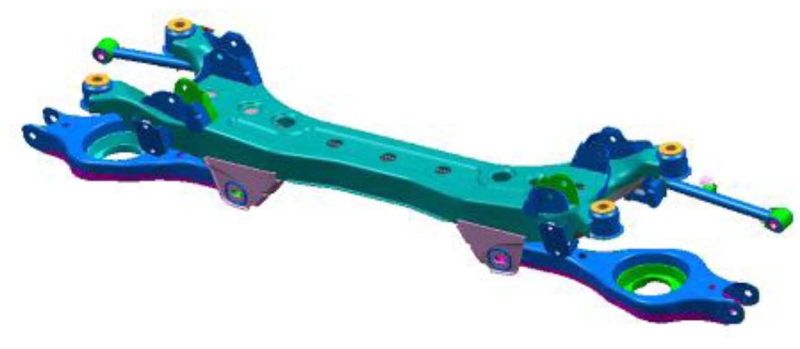

My back tire on the drivers side is at an angle. I took it to a mechanic and they said i need a cradle. Does that sound right or is what?

Very possible. There was a rust state recall for them rusting through and failing. The green area and the gray tabs facing down are the cradle/rear cross member.

So you might want to take it or at least talk to a dealership and see if the recall applies in your case.
