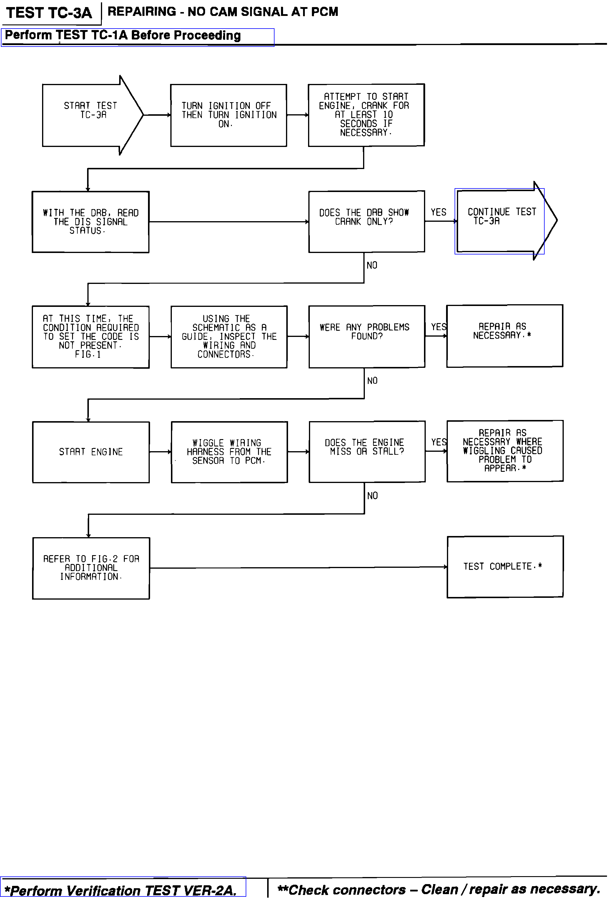

I was in the middle of driving and I lost power. The car cranks but wont turn over. The fuel hard line is good, battery alternator and starter are all fine. My spark plug is getting no spark. So where do I go to figure why that is?

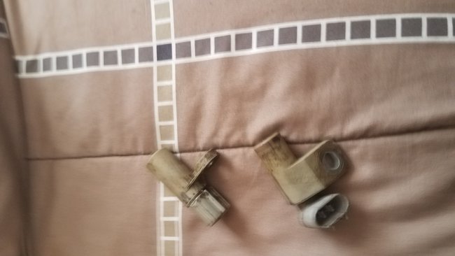

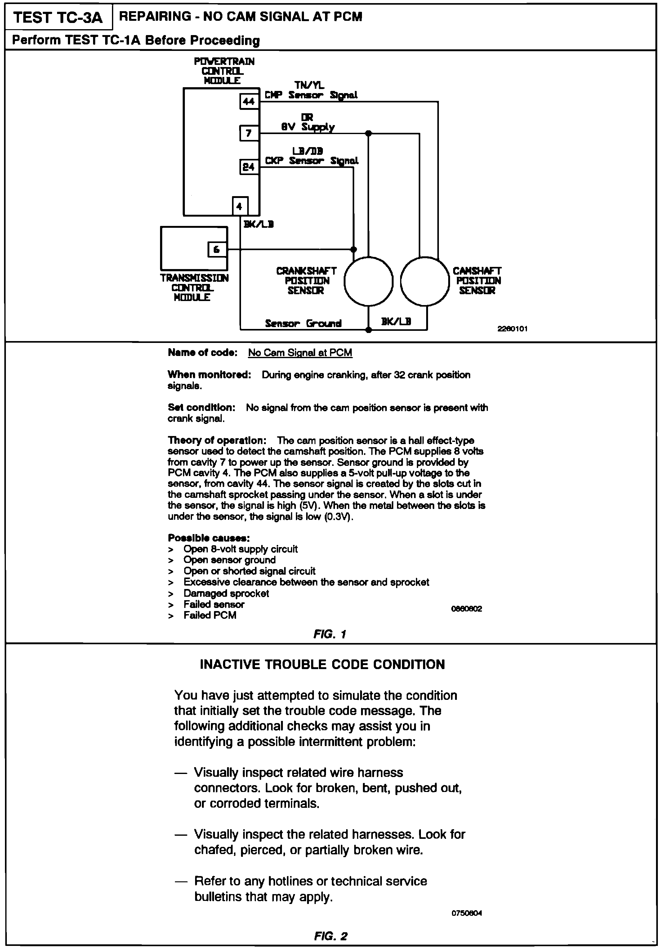

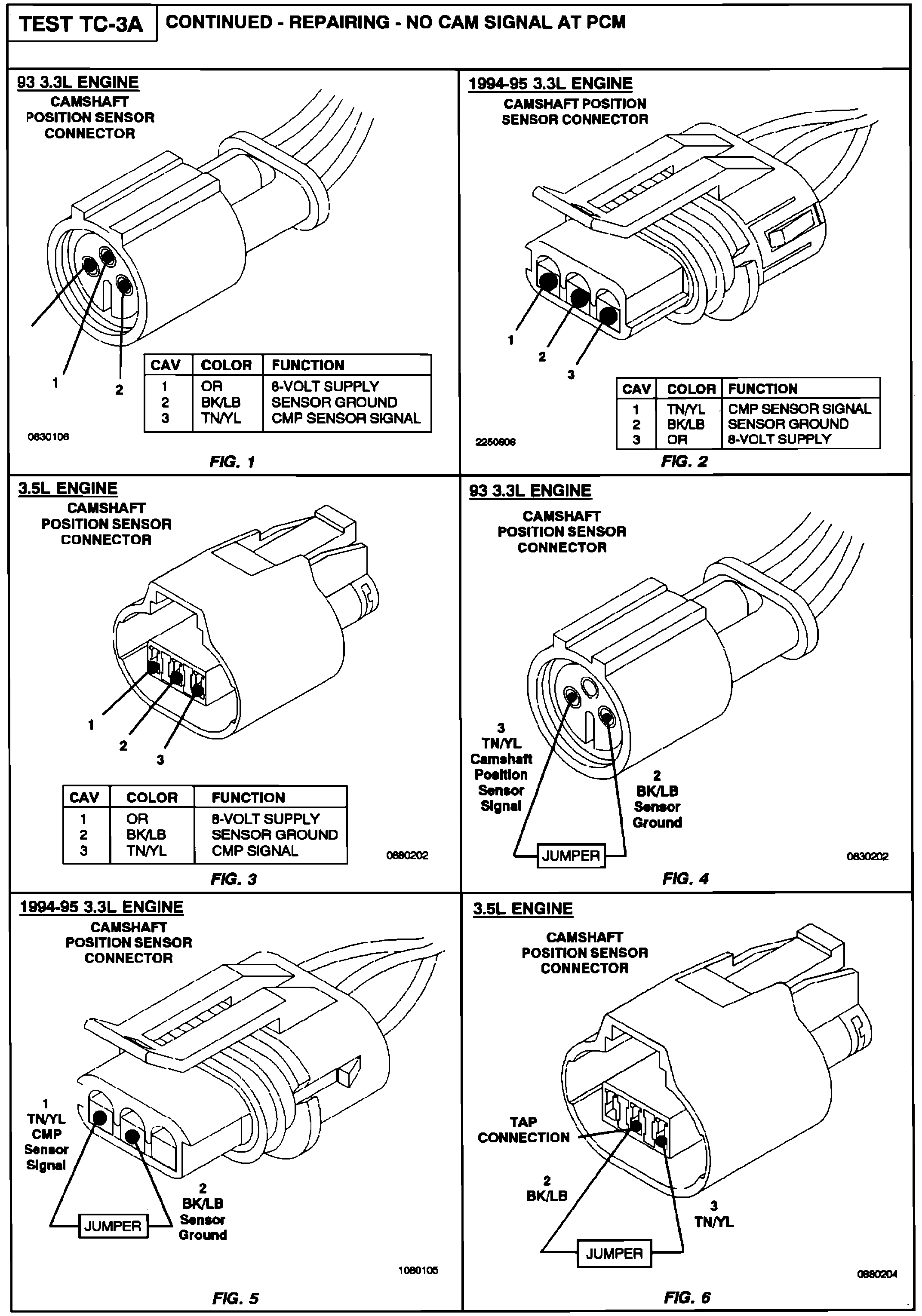

That is the camshaft sensor and crankshaft sensor I replaced along with the ignition coil. I have power to the coil but still no spark. Also when I check the dash for error codes I get 3 55 which doesn't make sense.

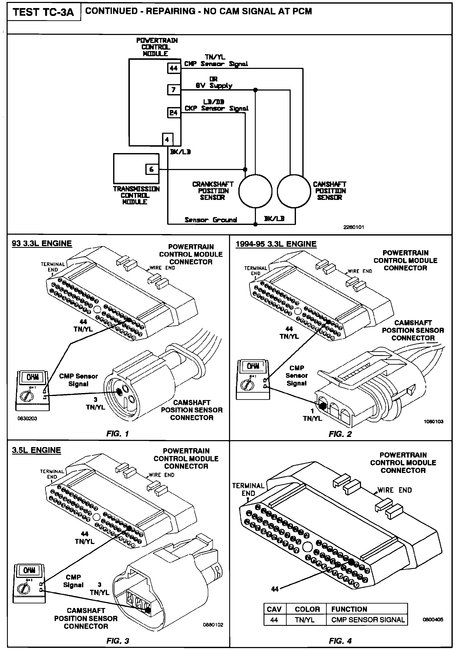

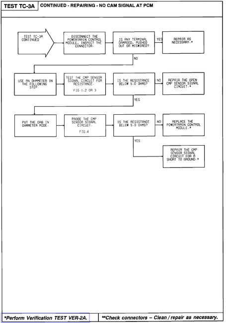

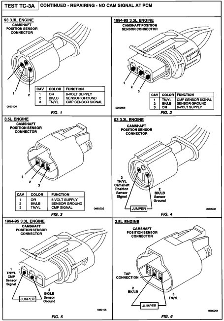

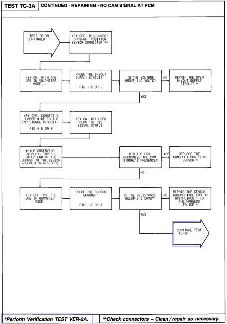

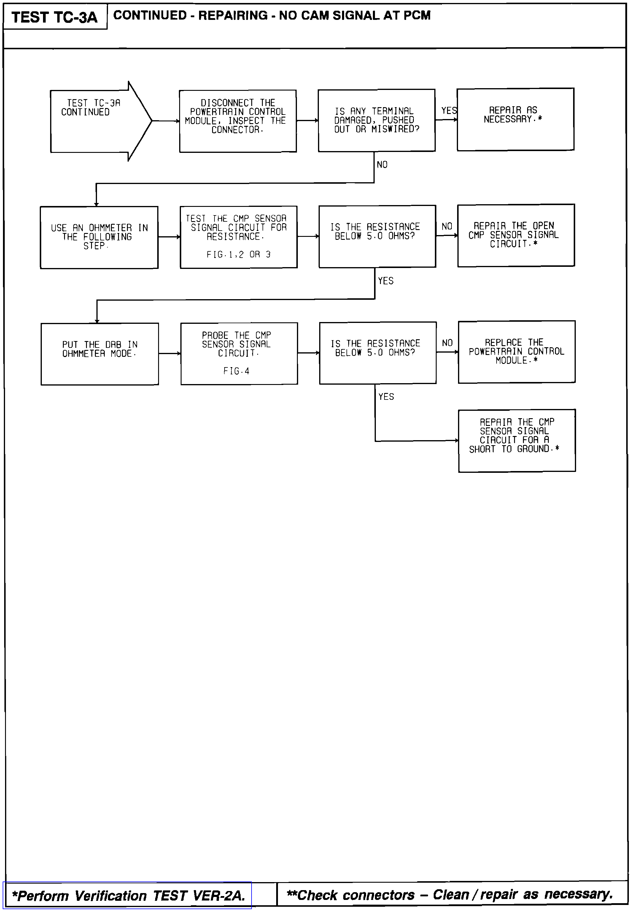

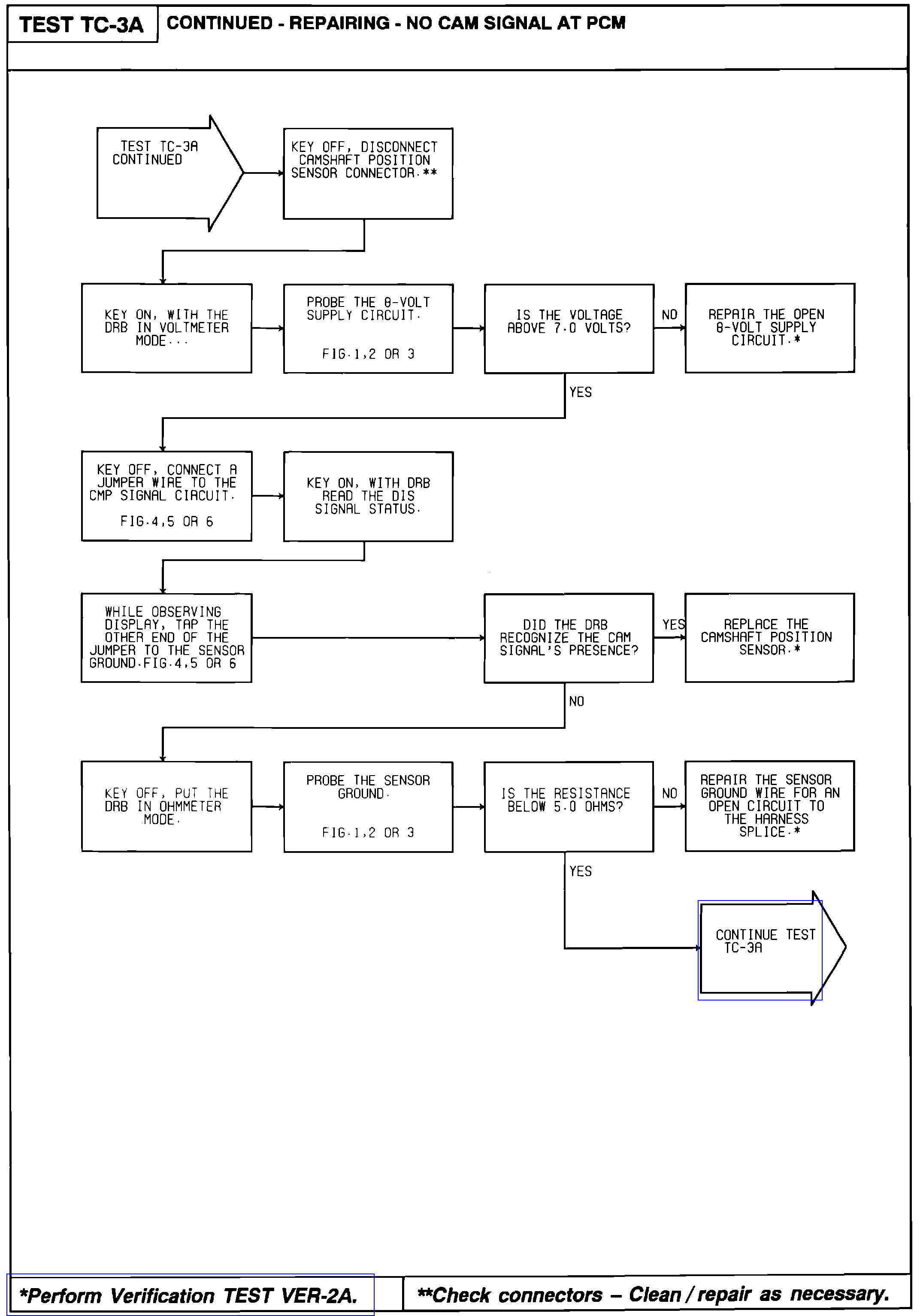

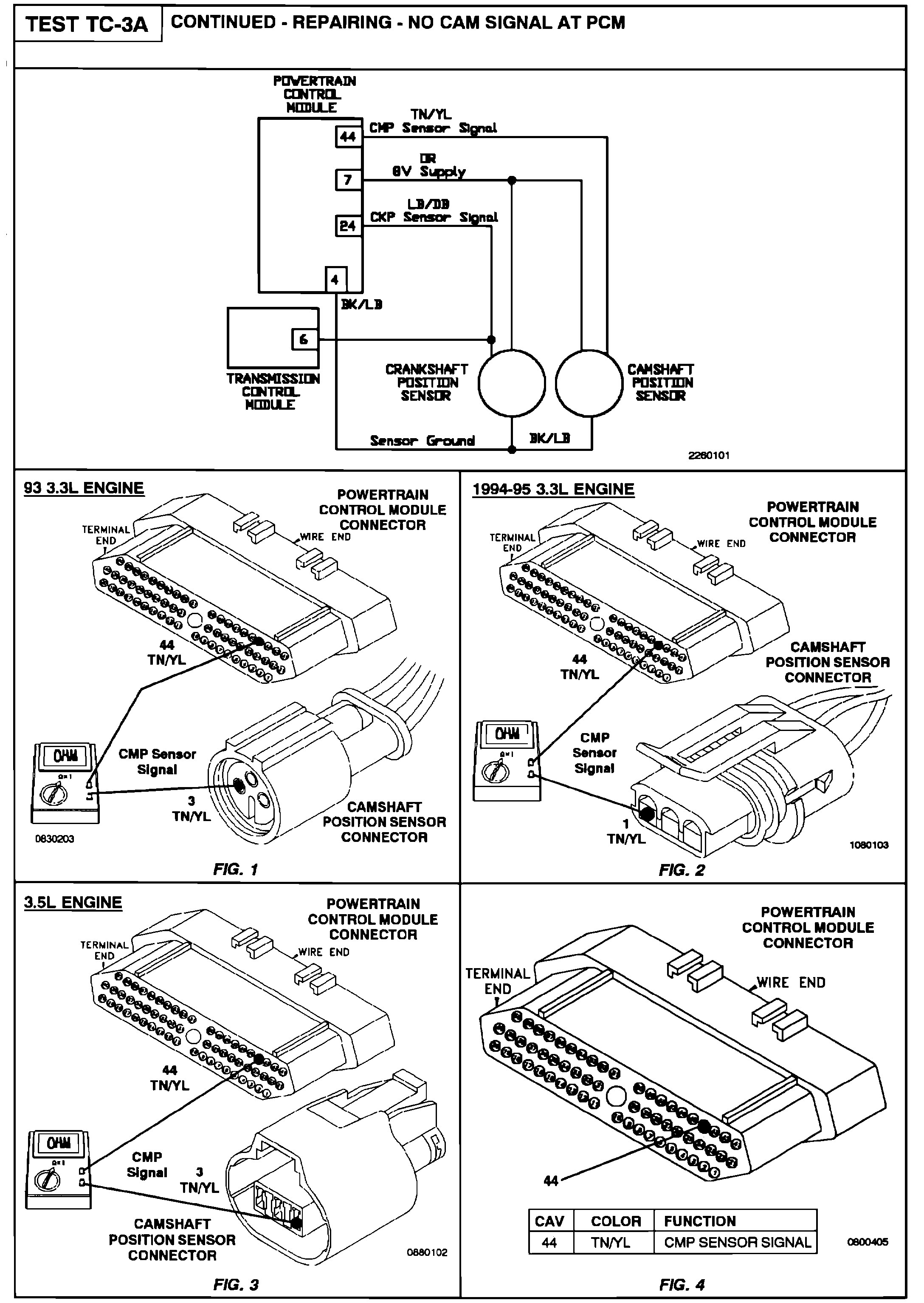

Code 3 indicates there is no camshaft position sensor signal. Code 55 indicates the system test is complete.
I suspect code 3 is what is preventing the engine from starting. Take a look at the attached pics. There are the diagnostics specific to this code and vehicle. See if you are comfortable performing them.

It certainly could be a computer issue. However, the only way to determine if that is the source of the problem and not the sensor is to perform the diagnostics. That way you can eliminate a wiring issue between the two.

According to the codes, you have no camshaft position sensor signal. What I suggest is to follow the diagnostics I listed above.

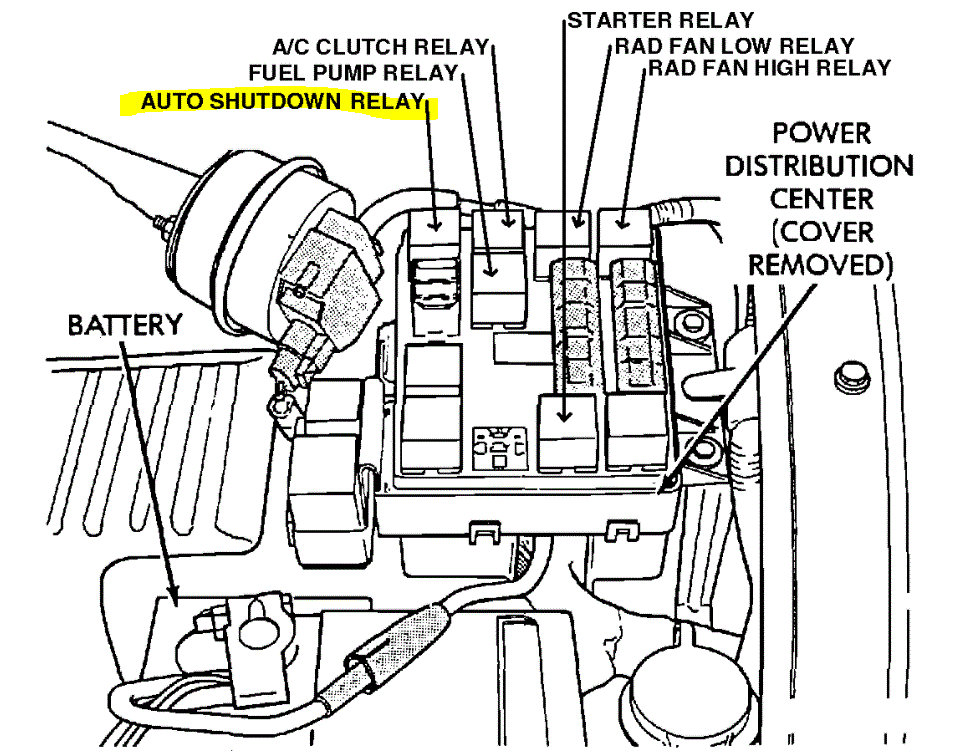

I did further research and if the code is 355 and not 3 - 55, that indicates a problem with the coil for cylinder 5. Although there may be power to the coil, it may not be enough.
Do me a favor. Switch the ASD relay with a different one that has the same part number. See pic 1 for location.

So switching the auto shutdown relay did not do anything and I have an OBD1 reader on mine. so I don't have an actual code 3 my code start at 11.
