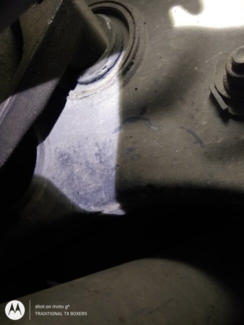

Thanks for the images. It looks like the center support bearing is on backwards. If it was on the other way the driveline would line up. Please do the repair and reload the images, they helped.
Saturday, July 8th, 2023 AT 11:39 AM
WILLIE HURLOCKER
  • 83 POSTS
Ken, the other way it was all out of whack! Remember you said if I had tried turning the cb around if it would put it back in line? Well I turned it around backwards and it's in line now! But did you see the diff. Bushings? Do you think that's where the cracking/popping sound would be coming from? Also, what is the average price to get the rear diff. Bushings replaced?

So, the problem is fixed or? The bushings in the image don't look that bad to cause a problem. Was the car in an accident?

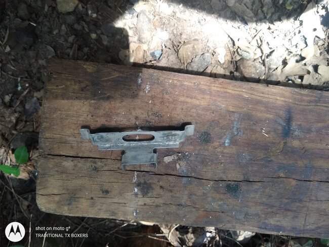

This couldn't be causing the cracking/popping sounds, right? I forgot to put this back on a month or so ago. It goes in there for the e brake cable on the rear!

It could if the cable is loose and flopping around. I would reinstall it to see what happens.

That's a lot of work for that little thing! I'd also have to buy another wheel bearing nut!

Well Ken, I put that metal bracket back on the rear driver's side and while I was under there I looked and touched every bolt/not I could find under the rear end and everything is tight.
