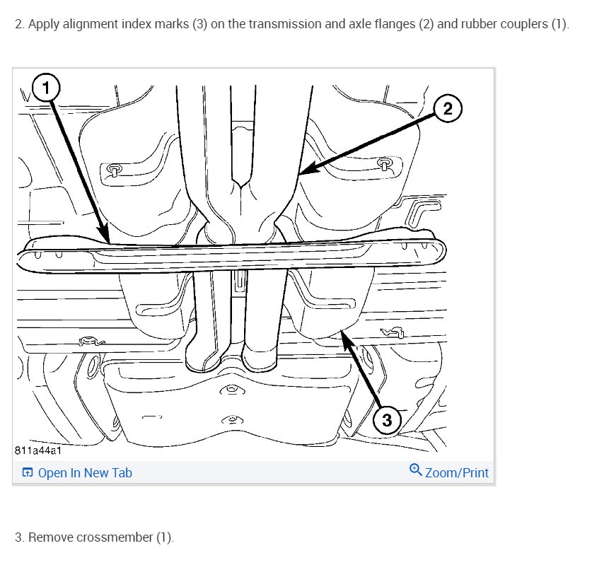

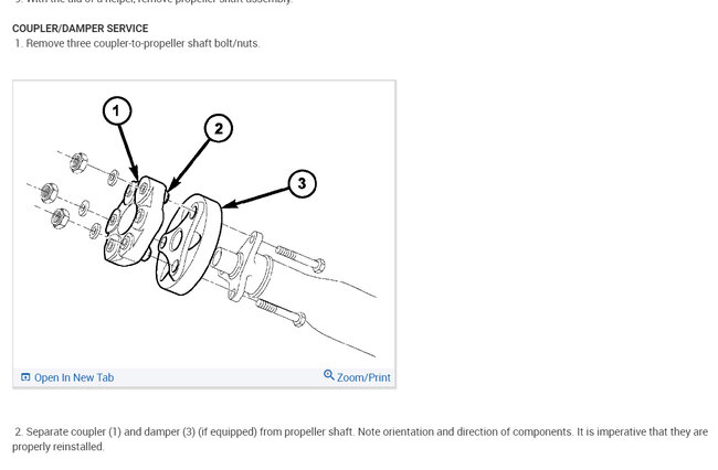

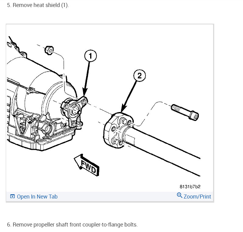

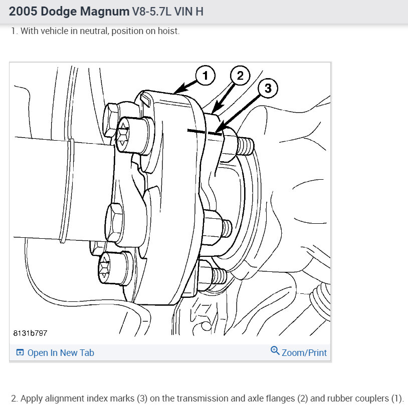

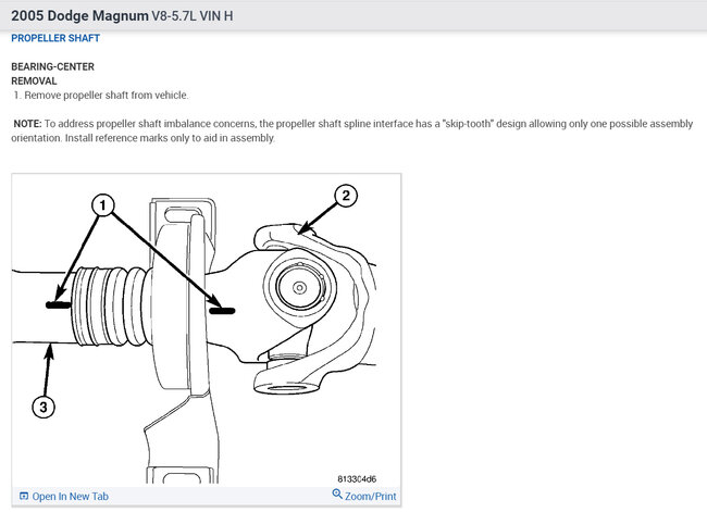

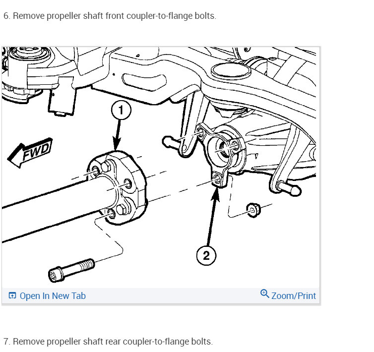

Yep, it sounds like a U joint or rubber coupler issue, can you get underneath to look for rust colored dust around the U joint ( center this is proof the U joint has gone bad. Or check out the rubber couplers at the front and rear of the shaft. You don't have to get the shaft balanced when doing the work, you can replace the couplers with normal tools, but the U joint will need to be pressed in and out. Check out the images (below). Let us know what happens and please upload pictures or videos of the problem so we can see what's going on.
Jun 24, 2023 at 3:56 AM

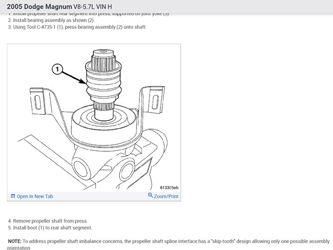

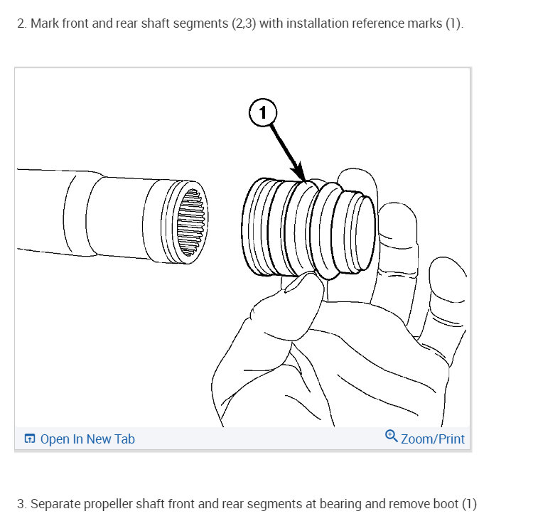

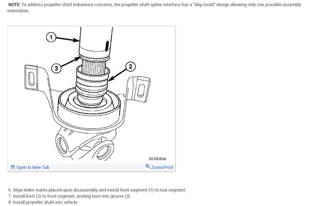

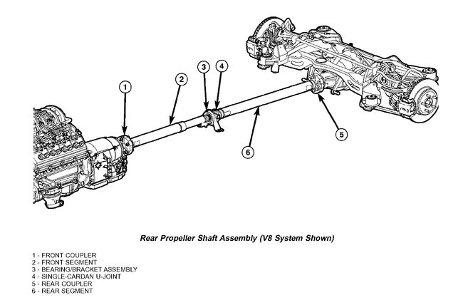

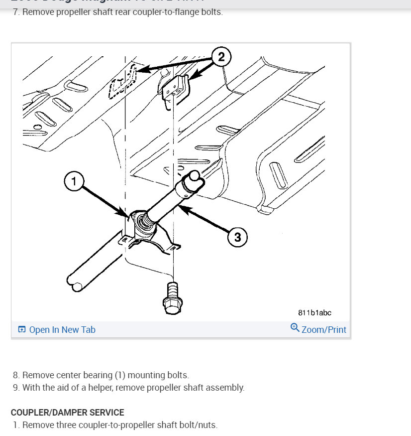

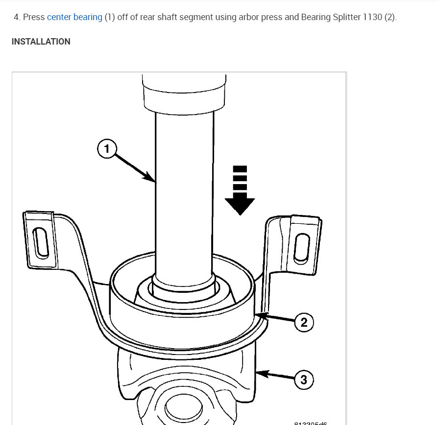

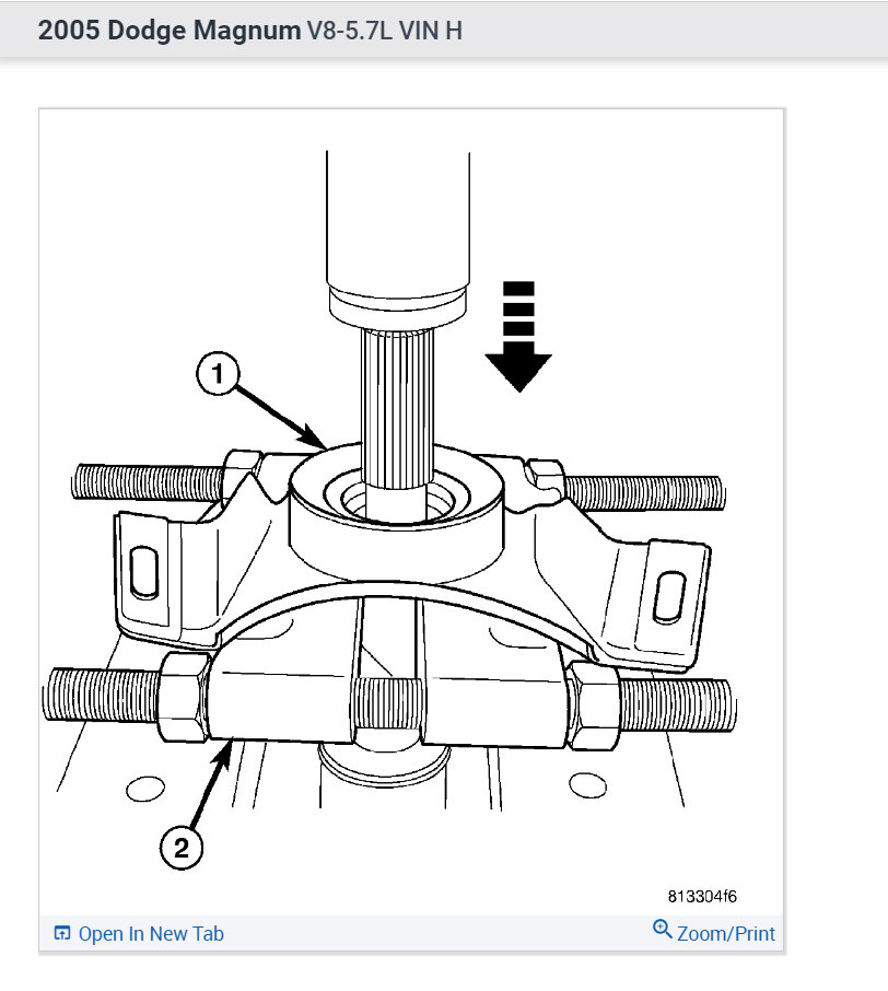

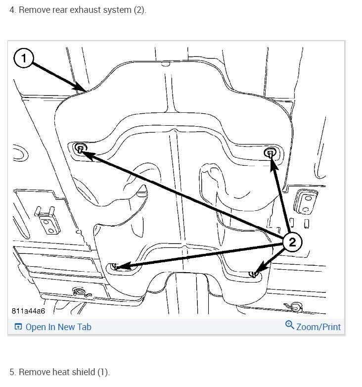

No, you should not be able to move the drive shaft that much. It sounds like you need a carrier bearing and mount. Here is how the job is done and you can inspect the couplers as well. Check out the images (below). Please let us know what you find.
Jun 25, 2023 at 4:42 AM

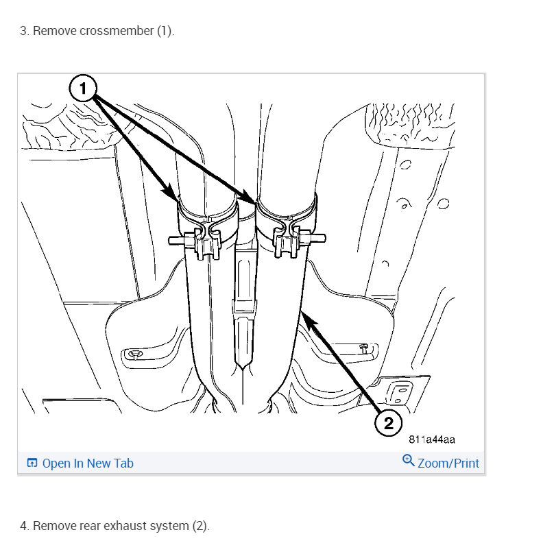

i went and bought a new carrier bearing today and had my exhaust off and grabbed the new bearing to make sure it matched. the darn thing was broken straight out of the box!! The one I'm replacing 2 months old!!! is there anything America makes now a days?

I am sorry to hear that. It happens. I forgot to mention to mark the shaft so you can put it together the same way it came apart.

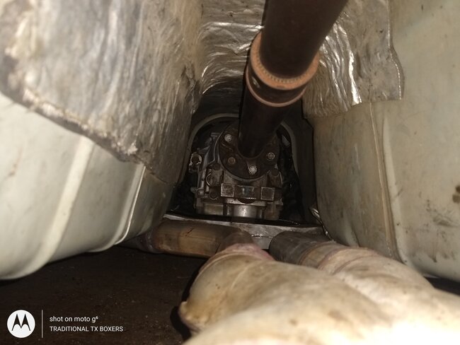

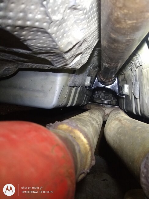

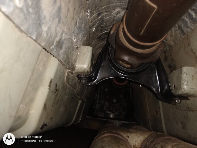

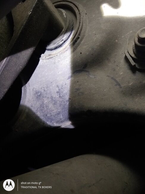

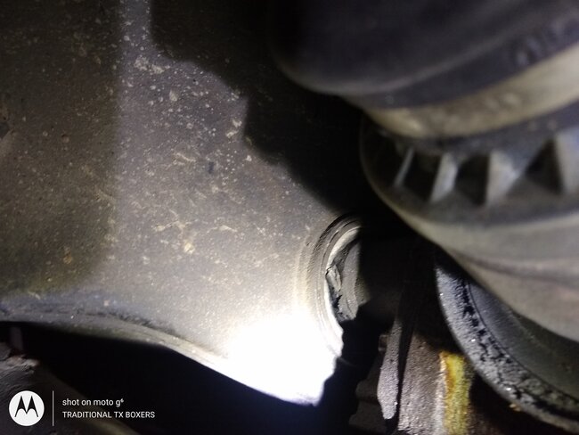

Hey Ken, i got you some pics. the last 2 pics is the rear bushing (lower on the subframe) could that make my rear end out of angle like putting a different pitch to the pumpkin causing the cracking/popping sounds?
Jul 7, 2023 at 12:52 PM
  • 55,423 POSTS
Thanks for the images. it looks like the center support bearing is on backwards. If it was on the other way the driveline would line up. Please do the repair and reload the images, they helped.
Jul 8, 2023 at 4:39 AM
WILLIE HURLOCKER
  • 83 POSTS
Ken, the other way it was all out of whack! Remember you said if i had tried turning the cb around if it would put it back in line? well i turned it around backwards and it's in line now! but did you see the diff. bushings? do you think that's where the cracking/popping sound would be coming from? also, what is the average price to get the rear diff. bushings replaced?

So, the problem is fixed or? The bushings in the image don't look that bad to cause a problem. Was the car in an accident?

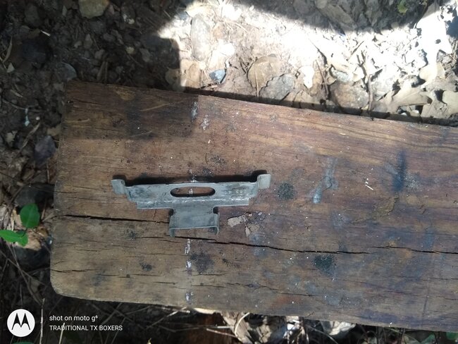

this couldn't be causing the cracking/popping sounds, right? i forgot to put this back on a month or so ago. It goes in there for the e brake cable on the rear!
Jul 10, 2023 at 2:10 PM
  • 55,423 POSTS
It could if the cable is loose and flopping around. I would reinstall it to see what happens.
