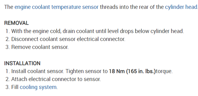

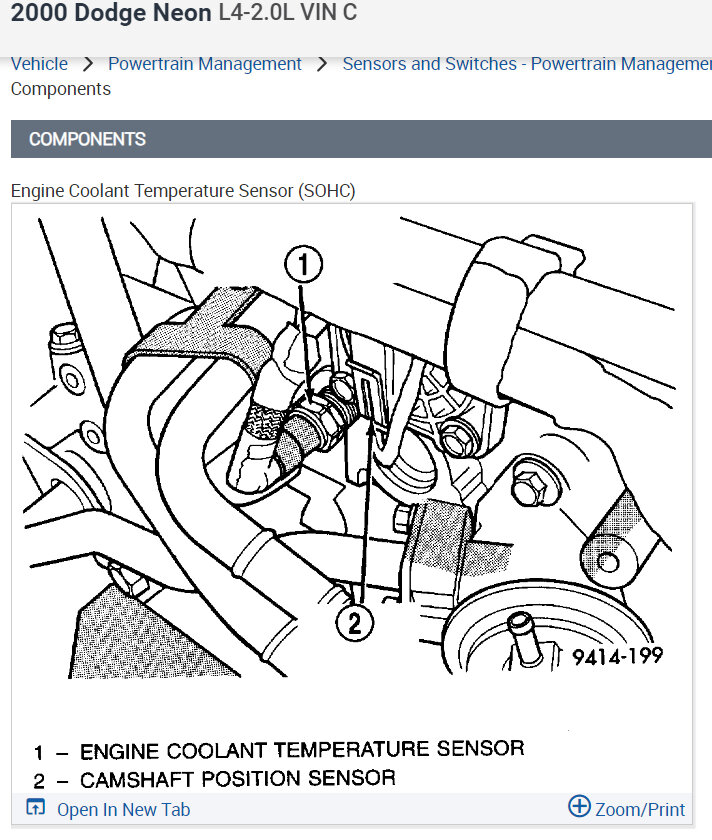

With the key in the on position and a warm motor the temperature gauge works, and you can turn the cruise on and off. When you start the motor, the gauge goes to cold and the cruise stops working. shows no codes.
Apr 5, 2024 at 11:54 PM
  • 55,673 POSTS
Yes, the cruise will not work if the engine is cold, I would swap out the engine coolant temperature sensor which should fix the problem. Here is the location of the sensor so you can swap it out. Check out the images (below). Let us know if you need anything else.
