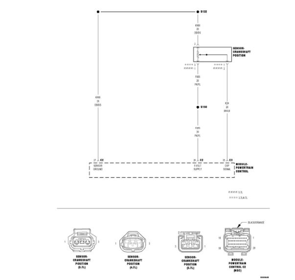

SHADOW2627
Car scanner said it was the crankshaft position sensor was bad. So I changed it with a new one and it is still giving the same problem. It has a hard time starting but when it starts it runs rough. I put the gas pedal and nothing. It just stays at ideal.

Codes do identify failed parts, just systems that have a failure.
What is the code that was set?

P0335.
Sep 8, 2019 at 5:18 PM

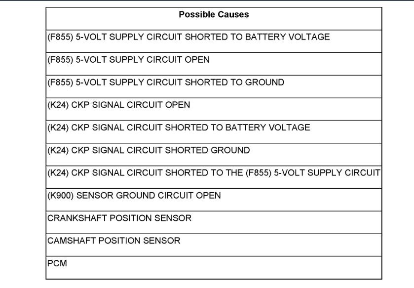

Below are the possibilities for the 335. All these need to be checked.
This is more of a wiring issue than the sensor issue.

Probable Causes
(K824) 5-Volt Supply Circuit Open
(K824) 5-Volt Supply Circuit Shorted to (K925) Return Circuit
(K824) 5-Volt Supply Circuit Shorted to Battery Negative
(K853) 5-Volt Supply Circuit Open
(K853) 5-Volt Supply Circuit Shorted to Battery Negative
(K853) 5-Volt Supply Circuit Shorted to Return Circuit
(K925) Return Circuit Open
5-Volt Supply Circuit Shorted to Ground
5-Volt Supply Circuit Shorted to Voltage
