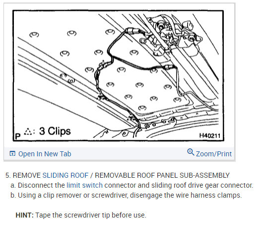

Convertible top not working
2004 LEXUS SC 430
118,000 MILES • 4.3L • V8 • 2WD • AUTOMATIC
FERNBAZ

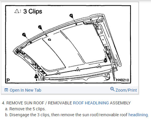

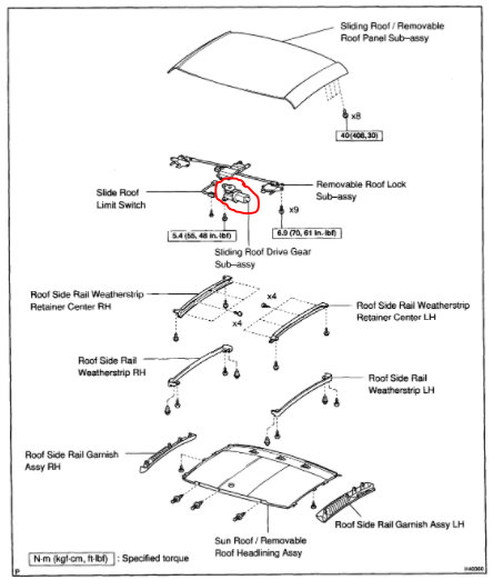

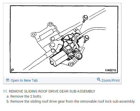

The drive gear assembly part was identified as Lexus 63240-24030. I need someone in the Kendall FL, 33183 area that can replace the component.
Nov 24, 2018 at 12:06 PM
DANNY L
  • CAR REPAIR CONTRIBUTOR
  • 5,648 POSTS

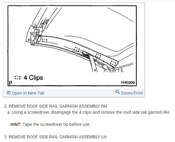

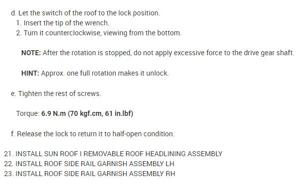

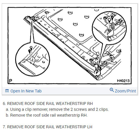

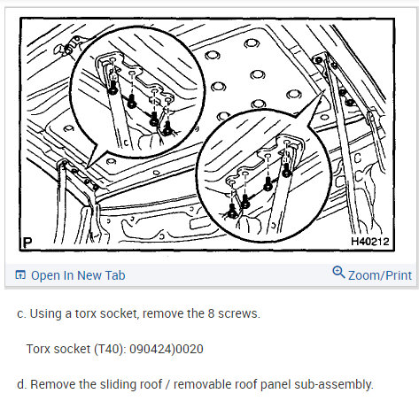

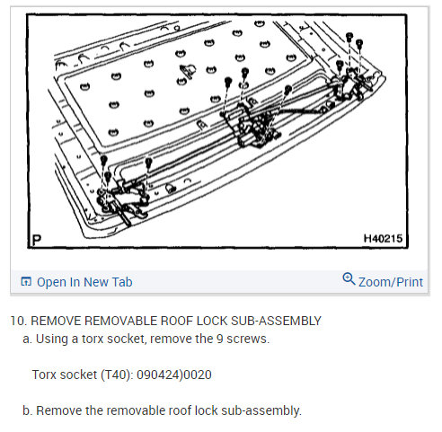

Hello, I'm Danny.

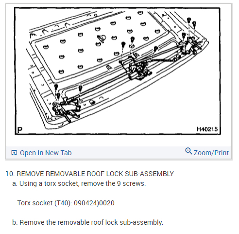

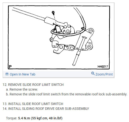

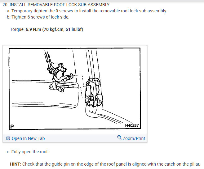

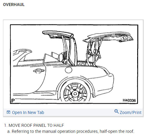

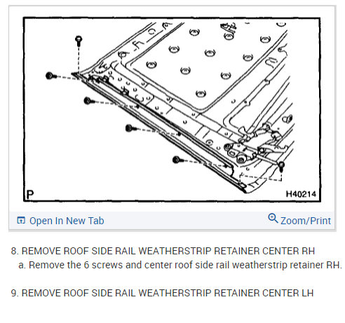

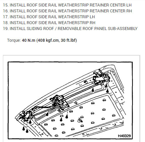

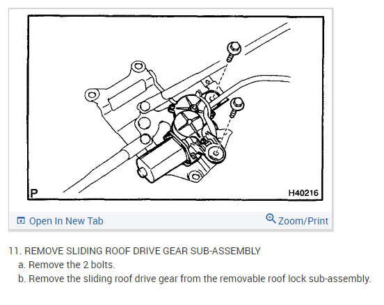

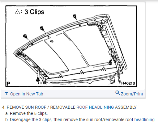

Unfortunately, We cannot provide referrals for auto repair shops. what we can do is provide you with guides to help you repair your car yourself. I've attached picture steps below on how to take apart your convertible top to remove and replace the drive gear assembly on your Lexus. Hope this helps and thanks for using 2CarPros.
