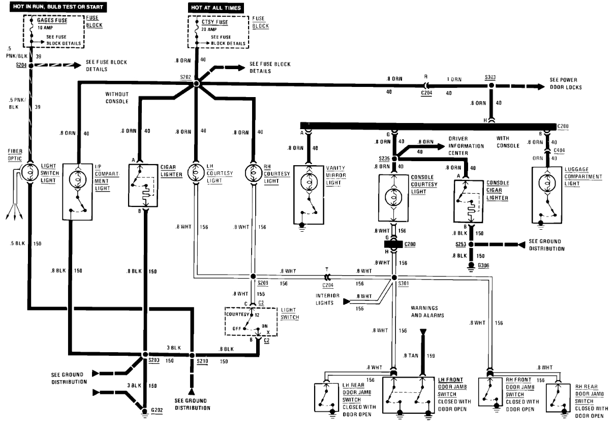

Recently purchased the car listed above. The car is great, and I have no complaints aside from the courtesy lights don't come on unless the key is in the ignition and is set to the on position. I have checked the button in my door and I am going to look at the fuses in the morning, was curious if anyone else had any ideas?

Okay, I would check the CTSY fuse in the fuse panel inside the car. Here is a guide to help you and I have included the courtesy lights wiring diagrams so you can see how the system works.
Check out the images (below). Let us know what you find.

This worked great! My courtesy lights work now, but now the pioneer radio i have doesn't turn off when the car is powered off.
