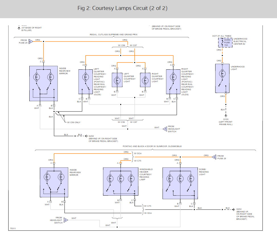

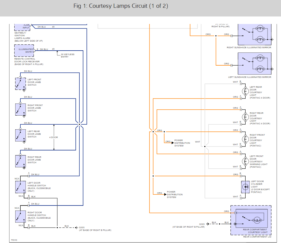

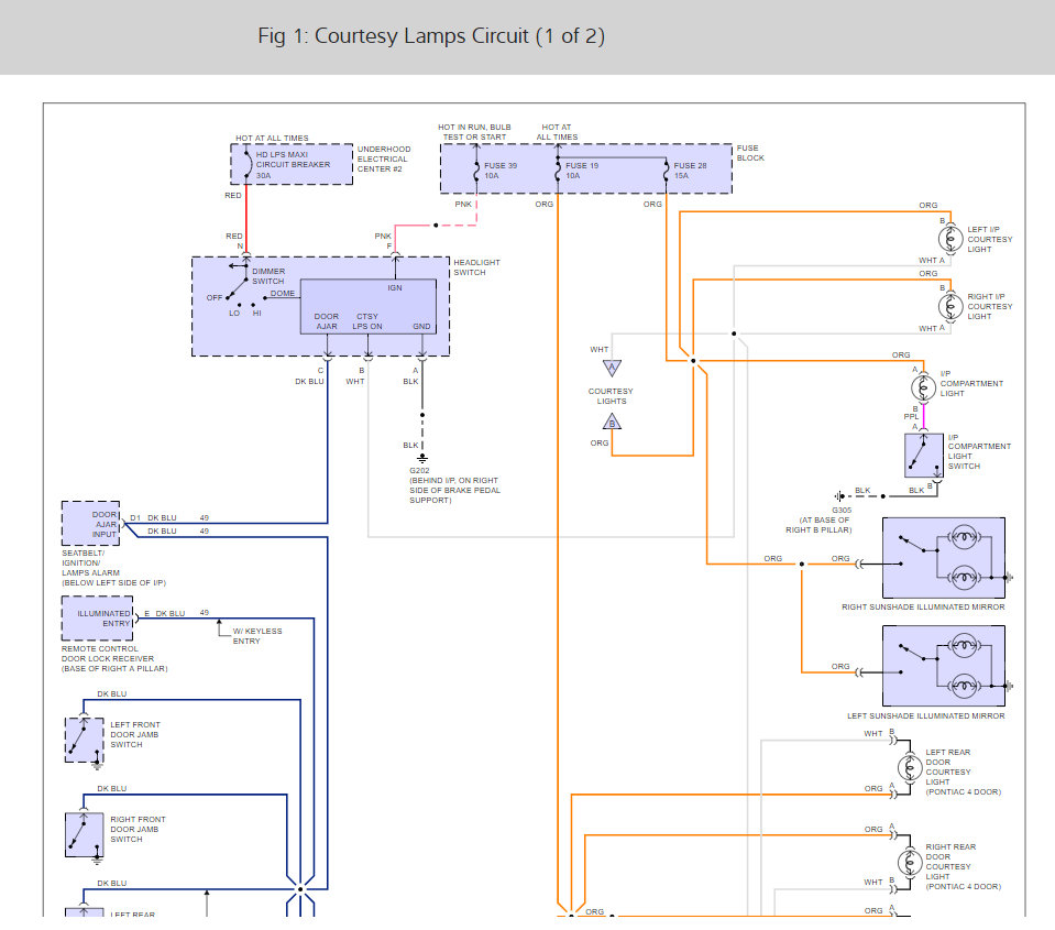

Courtesy lights do not come on until starting car but do not go off until stopped shut off and ten minutes. Also, noticed door seems to try and lock or unlock while driving.
Feb 24, 2018 at 7:34 AM
  • 55,065 POSTS

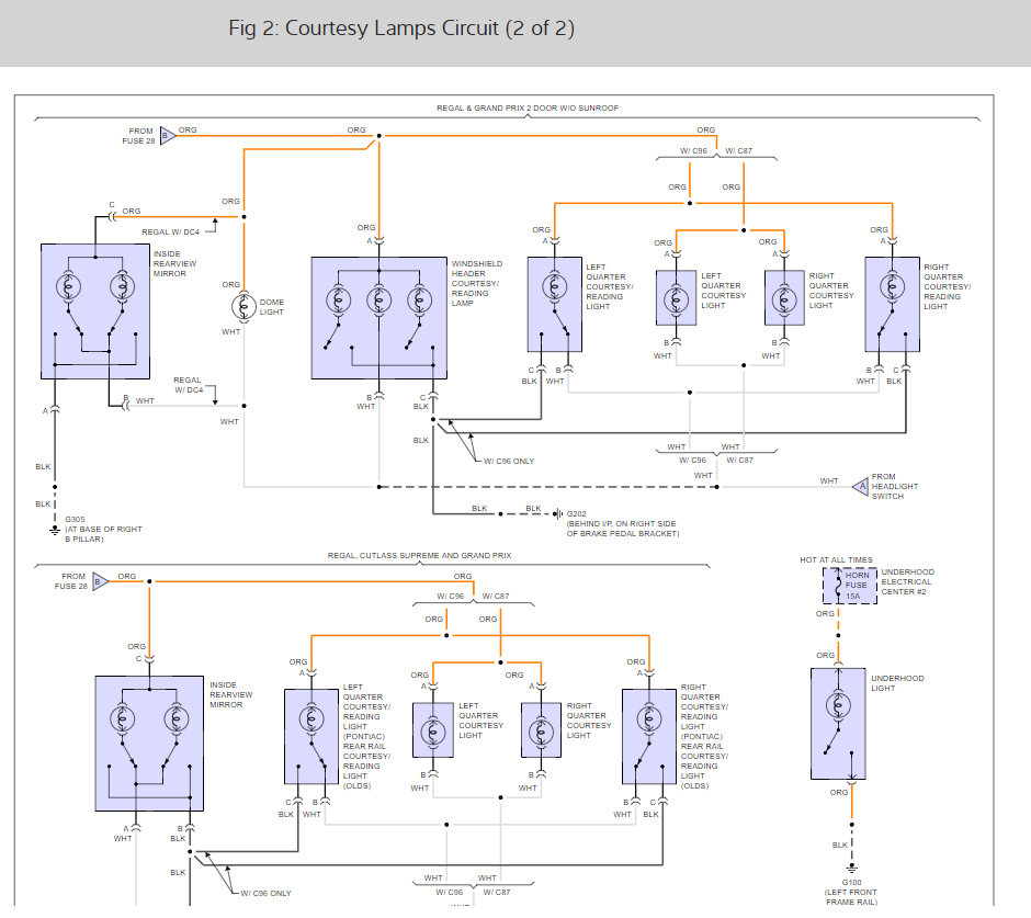

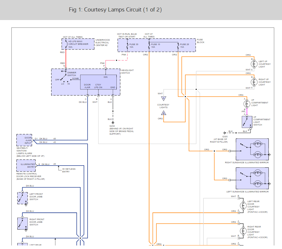

This sounds like a bad door light switch which I would test using this guide and the interior light wiring diagrams below. Test for ground.
