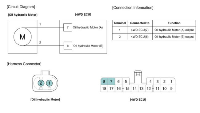

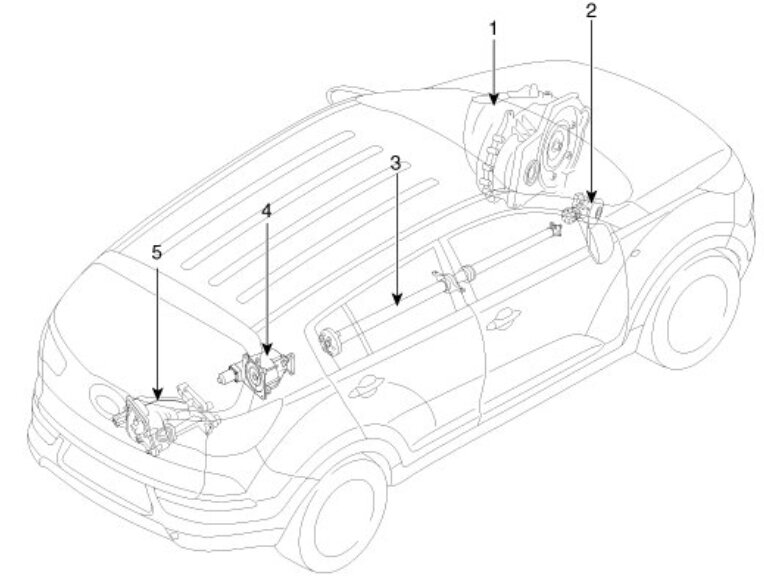

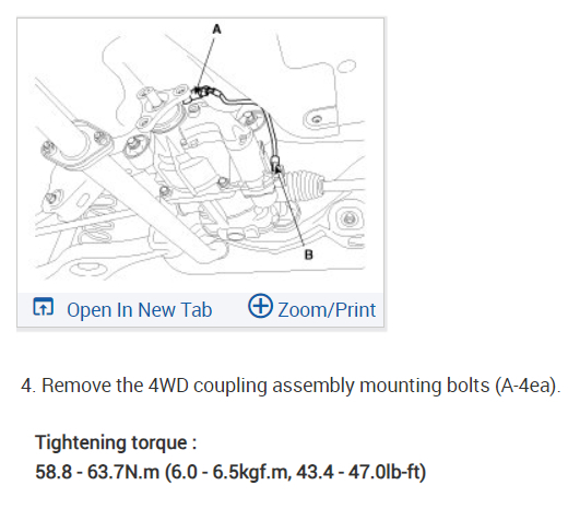

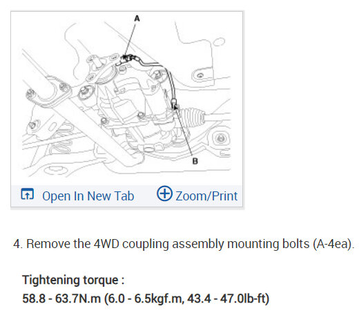

AWD not working drive shaft turns but AWD will not kick in viscous coupler does not make any noise. wondering if the motor might be the cause of failure.
Jan 30, 2024 at 2:06 AM
  • 55,423 POSTS

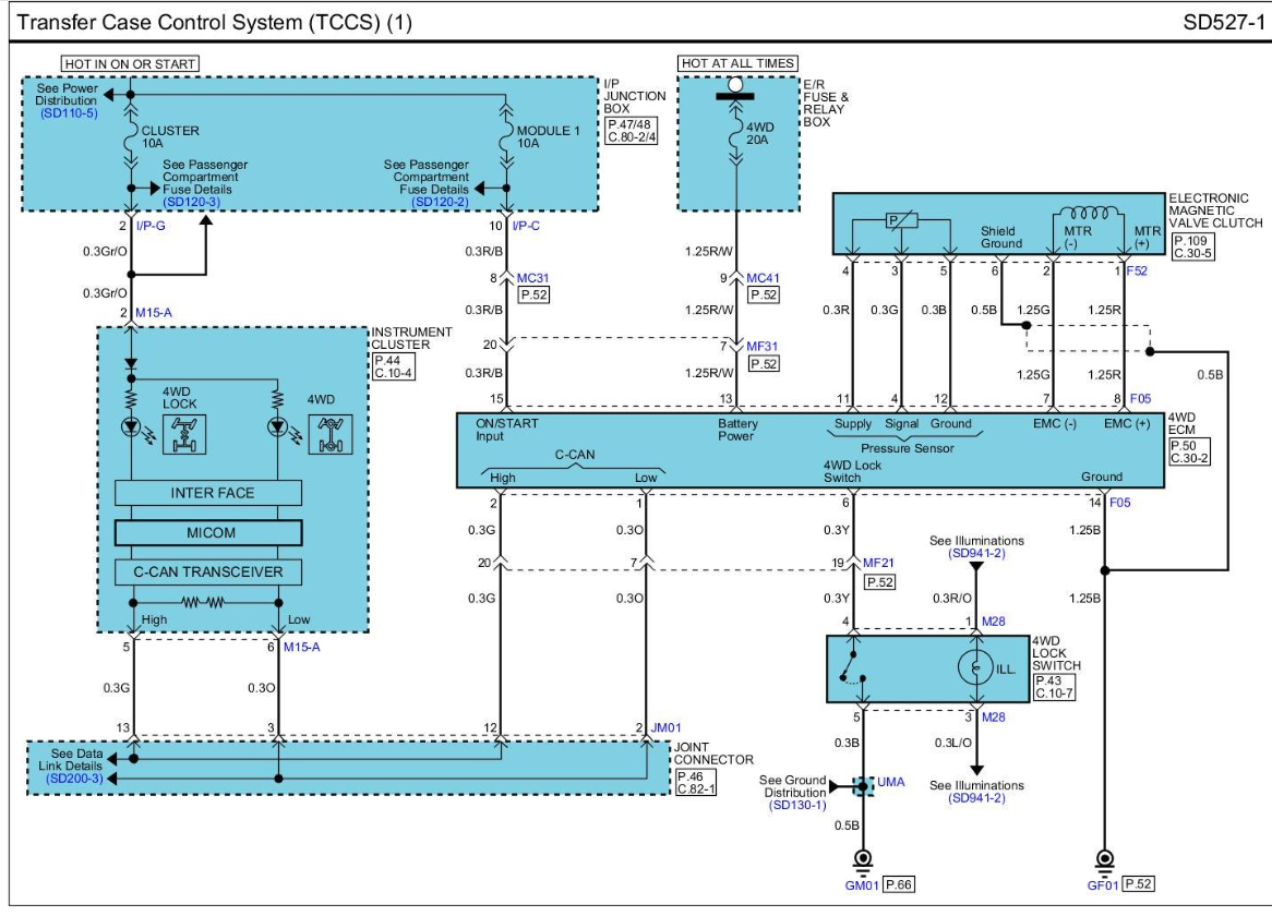

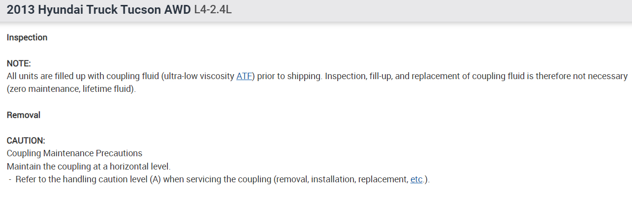

There are 3 fuses that run the system I would check first: CLUSTER A and MODULE 1 in the fuse panel inside the car, and 4WD fuse in the ER fuse panel.
This guide can help you check the fuses:
Also, I would run the codes to see if any are stored.

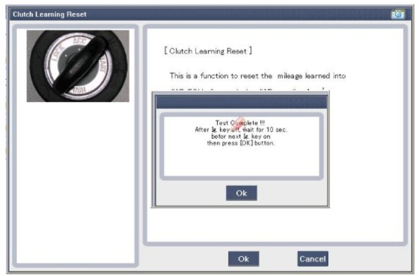

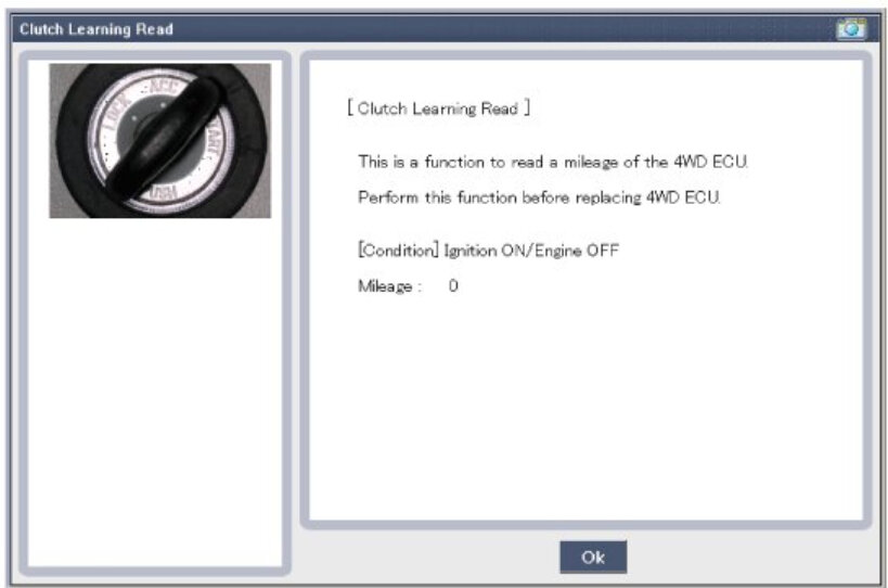

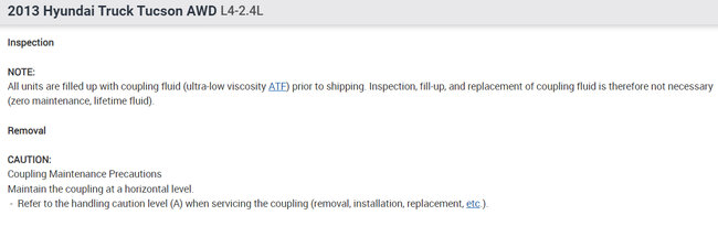

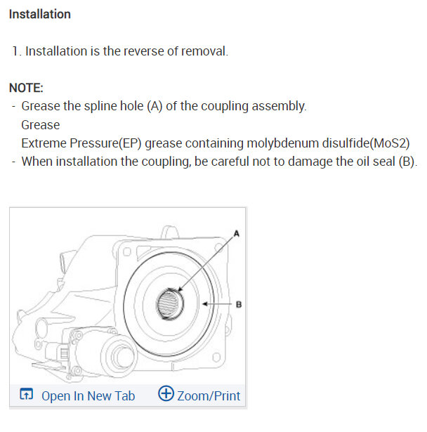

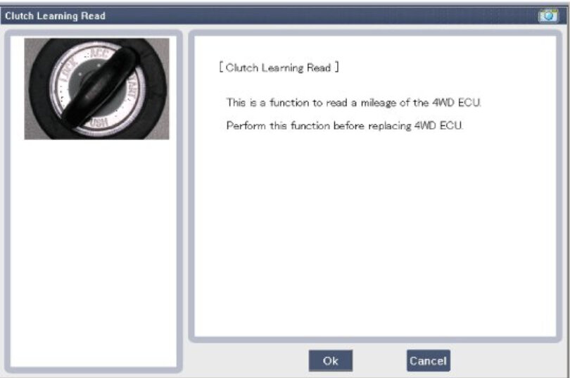

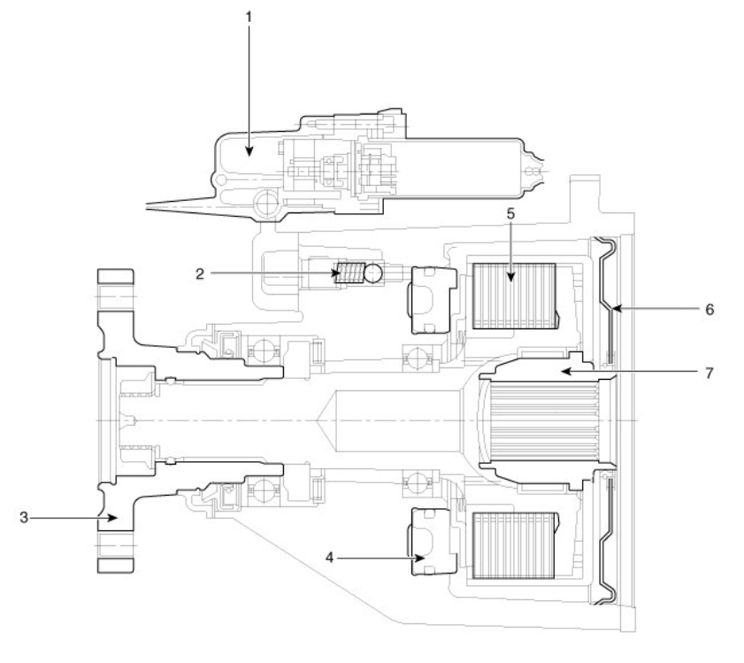

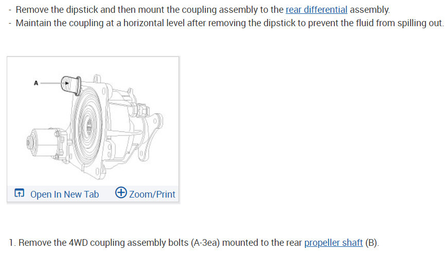

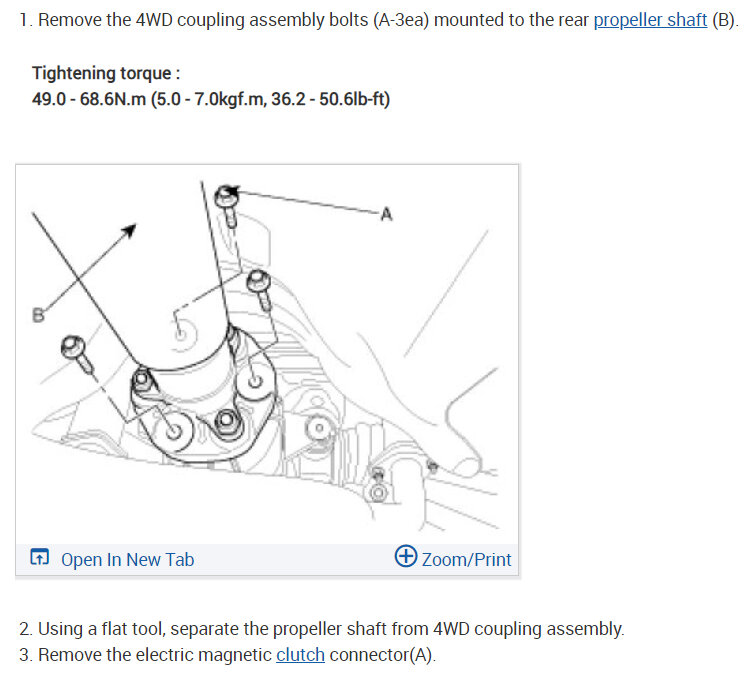

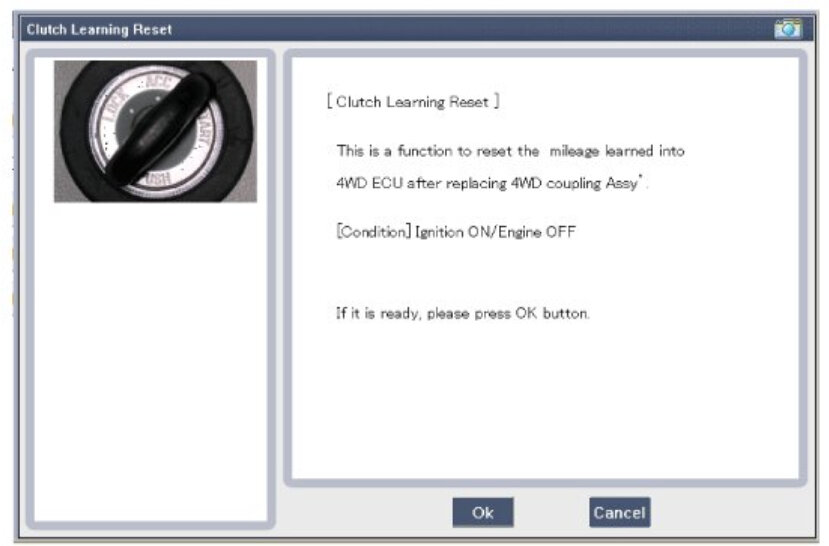

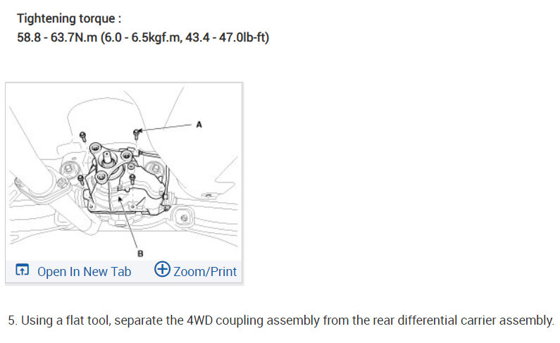

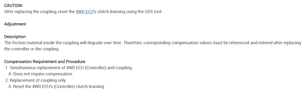

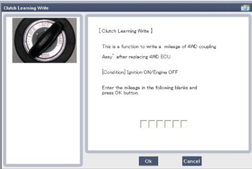

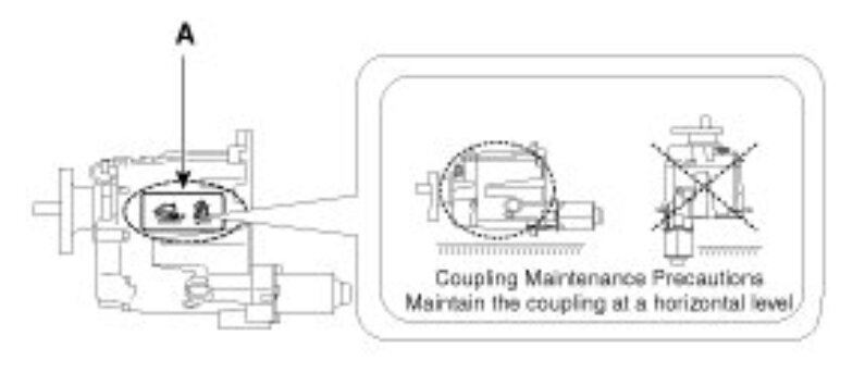

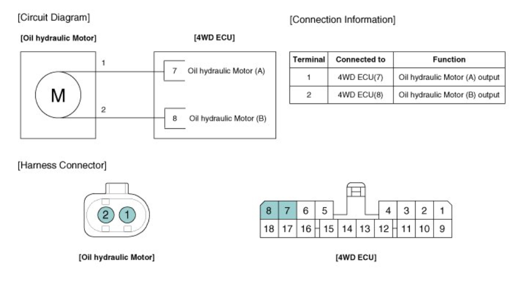

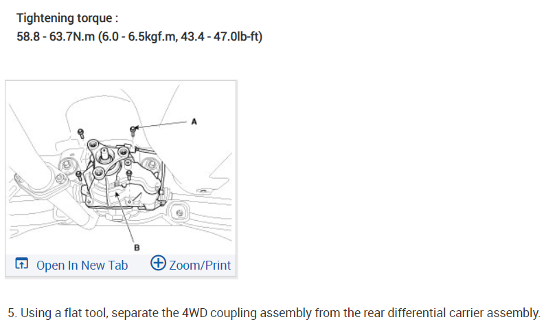

If there are no codes and the fuses are okay here is how to change the clutch control motor for the coupler and how to reset the operation of the motor as well. Also, I have included the wiring diagrams for the system so you can see how it works. Check out the images (below). Please upload pictures or videos in your response of the problem so we can see what's going on.

Should there be 12 v to the 3-pin connector at rear differential? I only have 5 v.
Jan 30, 2024 at 9:40 AM
  • 55,423 POSTS
Do you mean to the electronic magnet valve clutch? If so, it looks like it can be a 5-volt sensor system much like the engine sensors. I would do a CAN scan to see what codes the system has. You can get a CAN scanner (Controller Area Network) which will work on most cars from Amazon.
